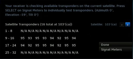

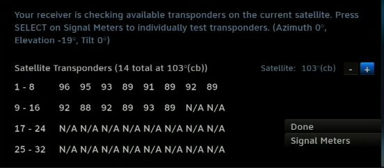

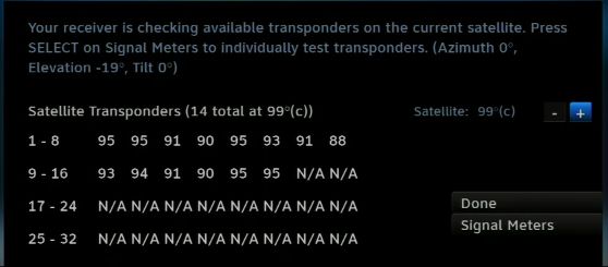

Maybe you have marginal signal, just good enough for the other receiver. What are your signals on 99c, 103ca and 103cb (look at all the transponders), they should all be high 80s to mid 90s....
These are the number on the seccond (bad) TV.
