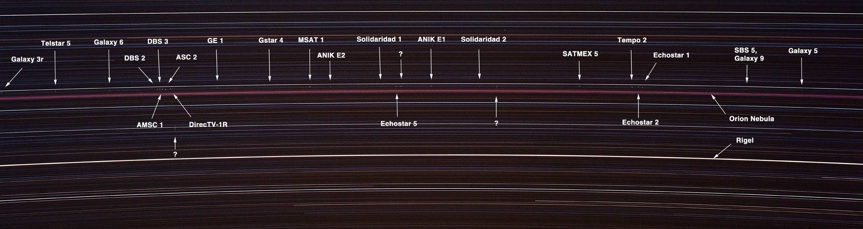

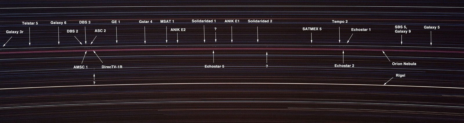

..Now if you went at this with a digital camera hooked up to the telescope, assuming everything like before, if you let the telescope take a 30 minute time exposure while it follows the motion of the stars through the night sky when you looked at the picture all the stars would still be points of light but the satellite would be a nice short line across the frame....
It would seem that just the opposite would be true if you simply left the telescope in a stationary position. The stars would create the streaks/lines, and the satellite would remain as the constant in the picture due to its consistent location in the sky.
You mean like this? I'll confess. I didn't take the picture. It's something I've had for a while.
The only reason I went my way was to use stars in the frame to verify exactly where you were pointing. The star steak pictures force you to totally rely on the accuracy of your aim.
I'm biased toward amateur astronomer's methods who work with star charts and navigate by hoping from known stars to known stars. Then the odd stuff you spot just requires an accurate time to fix it in space.
