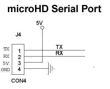

Is this a standard cable I can buy easy somewhere if not, will the manual have a schematic showing which pins are tx,rx and gnd so I can make my own. I hope I never have to use it, but I like to be prepared just in case. :)
Here is the diagram for the 4 pin header on the PCB. microHD_Serial_Diagram.jpg
Thanks Brian.
