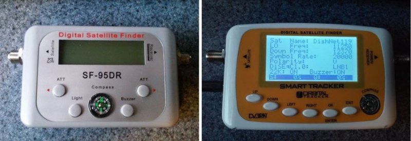

Below are the two meters I own, but the one on the right is the only one I use. For a $50 meter, it does a decent job for my needs. The $10 meter on the left was included with a used dish I bought years ago, but other than hooking it up once to see if it worked at all, I haven't used it.

Well, I know I could do the job better and likely faster with a better, but much more expensive meter. On the other hand, for my usage, my meter gets the job done, and it's rare that I don't hit all three sats on either arc the first try as long as I have a good LOS. Shooting through small openings in trees can take a little fussing at times. My meter only locks on the western arc sats though, so the eastern arc can take a little more tweaking to peak it in.

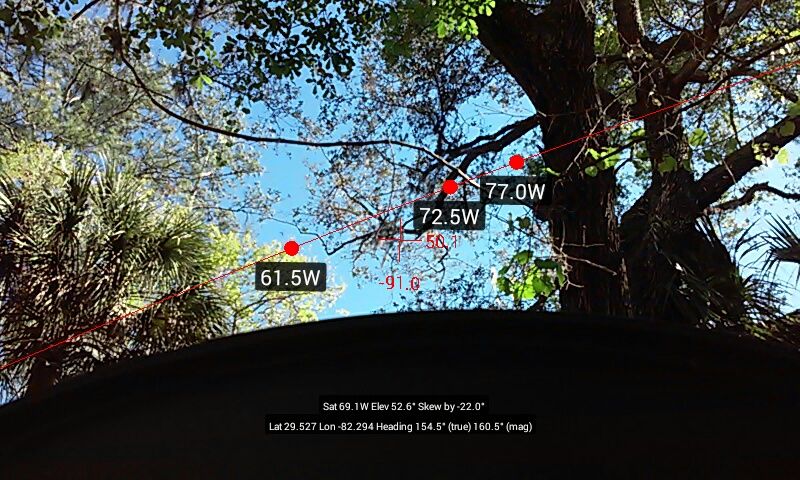

The photo below shows what I had to work with in one Florida location. Surprisingly, even 72.7 was usable, although the signal level was marginal.
IMHO your meter qualifies as a usable meter because you can identify the satellite you're pointing at. It isn't the $8 joke variety and is obviously fine for your uses. :)
Did it come pre-programmed or did you have to enter the sat specs? Also do you have to update it with any changes?

It came with the North American DBS and FTA sats pre-programmed, but I deleted a bunch of them that I didn't need to make the settings I wanted quicker to access. The sat listings are fully editable, but I haven't had to do it so far. I see what appears to be the same meter on eBay now, for $60-$70, but I don't know what sats they're set up for.
