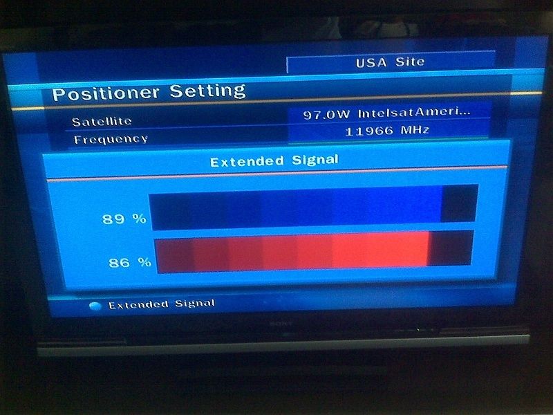

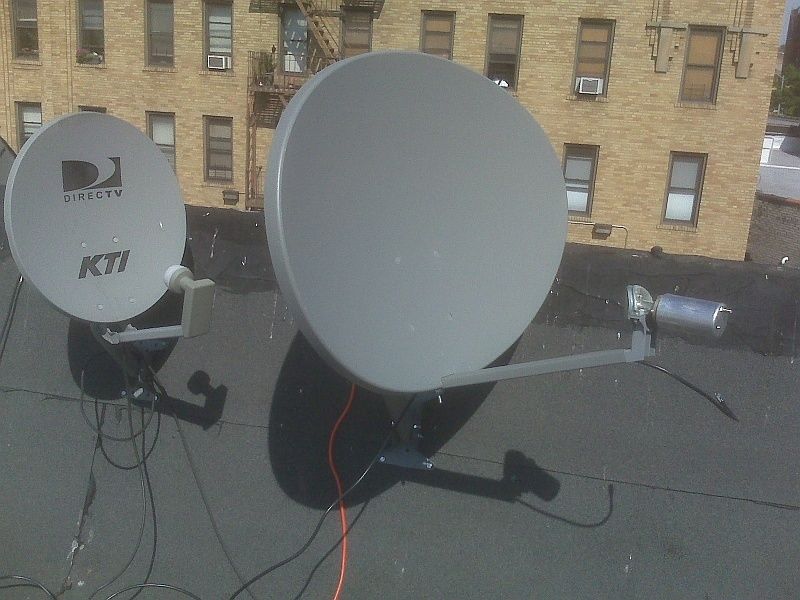

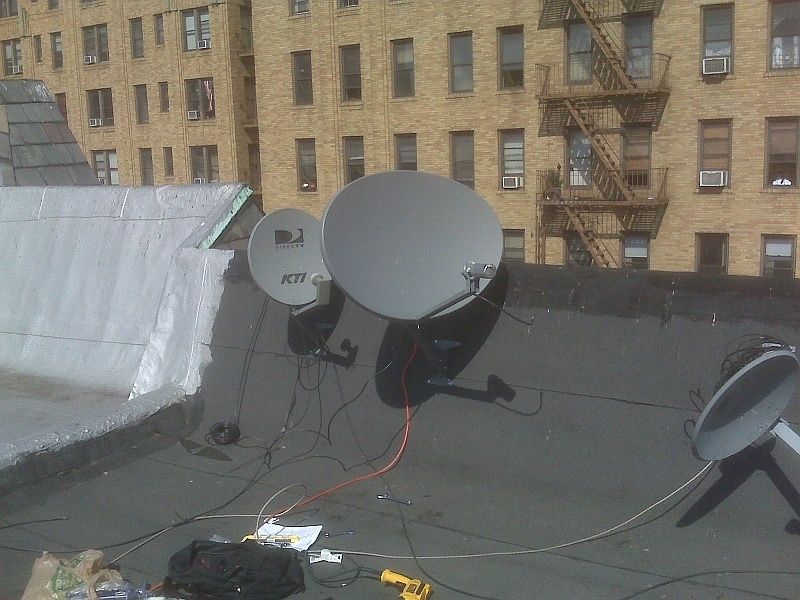

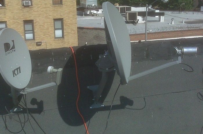

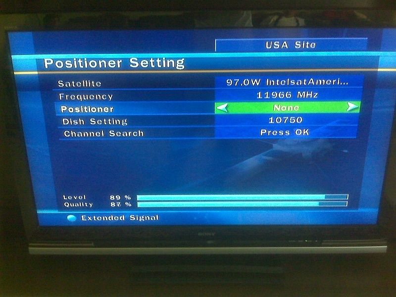

I was up in the roof today, moving the dish in millimetric increments... Was on the phone with my wife and by the time visionsat refreshed the quality meter I had already moved it, during that time it had spiked to 60 and back down.. Anyway, after about 45 minutes fiddling and finally giving up and getting my sat finder, I was finally able to lock to G19.

http://img188.imageshack.us/img188/3528/dishview2.jpg
http://img193.imageshack.us/img193/9374/dishview.jpg
http://img37.imageshack.us/img37/1838/signalstrengthoverall.jpg
http://img46.imageshack.us/img46/4711/signalstrength.jpg

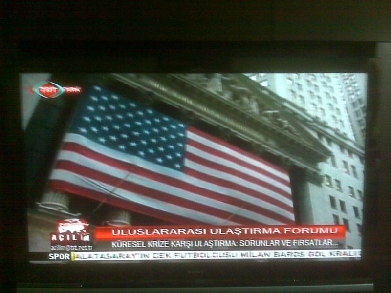

http://img194.imageshack.us/img194/3668/trtturkmay2009.jpg
