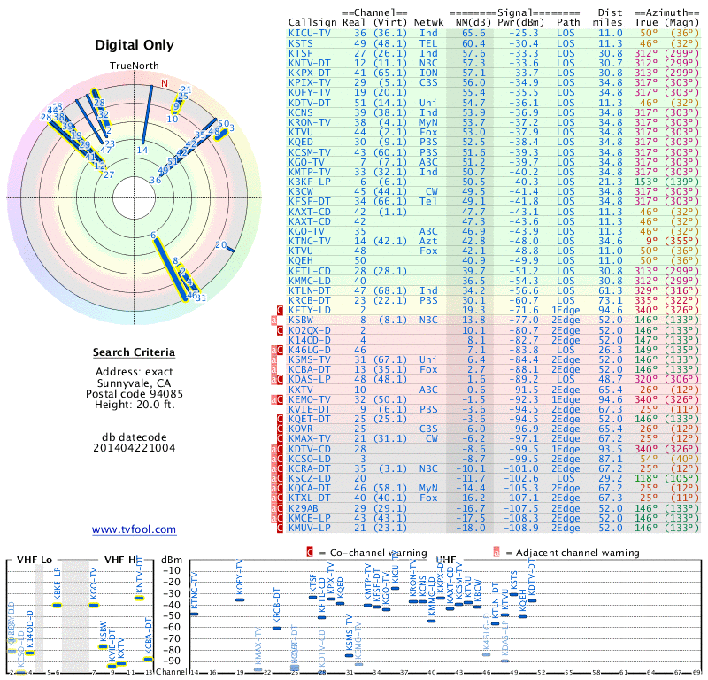

What TV or receiver are you using? And would you mind posting a TVFool reception report for your address?

All true. But, something is just not right. According to both Antennaweb and TVFool, I should be receiving these channels fairly easily. And, IIRC, I had all the channels when I was testing the Hopper OTA module. And, that was with additional length of temporary coax from the guestroom. So, I will definitely recheck wiring, preamp functionality, and even position, this weekend, to ensure everything is working correctly on my end.

You have good signal (green) so a high gain preamp isn't necessary. And will actually degrade reception caused by what's called overload. Pre-amps can help if your signals are marginal.

Your signals, I don't think. would be considered weak.
