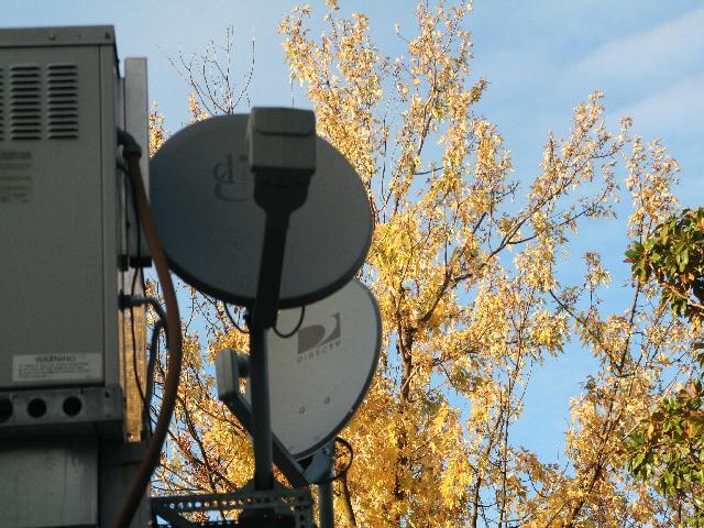

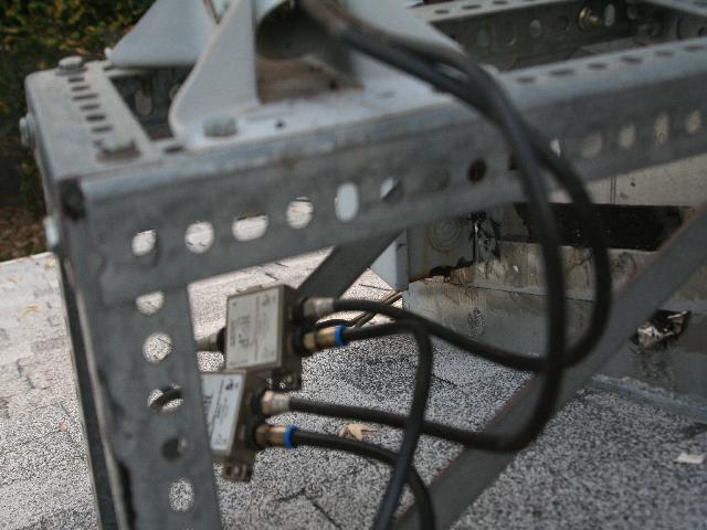

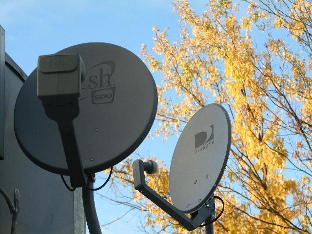

In defence. Just suppose that the installer was right and that the work order was wrong as he claimed(I believe there is a thread to that effect posted). In that case he might not have had right equipment on his truck If the retailer is cheep and only will send the tech with only what he needs for that day. The tech is now faced with a dilemma, He can call and reschedule the job, which will result in lowering his completion rate or complete the job hoping that the customer wont care as long as he is getting the programing that he ordered. Your roof is easy to work on so again you get the junk because any tech back out there will have an easy time if any changes need to be done. The legacy set up will work and except for some other problems would work very reliable for many years. There was one other thing that was in his favor he bolted the mast to the frame instead of to the roof.
Unfortunately the dangling sw21's will pull the connectors out very soon, and there appears to be no sealer on the bolt in the roof. It appears that the top 2 bolts are on the seam at the peak and aren't real secure, looks like a potential leak. I will bet that if you follow the lines there is no grnd. I have seen this type of install too many times.
And if what I conjectured above is true the tech is not to happy with his Co. because he was put in the situation where he looses no matter what he does, so he gets it done and leaves as fast as he can.
No I saw inside his van He had (guessing) about 20-30 dishes. There is a ground I just cant show you lol, no its inside my atic becuase of us redoing the siding last summer, all cables are inside
I learned a long time ago, as the cable companies have, to place all switches such as the SW21 and grounding blocks in weather proof boxes like the Telecrafter Omni III.

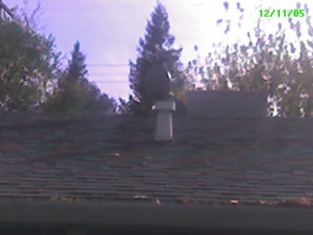

UPDATE: 12:15pm dish installer shows up. Not getting a dish1000 (damn im really starting to hate customer service, Forgot to put it on the work order AGAIN), He will be upgrading me to a DPP twin LNB (thats GOOOD). Will continue update.

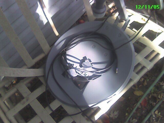

ok he's done, the d* dish is im my backyard in a nice and neat pile. Everything looks good to me (ok I havent been up there yet). Workin on the pics. Didnt charge the camera srry.

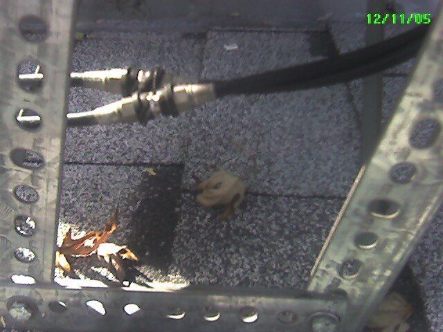

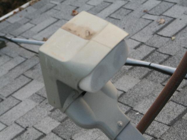

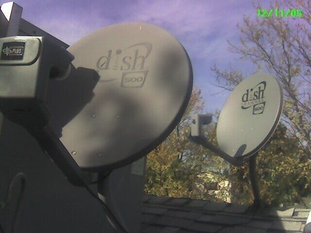

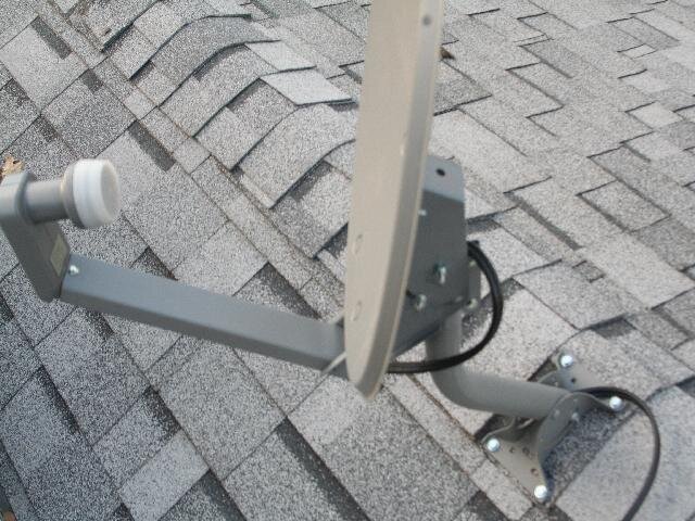

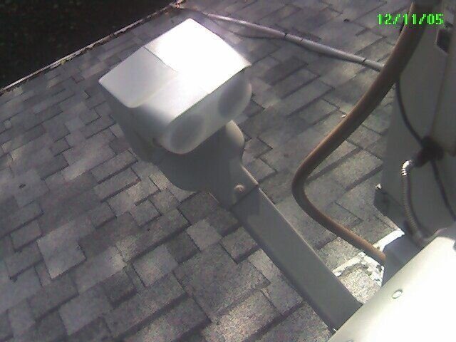

HERE they are the new pics, srry couldnt wait so i grabbed my cell phone (not as good pics, still a great cell phone (look at pic))

Looks pretty good :) The fittings on the cable aren't quite what I'm used to seeing (barrel connectors, still compression fittings but barrel shaped), but it all looks pretty good :)
Sweet phone too! Looks like you got a 650 there? Good for you man, those are the last good treo you'll probably ever see lol [MSTreo is so... ugh]..
So ya got 2 dishes! Oh well, at least on the good side, you've got 129 (or can repoint to 129 real easy if you have 148), and they're easy to repoint :D
