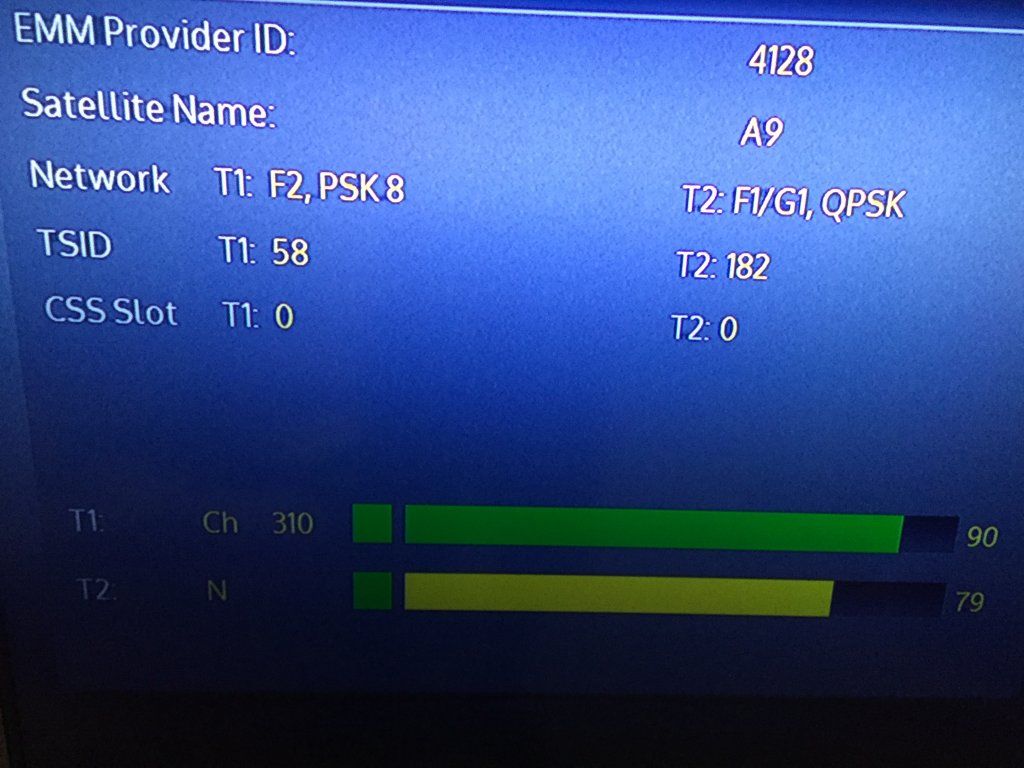

Had a tech (who claimed he could handle any Ku band). The moment he replaced the LNBFs, I got my HD channel (310 - TSN 1 HD) working. The signal strength on System status showed approx 60 and EcBNo was very low 3.1. The tech also said that the support arm for the mast had moved, so he re-fastened the mast. I explained that with a 85 cm dish, I am supposed to get 80-90% signal strength with EcbNo at least above 7.0. He made a lot of minor adjustments and I saw the signal strength jump to 90% and EcbNo 6.7. However, there was no picture on 310 (or any other HD channel).

I am enclosing the screen shot from system status. Please let me know if there's any other section or hidden keys that will help shed light on which Sats my dishes are locked into.
