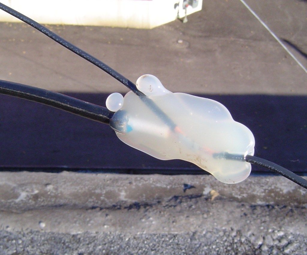

Well as an outgrowth and by-product of acquiring a Short-Wave radio to use with my BLSA, I got the bright idea to do some exploring on the radio just for listening.

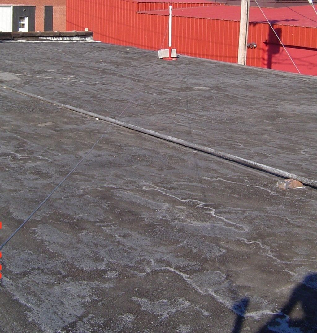

I couldn't get anything with my little rinky-dink circle antenna here inside the building, so I read up on making my own "long wire" antenna.
Bought 50 feet of 14 guage insulated stranded copper wire, and read up about using coax to bringing the signal into the house. So I made up the wire and coax, and had my son help me take two "stands" that I already had and modified them with some PVC pipe and put on insulators to string the wire.
End result, I am right now listening to the sweet Christian sounds of WRNO Short-Wave at 7.505 Mhz. I don't know where they are transmitting from, but it is coming in with a great signal and good sound on my Kenwood R-600. :) Just heard they are broadcasting from New Orleans.
Stopped by Radio Shack today and picked up the parts (they actually had them there :eek:) and pieces to build my very first electronics project, a static zapper. :D
I have read where they are a must especially using a DX-440 which should be here in another day or two.

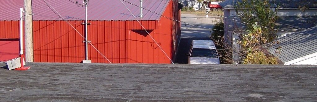

I need to put a center support on the wire. It is drooping pretty bad, and there is a good bit of strain on the PVC pipes screwed onto the pipe stands.
Here are the pics of the home-brew antenna I made. :)

Built a center support for the long wire and got it in place this morning. It took a lot of strain off the PVC end posts.

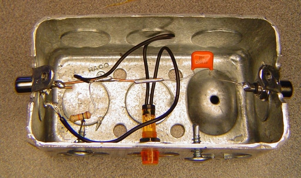

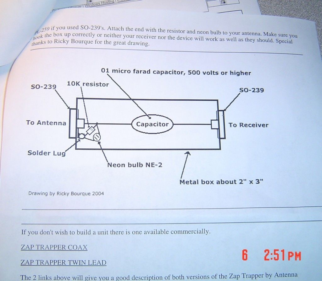

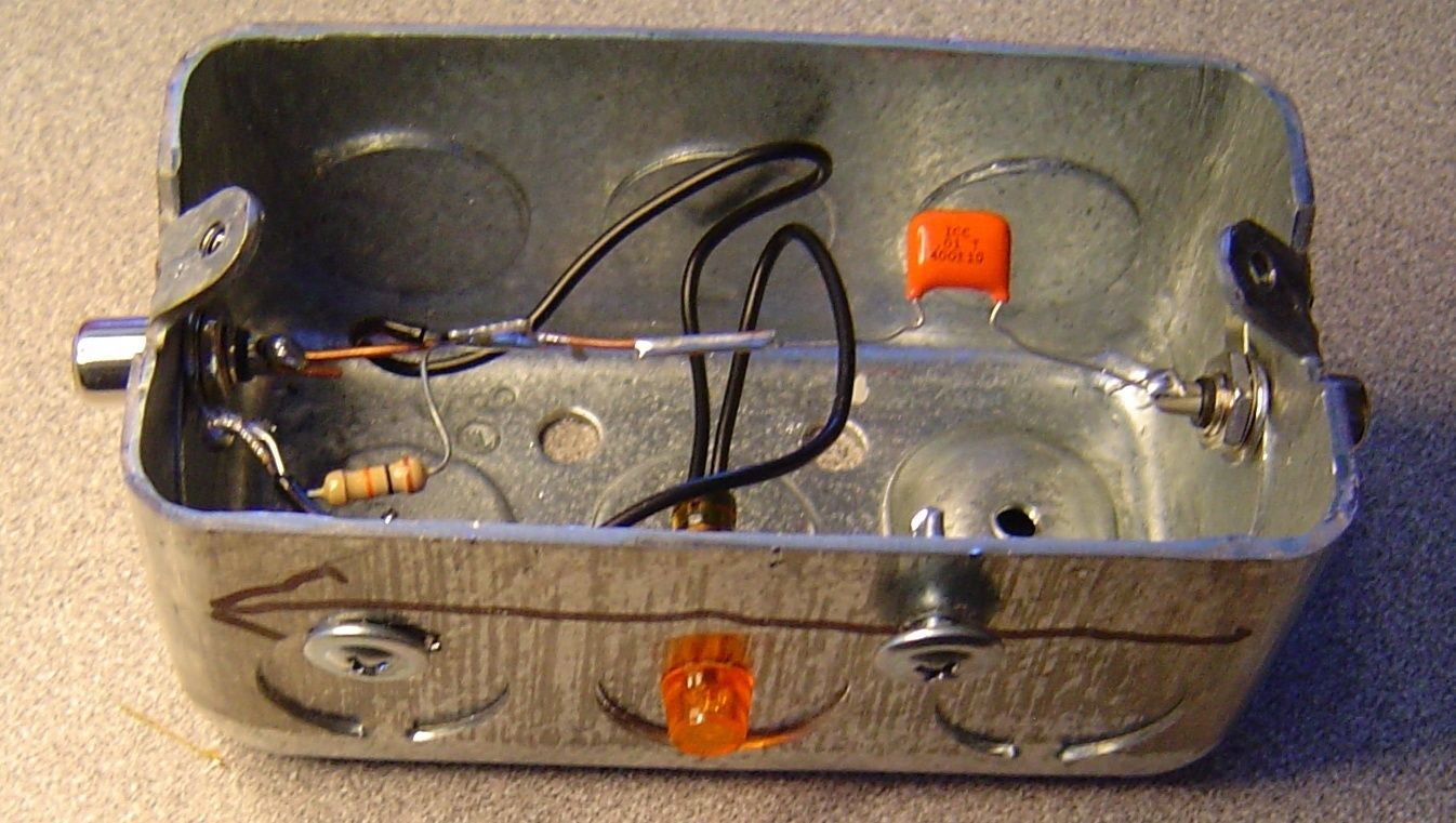

Started making my "Static Zapper". It wasn't as hard as I thought it might be. This is my first start from scratch and build something useful electronics project. I used a 400v capacitor because that was what the Rat Shack had. I also used a different neon bulb 120V AC or DC same reason.
That differs from the design plan a little. I am sure someone here will tell me if I need exactly what the plan calls for. :rolleyes:

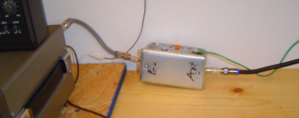

It is hooked up, and I think the radio is actually working better than yesterday. Don't know if that is possible, but what the heck! :D
Got my DX-440 in today, but haven't hooked it up yet. I wanted to compare apples to apples before and after with the zapper.
Before Anole asks, here are the pics. I need a lot of practice if I am going to get better at soldering.
Your soldering looks fine, certainly more than "good enough".

I must have gotten very lucky making my "Long Wire", or have it pointed just right or something because I am getting a lot of stations from everywhere. I have the wire pointed about NE to SW and it is 4 feet off the roof deck which is metal under the asphalt with my satellite dishes all around it. :) That puts the wire about 18 - 20 feet off the ground.
