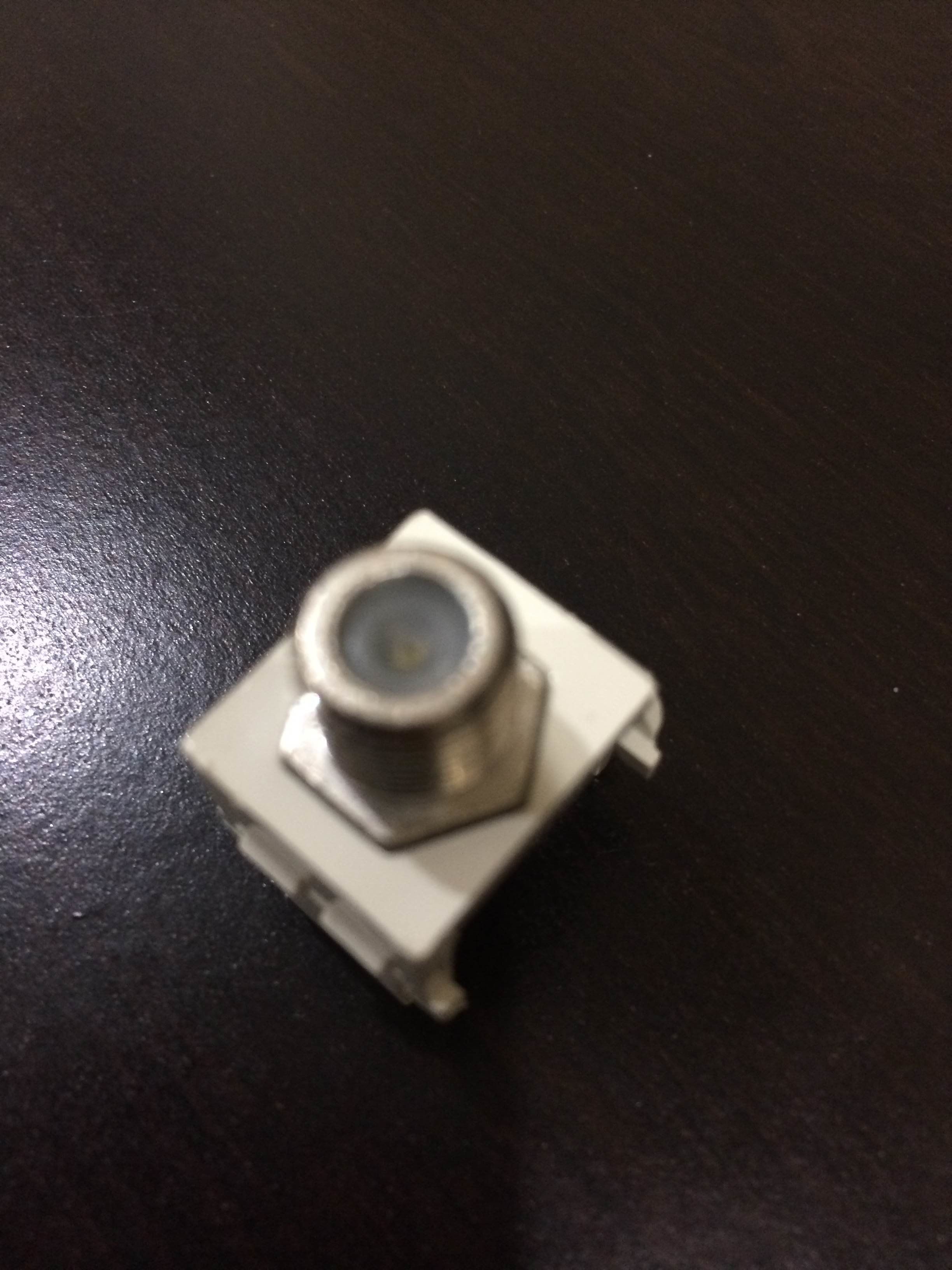

take a look at this photo, its supposedly a 3GHz connector plate for my wall jack from leviton. according to the leviton website datasheet, it says 3GHz, and it looks blue and white. However this part which i just picked up from grainger, only looks slightly blue, and is actually an ivory/almond color. the part # matches up with what it claims to be, so should i now be concerned i dont actually have what is said to be a 3GHz connector? does the inside HAVE to be blue?
Ok so I switched all the connectors to the blue 3ghz ones, and looked at signal strength before and after, and I have literally no difference. So now what should I do?
