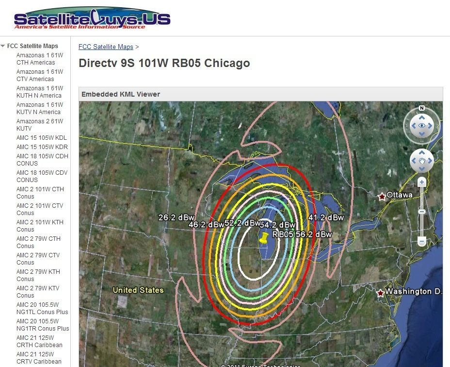

How much hotter (EIRP & db) are local spot beams on 101 vs Conus stuff?
I guess it depends on where in the spot beam you are. If you're right in the center of it the signal would be a little better than if you were say on the edge of it
Are there any maps? Conus goes down first in storms then the local spot. If I can get an idea on how many more db it may have I may know how much c/n in db over threshold overkill I need to cut down this rain fade. All conus was at 0 Q and the local spot was around 60 Q during the last wave that went through. Wish I had a spectrum analyzer that would show me the whole gambit.

Working on my Firefox; here is your capture
did you check the link I posted in #3?
I dont have google earth on my computer so I cant see the maps themselves
I went to my other pc with google earth and it kept crashing FF. This pc told me it can't install, can't find location in msvcrt DLL. more buggy software :(. Maybe someone that can see the map can do a screen capture and post it here.
Thanks can someone get a conus map for Chicago so I can compare and do some calculating.
