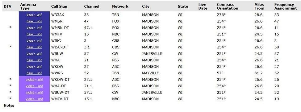

I have one channel that I have problems recieving with my current antenna setup. The channel I am having problems with is 27.1 on freq 26. Can anyone explain to me why a channel that is broadcast from the same location as the rest of my channels has a weeker signal strength? The signal strength readings from my 622 for the channels are listed below. Here is the antennaweb channel listing for your reference. My current setup is a Radio Shack Antenna Model: VU-190 XR with the Radio Shack preamp Model: 15-2507
Thanks
h2oski
WKOW analog on channel 27 is probably overloading your preamp and causing intermod into channel 26. You must disconnect the preamp from your antenna and remove the power inserter. If you feel that you need a preamp, the Winegard HDP-269 is designed to resist overload.
