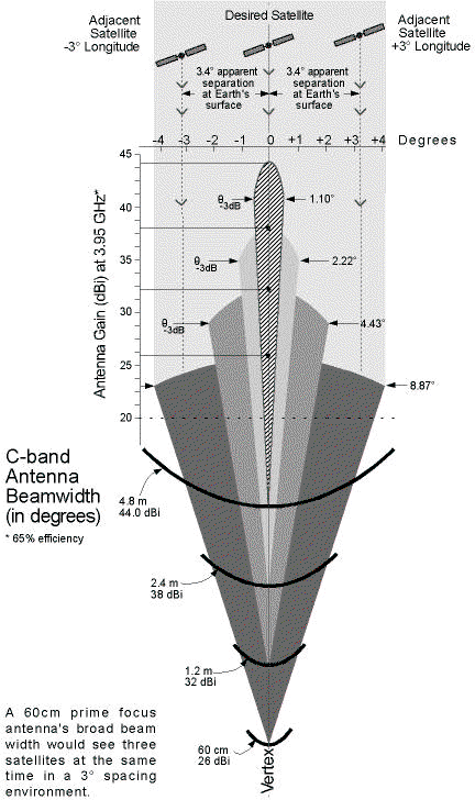

I'm wondering if a newer STRONG signal from Anik F3 @ 118.8W is wiping out/interfering with the EURONEWS signal on the 6 footer because it is too small to properly reject it.
An 8.5 footer (2.6m) is able to reject 123W and 118.8W Properly.
Attached an oldie but a goodie to show you what I mean.
I'm surprised you are having such a problem with the EURONEWS TP.
The 8.5 should pick it all up.
I know i could pick up Everything on "The List" including AmericaOne on the 8.5 foot dish.

nice chart. i know my 10' dish has a 1.7 degree beamwidth on c band. It has .5 degree beamwidth on ku. my 7.5' has a 2.1 degree beamwidth on c band i think.
