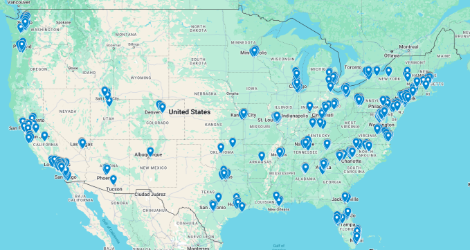

SiriusXM has repeaters only in some of the larger metropolitan areas. There are entire regions that aren't covered. Here's an older map (2010?):
SiriusXM has reportedly shut down more than a few (if not all) of these repeaters since 2010.
They obviously can't be serving Bozeman or Peoria from a repeater. More than a few of the repeaters were located in tunnels and existed only to serve the interior of those tunnels.

Thank you. The explanation that the entire SSL-1300 platform power of ~10KW is powering only a single transponder answers my question.
By the way, the Ku-band repeaters are only on the Sirius side of SiriusXM. The XM side's repeaters takes the strongest signals from the main S-band satellites and rebroadcasts them on the terrestrial band.
The XM side of SiriusXM is better in just about every way. The one thing that made the Sirius side better was the use of satellites in high-altitude polar orbits which made the need for repeaters on Sirius way much less than what was required for consistent reception on the XM side.
Now, of course, those Sirius polar satellites have been shut down for years, crippling the Sirius side since it has so many fewer repeaters than the XM side and SiriusXM is chomping at the bit to shut down the Sirius side.
