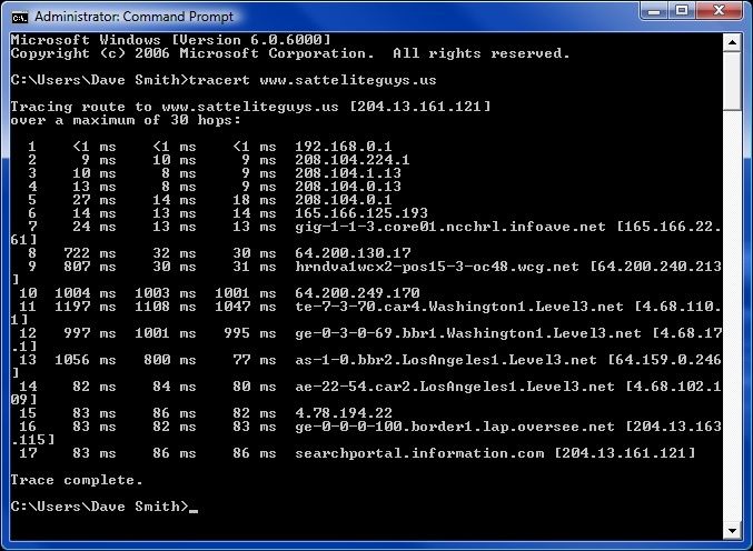

Thats strange, still really bad for me today. Takes upwards of 20-30 seconds delay on any click to navigate around or for posts to open. I'm currently running in the 4-4.5MB range on connection speed, and other sites are working fine...only having problems here for some reasons.
Edit: there appears to be a bit of a bottleneck between here and there. I attached the results of a tracert, if they are of any help.
There are two problems I see,
One with your ISP's handoff to the real internet.
Second it appears you have some sort of spyware on your machines, because as you notice its taking you to searchportal.information.com at 204.213.161.121 satelliteguys is 65.99.220.89.
That part had me thinking spyware too, but so far all scanners show me clean. Guess I'll be digging a little deeper when I get more time. thanks anyways!

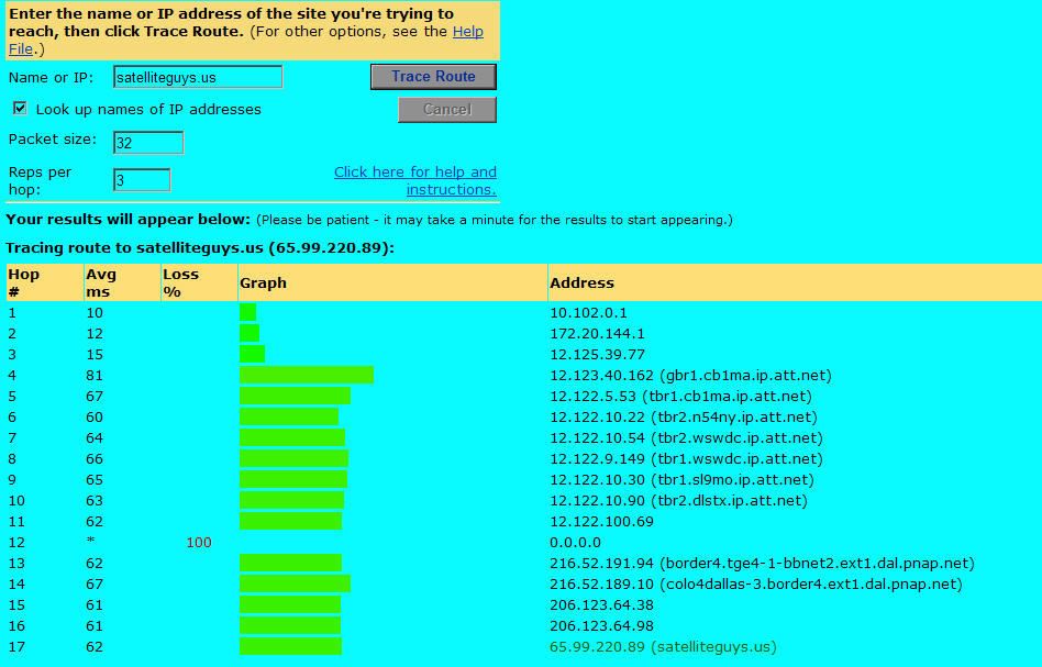

You should do a tracert like DWS44 did as the server is running really well. :)
Here it is but I really don't know what to look for or how to interpret it. I guess green is good but I see # 12 doesn't look so hot.
Anywho, you know me Scott, I don't really understand this sort of thing very well, I just know right now it's petty tedious moving around SatGuys. I just tried a few other sites and I zip right along.:)

%GraphAddress11710.102.0.129172.20.144.131812.125.39.77413212.123.40.162 (gbr1.cb1ma.ip.att.net)56312.122.5.53 (tbr1.cb1ma.ip.att.net)66012.122.10.22 (tbr2.n54ny.ip.att.net)76212.122.10.54 (tbr2.wswdc.ip.att.net)87012.122.9.149 (tbr1.wswdc.ip.att.net)96312.122.10.30 (tbr1.sl9mo.ip.att.net)106612.122.10.90 (tbr2.dlstx.ip.att.net)116412.122.100.6912*1000.0.0.01365216.52.191.94 (border4.tge4-1-bbnet2.ext1.dal.pnap.net)1469216.52.189.10 (colo4dallas-3.border4.ext1.dal.pnap.net)1561206.123.64.381670206.123.64.98176565.99.220.89 (satelliteguys.us)

you misspelled satelliteguys.us is your tracert. you used saTTeLiteguys.
Ok, hopefully this trace route will be more informative.
Like I said, SatGuys is the only site currently giving me this problem. It takes at least half a minute or more to change pages.
