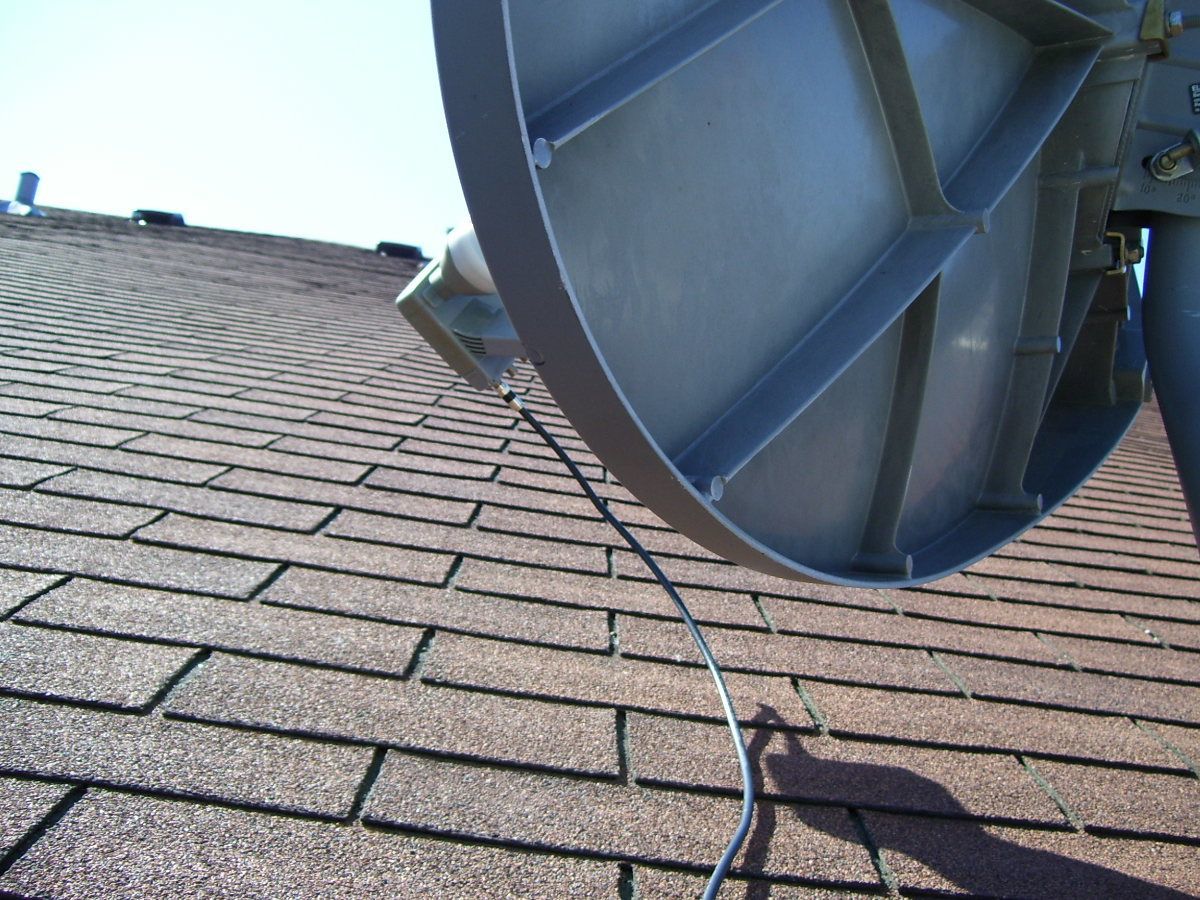

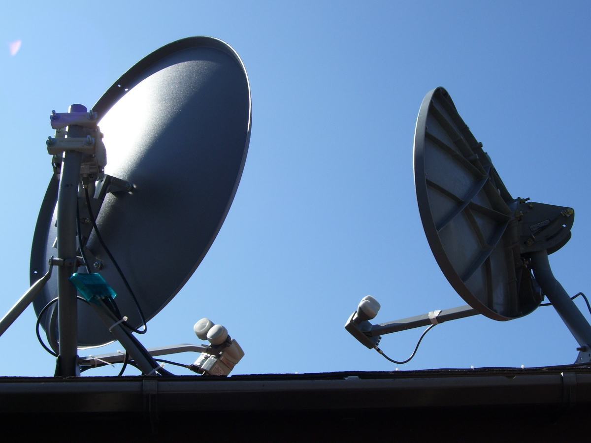

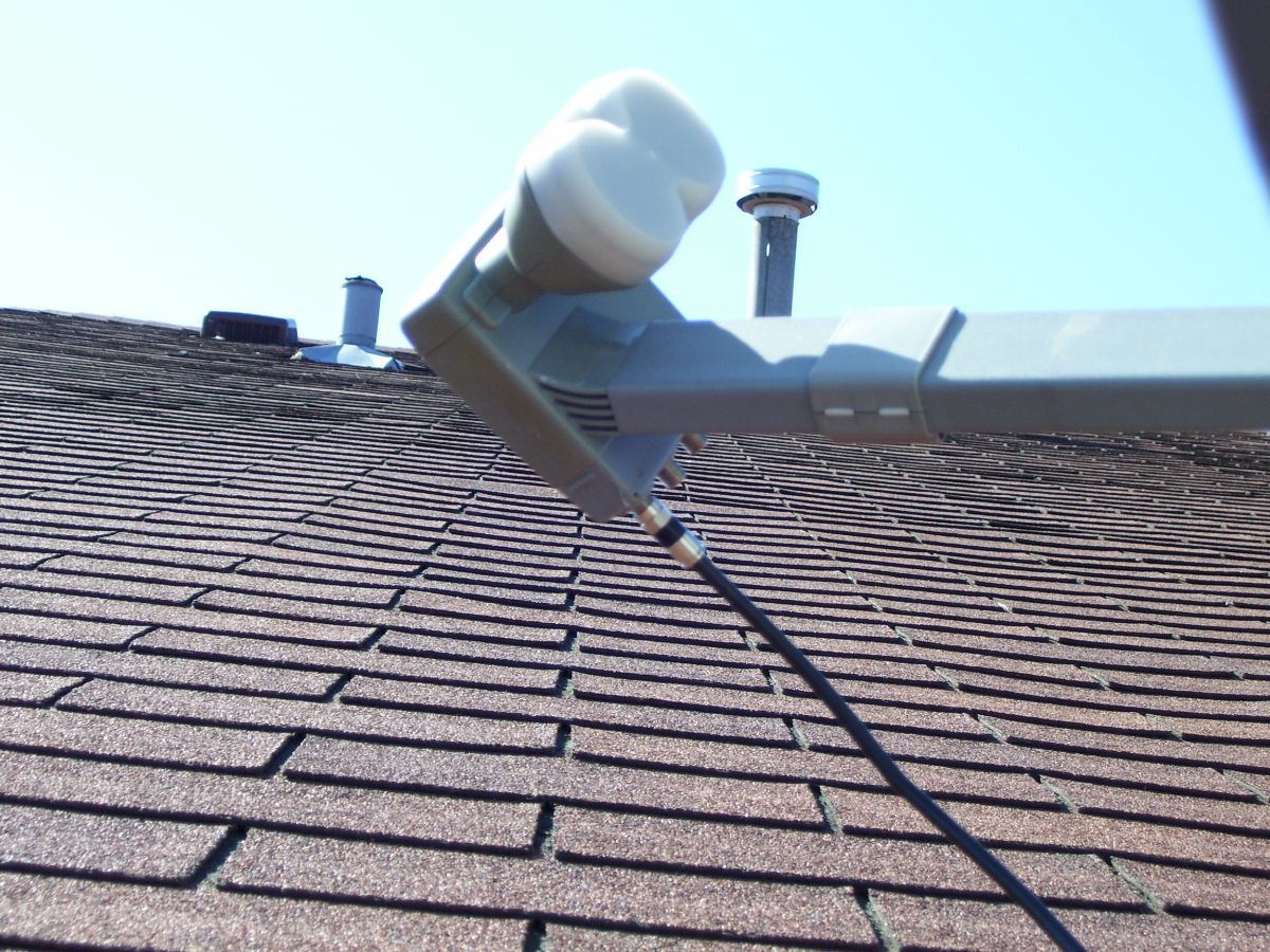

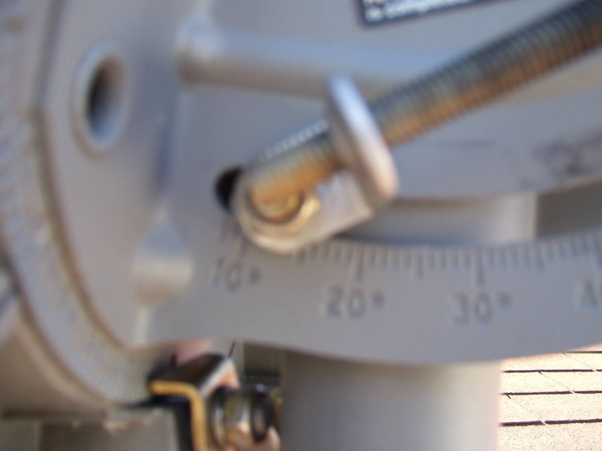

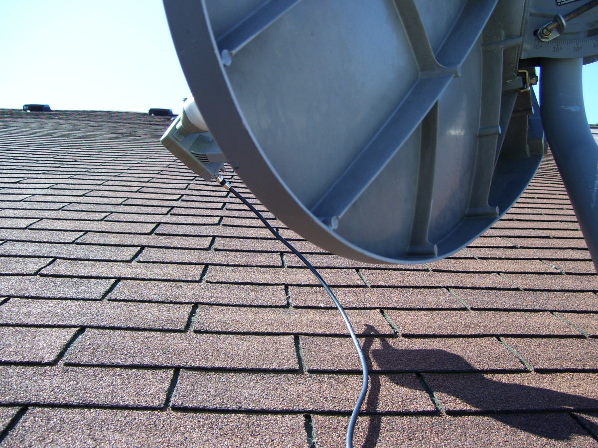

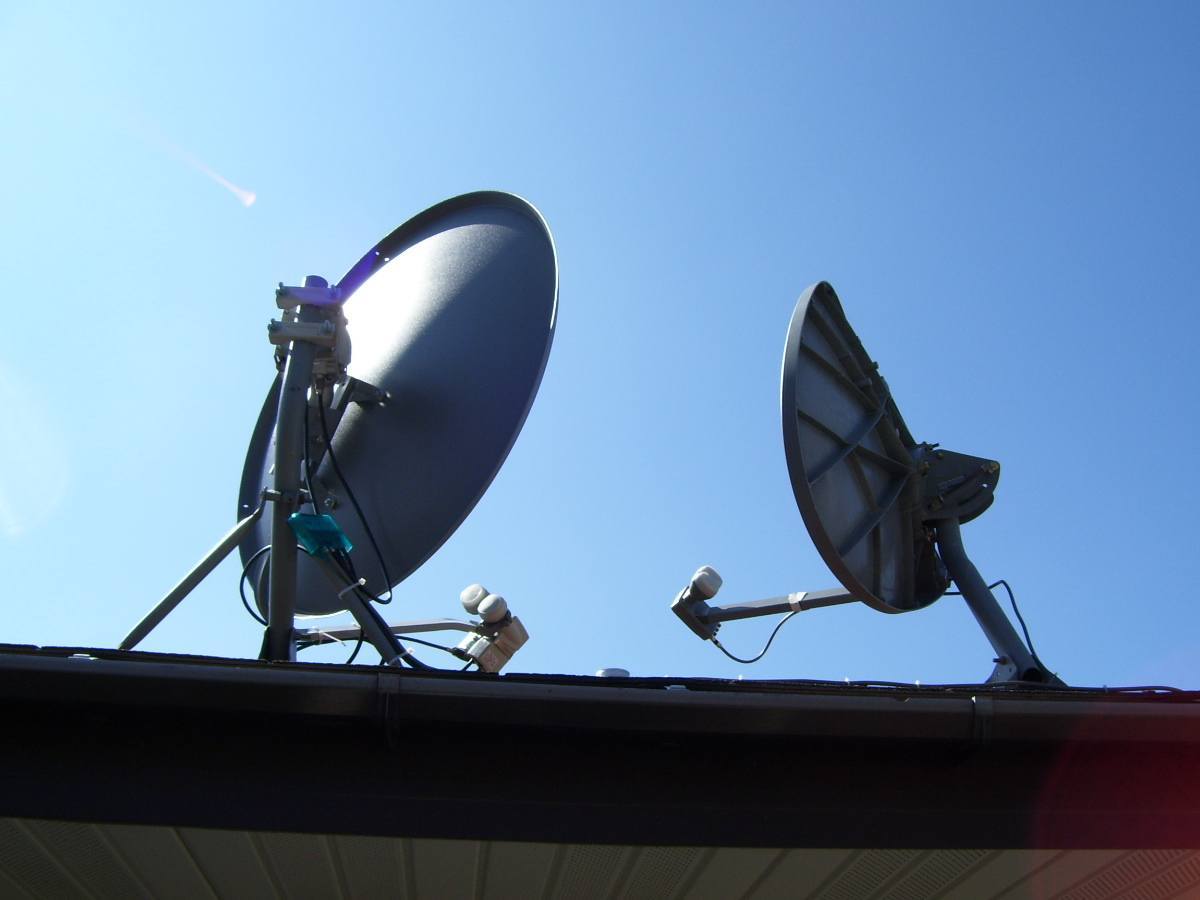

Yep-the dish will look all lopsided, lol, but not to the satellite. If you have an oval dish, it is better'n skewing the lnb!
yup
did it a few years ago
Interesting! I'm getting ready to set up a Primestar (Channel Master 75E) for 30°W, and had not thought about skewing the dish quite like this. I was just going to skew the LNB.
And, skewing the oval dish at 45° could work out even better for my LOS. I could move the dish placement from the east side of the corner of my house, to the north side of the corner, then tilt the mount out to 45° going north. This would move the base of it 4 or 5 feet more to the north and slightly further away from a tree branch too.
