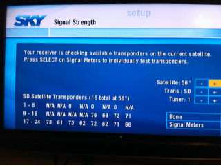

Here is a screenshot of the sat info. I don't know if it helps.

Your footprint might be the problem been in North Texas "Dallas"

Is you Sky eq working fine now in DFW area? if not, please notice that the LNB has to be the original Chaparral provided by SKY, because it is an special one with an stacker integrated on it. Else, you need the distacker device pluged on the back of your Sky +HD box.
Also, I found that Sky SD is on PAS 9 and HD on Pas 16, and if you check the beams are not the same, mainly in north Texas.
