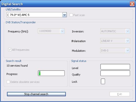

I have this card and played with the TV center software, but never saw the Blind Scan features.
Could you post a screen shot, or a step by step for the Blind Scan?
Thanks
Here's the screen it uses for scanning..

I reinstall my S2 3200 card (Same as Skystar HD) Just to test the blind scan and to me it does NOT appear to be hardware blind scan. My opinion
