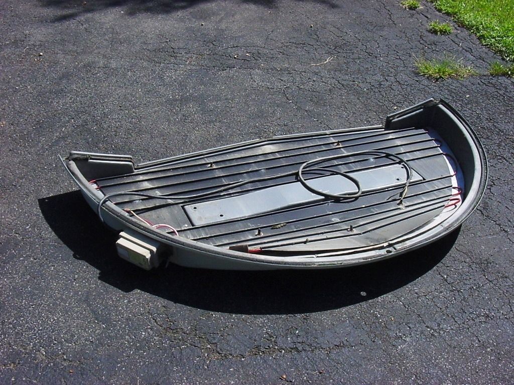

... Not so sure if it would work on my 'glass Ku dishes though...
Here's how my third Prodelin dish was heated. This was attached on the rear of the reflector.
