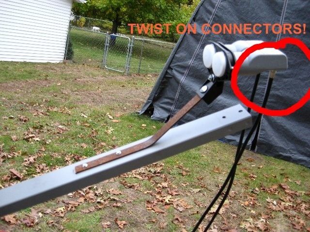

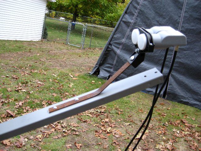

Ok so after having a couple hours to play with one of these dishes, I am a bit bummed with my results. I was using just one of the regular Dishes not the 1 meter. I was trying to modify it so I could do the Glorystar system.
So with lots of measurement I am sure that the LNB's are in the same location as the original. I was only able to get signal on one LNB, and very low at that. So I made a couple more modifications and was able to lock onto AMC4 with good signal, but no better than what I was able to get with my modified 1000.4. But atleast with the 1000.4 I was able to get both AMC4 and Galaxy 19.
So is the Primestar basically only able to get 1 satellite at a time? From what I can tell thats what it is. Would I have more luck with the 1 meter getting both satellite's? It will be more to modify that 1 meter, but I think it can be done.
You need to be able to skew a dish to get more than 1 sat at a time. There is a mod to do that using an E* dish mount & adapting it. It's somewhere in the FTA area about the mod.
Yes I have the bracket that mounts on the Geosat 90cm dish. So I can skew the LNB's. I used the same mount with great success with the Modified Dish 1000.4

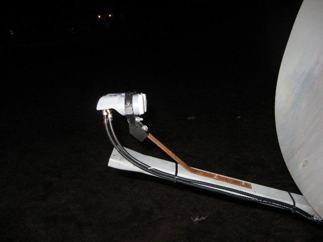

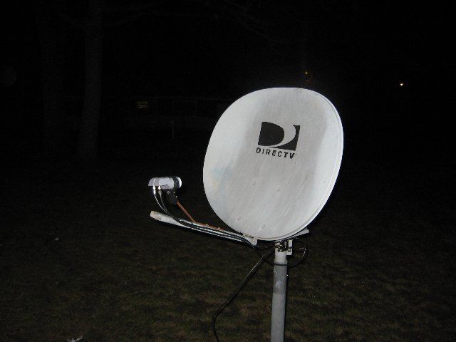

Well I have not really had time to mess with the PS dish since my last post....But
I was out doing an upgrade, customer was swaping out to a HDDVR. When I pulled up I saw they had the old side car dish and at first I was like man this sucks cause now I have to change the dish. Then I got to thinking 99 to 103 hmmmm 4 degrees of seperation... THe light Bulb goes on!
So here is my latest modification to get my Gma a Glorystar system on the cheap. This works even better than the 1000.4 and has almost the same signals I was getting with the Geosat dish from Glorystar.
The LNB mount is temp, I will craft a new arm soon. Then this will be off to grandma's.
