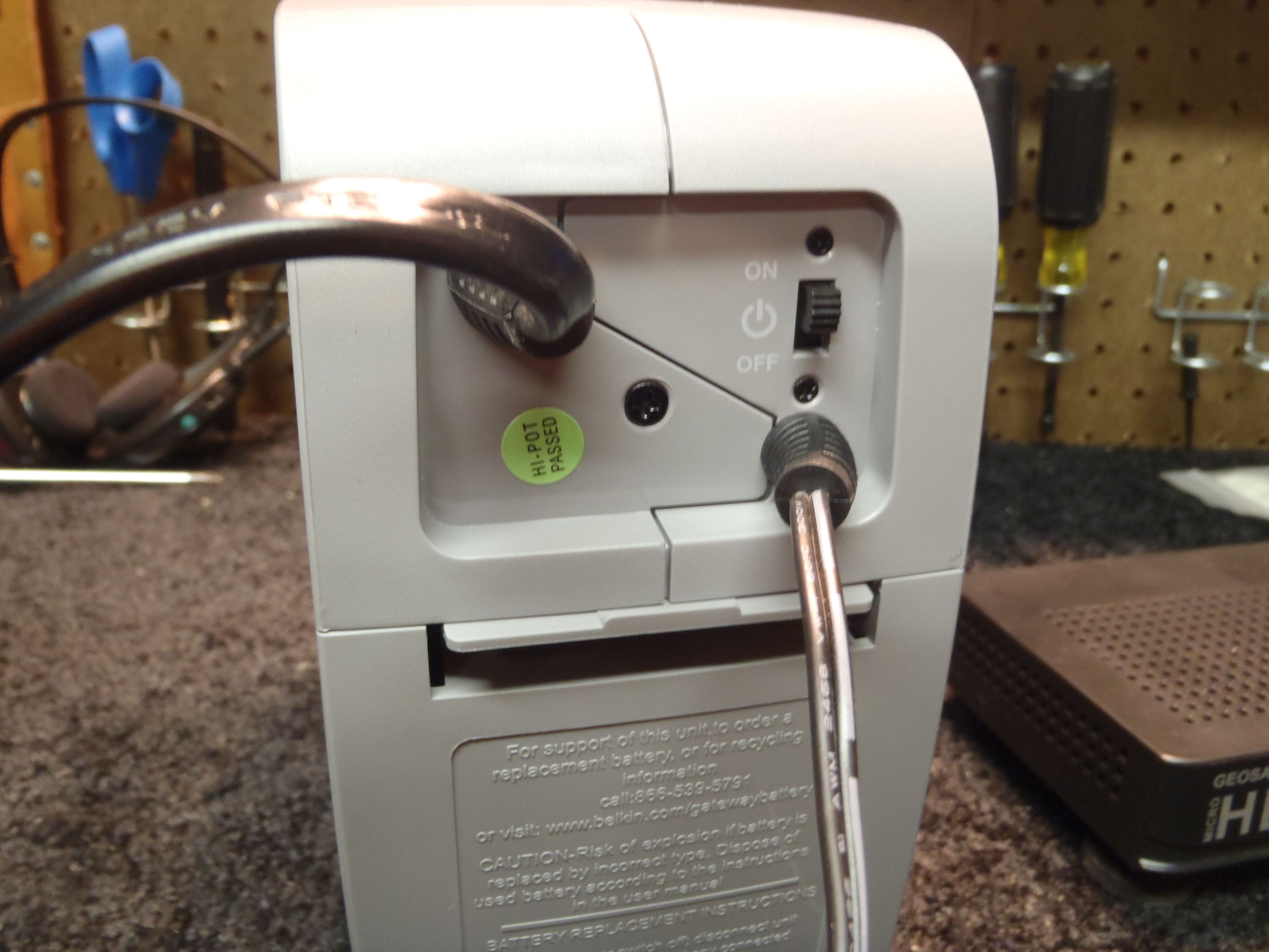

I found my holy grail of un expected things today at the Lansing flea market....
On the dollar per item table, this BELKIN battery backup unit sat, and when switched "on" it came to life! It has ONLY an attached 12 volt output, which fits the microHD receiver, (and probably the Amiko miniHD I'm using now! It's designed for residential use, and apparently often used with "uverse" setups. It's PERFECT for holding a steady voltage in to the receiver! Yes, a full UPS would protect all my equipment, but since this showed up for a buck, I'm OVERJOYED! Sick of resetting clocks and timers when someone sneezes near our power lines, and apparently no FTA box has overcome this simple issue yet!
The REALLY good thing is, they go cheap on Ebay! Search 'em down! Many are under $20 and many with free shipping! A perfect "aftermarket" power supply for FTA! Even the plug was correct for my microHD! OH, and the output is 3 amps, plenty of power for the upscaling of the LNB voltage, too! It actually put out a hair MORE voltage when running as backup than when in "normal" operation.
Hope this helps someone else like it has me!
Original mfr's link: http://www.belkin.com/us/p/P-BU3DC001-12V/
Paste that into Ebay and see what I mean!
Cheers!

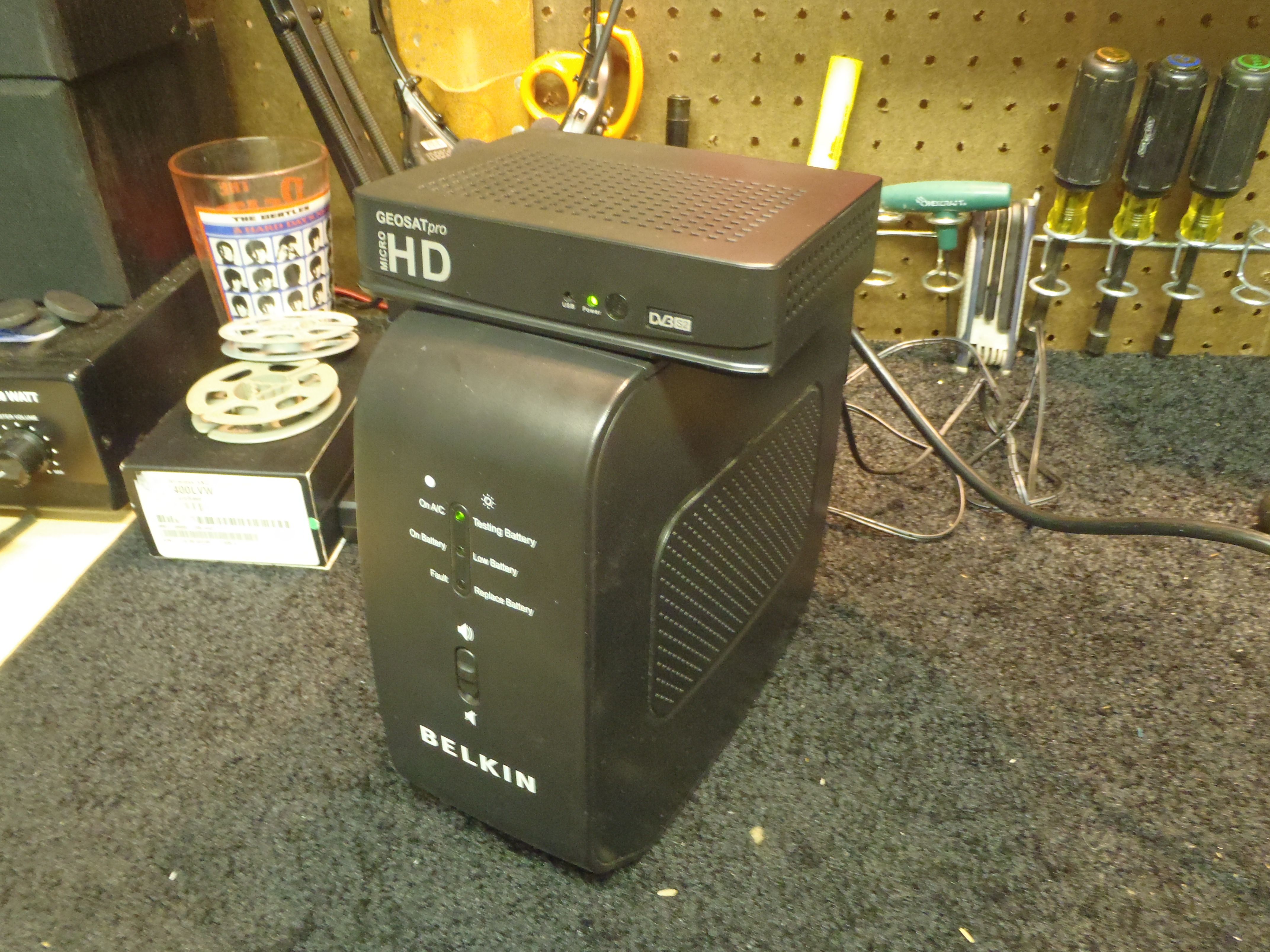

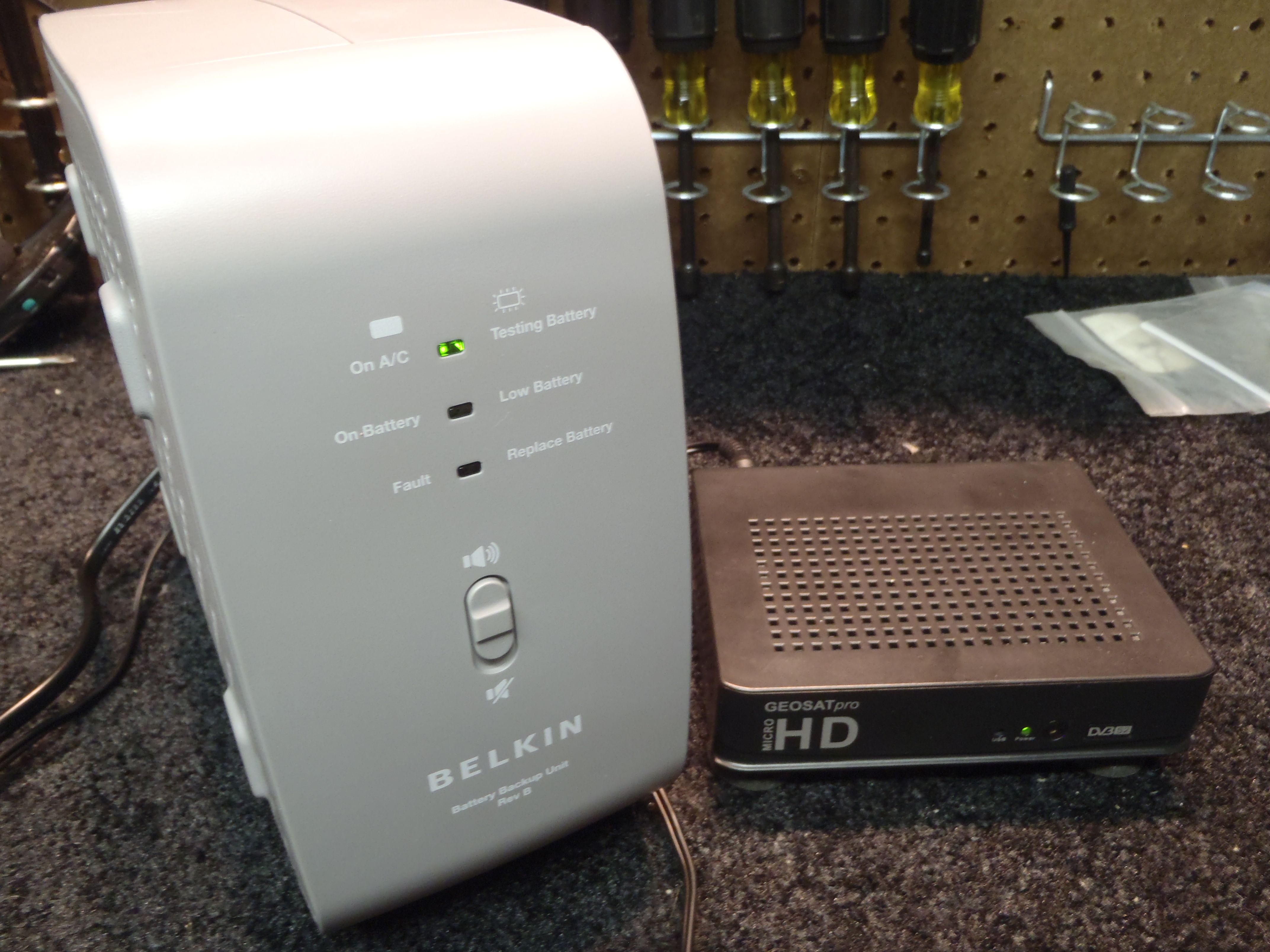

Testing right now! Glad you asked, I'll know before deployment on the Amiko. For a fair test, I put a C-band LNB on the MicroHD on the bench so the load of an LNB is on it. Will report back. It's "beeping" as we speak to tell me "hey dummy, I'm on battery!" So far 7 minutes, no issues, I expect a much longer time but for me this is fine, as our generator will kick in and run the station and apartment quickly.
STILL GOING......17 MINUTES......no sign of fatigue. Insert bunny with drum here......
Yep, and I didn't know such a box existed! (a 12-volt external UPS)...thought all these cable phone and other things had INternal batteries! Betcha our FTA gang
starts buying em up! You get a stronger power supply and backup all in one. By the way, over an hour now, no issues.
Going to install. Next test is if it "likes" power from a generator or not, some UPS units don't and constantly switch back and forth from battery to "off grid AC" and eventually go dead. Only ones I have for larger equipment that don't do that (110 volt units) are made by APC and actually regulate voltage at all times.
Putting this box IN SERVICE!
Deployed! And, the first picture with UPS in bottom of rack sure beats the heck out of the ugly "adapted/original" wall wart sticking out so far in the outlet you see to the right of the rack. The plug and polarity are perfect for both the MicroHD and the Amiko MiniHD

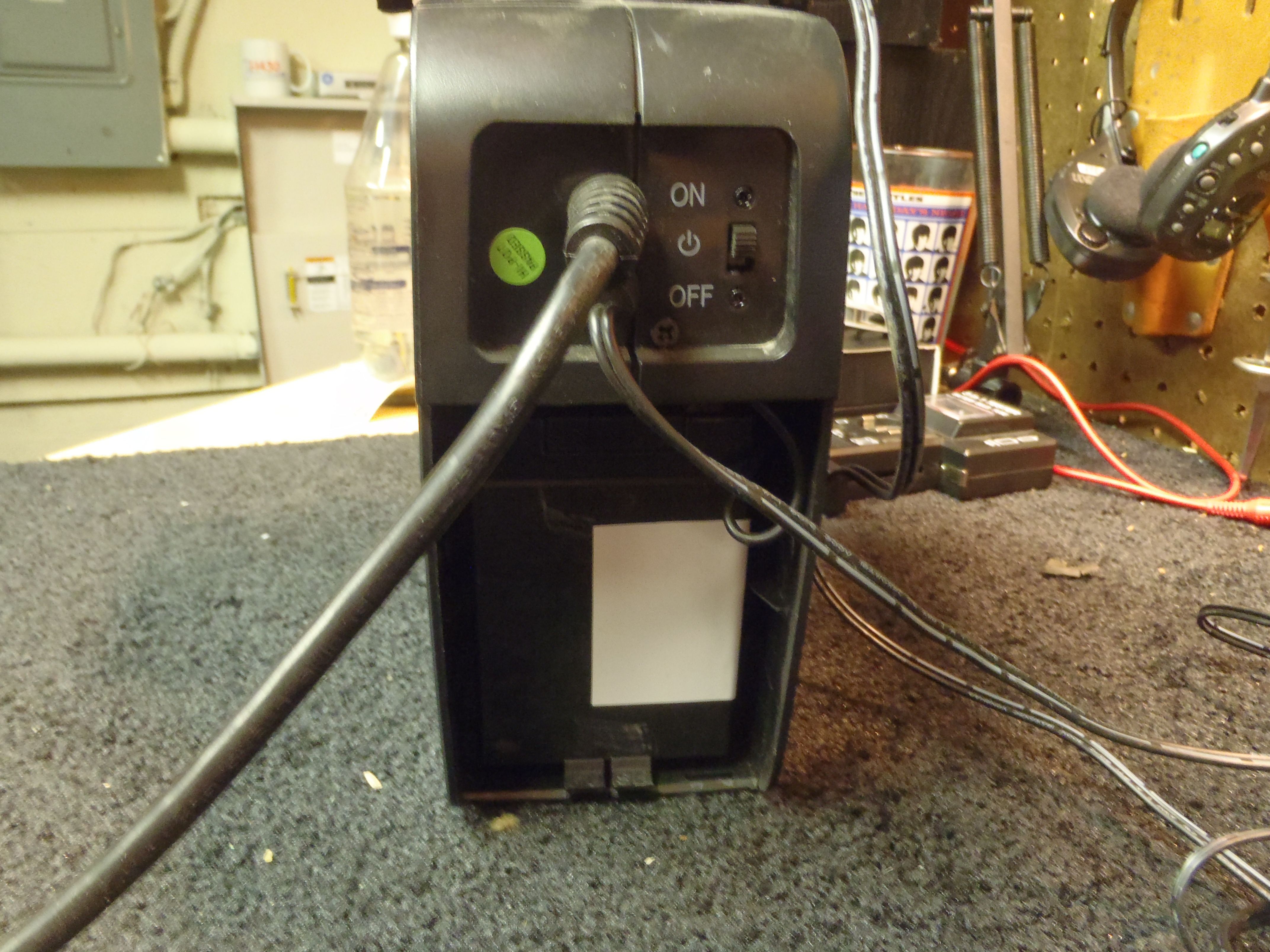

Funny, how (the same as when you buy a certain car of a certain type) you notice MORE of something AFTER you buy one...A local thrift shop has another one of these Belkin backups available but it is missing its battery compartment cover...If they'll deal on the price, maybe having another (for the next owner of my microHD??) around wouldn't be a bad idea....I also noticed today someone sells these on Ebay but modifies them to have a cigarette lighter (oops, "power outlet) for charging of cellphones. VERY creative uses for this little box! Maybe the local shop will deal...maybe I can find a back to this UPS somewhere, too, given they seem to "show up" now that I know they exist.
SO HAPPY! Because of this little "find" my FTA setup is properly recording tonight, after a daytime noticeable "glitch" in the power enough to upset our AM transmitter for a moment. These were the kind of moments that used to cost me recordings and some "old favorite shows" which are my reward for maintaining my own private FTA system! HIGHLY recommend if you can find these belkins to GRAB ONE. (if you don't have your whole FTA system on a big backup.
Don't let the missing rear cover stop anyone from buying. The cover is just for looks. Cooling is probably enhanced with the cover off anyway. The battery is held in place by the plastic tabs on the bottom of the case and not by the rear cover.
THANKS! Only got a quick look at it. Knew it held a charge. I really LIKE the fact these are meant to run 12 volt items up to 3 amps and marry so nicely to
our equipment. Will probably grab it and ask for a package deal with some other "gems" in the store.
Got the DEAL! $5 for the black version with it missing the back. Will be fine for "first" FTA install at a a friend's place soon, given that none of these receivers
think we need to keep accurate time. That would be the ONE thing of FTA that would really upset me as a first-timer if someone convinced me to go to it,
and I liked timers! A $5 investment here at thrift store for happy FTA new user!! Also wireless keyboard/mouse (name brand) and Zenith stereo clock radio for a client....all for $14. Not a bad afternoon after work!
