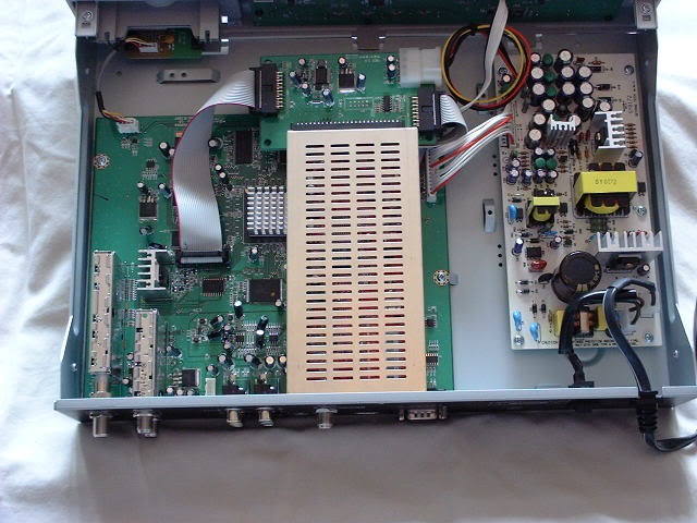

you should be able to get them with the SV....if you have an add on board in your receiver try selecting the internal tuner and not the add on board....
Ya I forget to do that sometimes because when I unplug the receiver it defaults to the add-on board and it gets way less reception and won't blind scan. I don't even understand what the add-on board is for I should just take it out because it is a hassle.
the add on board is a "hackers board" to get a certain providers HD channels....you dont need it for FTA....all it does is make the receiver run hotter....
that part I knew. Didnt know if it was easy to remove or not ;)

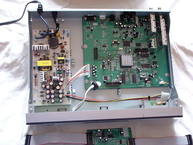

oh sorry....yup its simple....5-10 min job at most....4 screws to remove the cover....then you just have to unplug 2 ribbon cables....remove the board....re-install cover....done
some reference pics i found....with and without the board....
