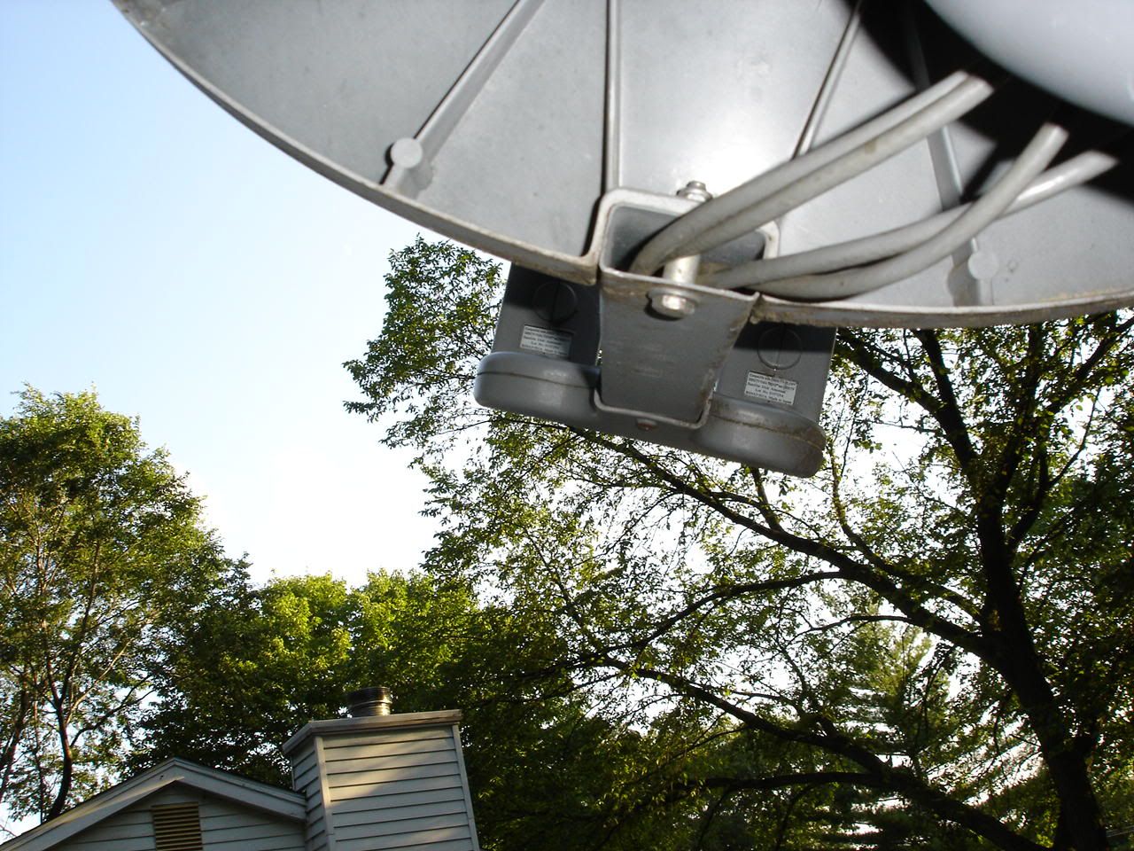

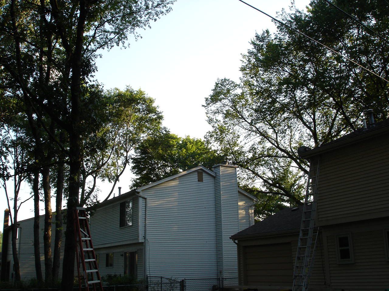

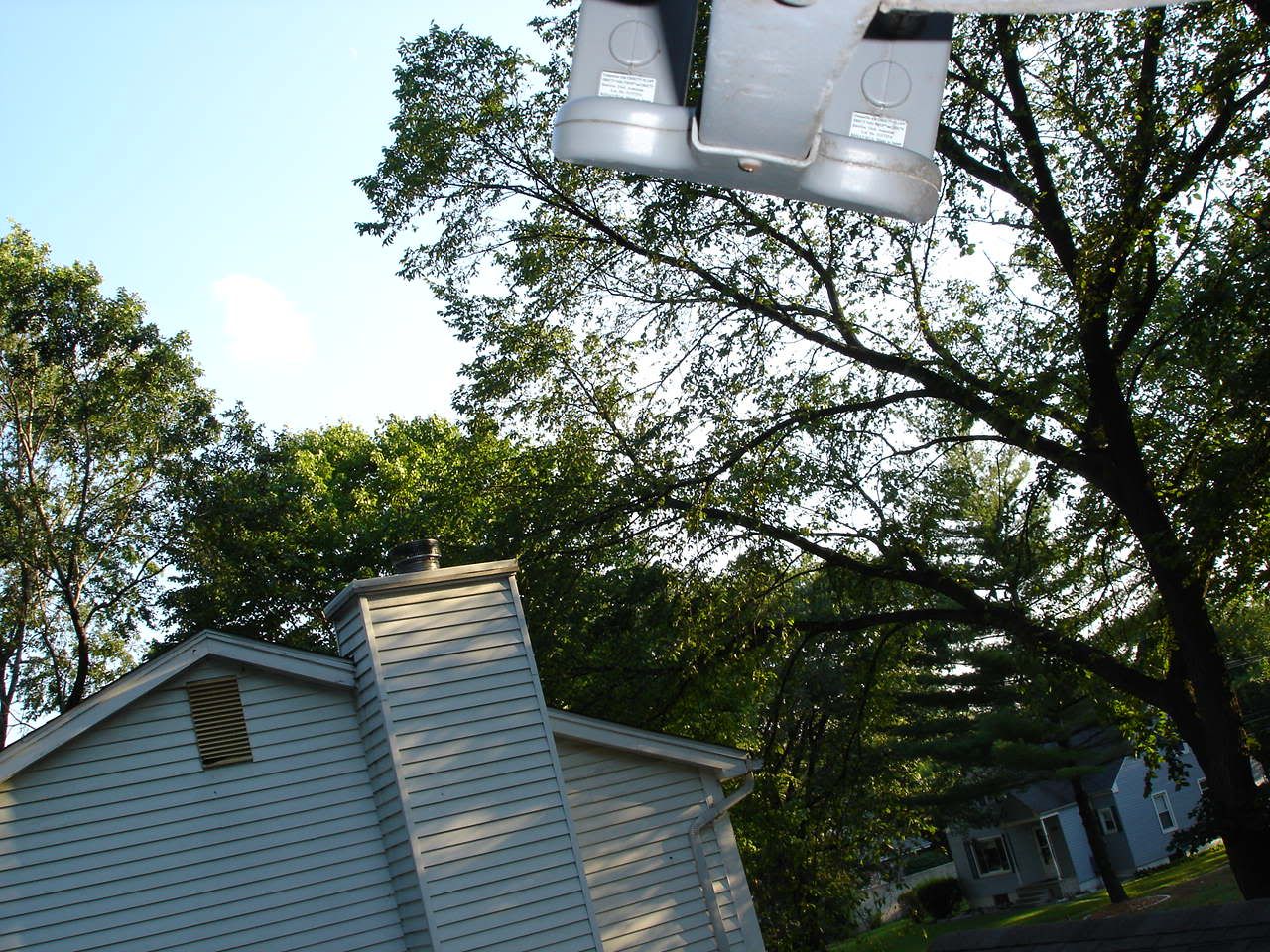

Not sure the correct tags for pics but here are the links showing current location of my dish on the side of my 2 story house.
Pics: http://i55.photobucket.com/albums/g150/DetRedwingNut/SatLocation.jpg
http://i55.photobucket.com/albums/g150/DetRedwingNut/SatLocation2.jpg
When you originally set up your T60, did you select "oval dish, 2 LNB's" in the guided setup? If not, try rerunning it with this & set if you get a signal then.
Yes, the dish you have should give you 119.
But, since you are having a tech out, he should be able to fix this fairly easily. (assuming it's not a tree issue, etc. - then obviously you might need a chain saw... :D :D )

My setup is for an oval dual LNB system. I ran system check to attempt to reacquire the 119 sat info but it didn't work. :(
When I setup the new receiver they would only upgrade to a 3 LNB instead of the 5 as i attempted to get.
my sat 101 readings are from 75-99. Do you think it could be a tree issue with the inability to acquire 119 from the pictures I posted?
I have a spot I thought would be great for a pole mount but really was hoping to get the 5LNB since the pole diameter is different for a 3 and 5 LNB setup. Is this info correct?
Here's the location I have where I could do a post install.
http://i55.photobucket.com/albums/g150/DetRedwingNut/PossiblePolelocation.jpg
Would I be wise to just install a post at that location tonight to ensure future ability to receive all satellites? That is the only location on my property with a clear view of the D* birds. (even though I'll have to replace the pole when I'm upgraded from a 3 to 5 LNB setup?)
