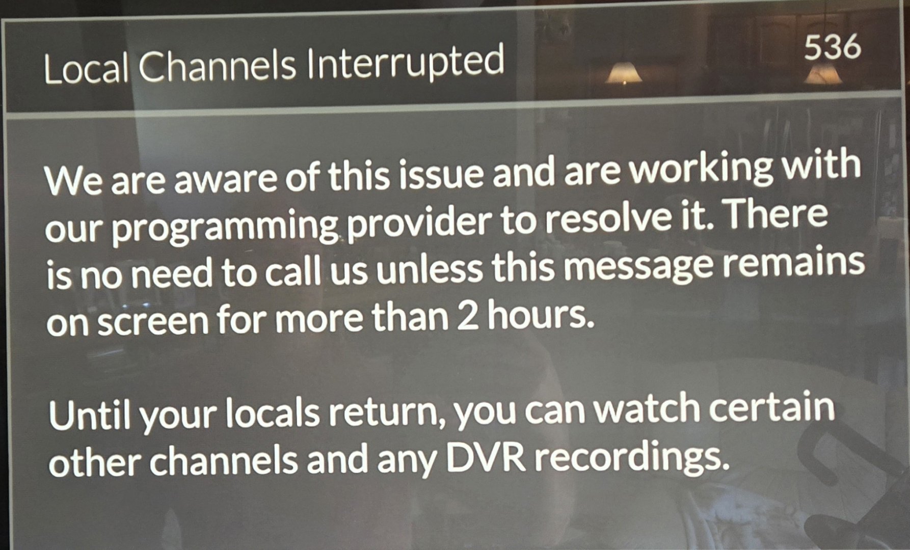

I've "lived" in St Louis and have received their locals for about 15+ years off the EA. We don't watch DISH very much, but about a week ago I noticed the locals were not tuning in. The reciever messages given are
Seems thelist is gone and I'm having a heck of a time trying to find transponder spot beam maps. So, my questions are:
Which EA satellite/TP are the St Louis locals located? I'd like to check the correct TP for signal strength. Looking at 61.5 and TP 21 gets me OK green signal strength at 41.
Is there a current carriage dispute or other issue from DISH's end?
Where can current spot beam maps be found? I've found James' Local Channels on DISH Network (Unofficial Listing) but that might be outdated and doewsn't contain maps.
Thanks

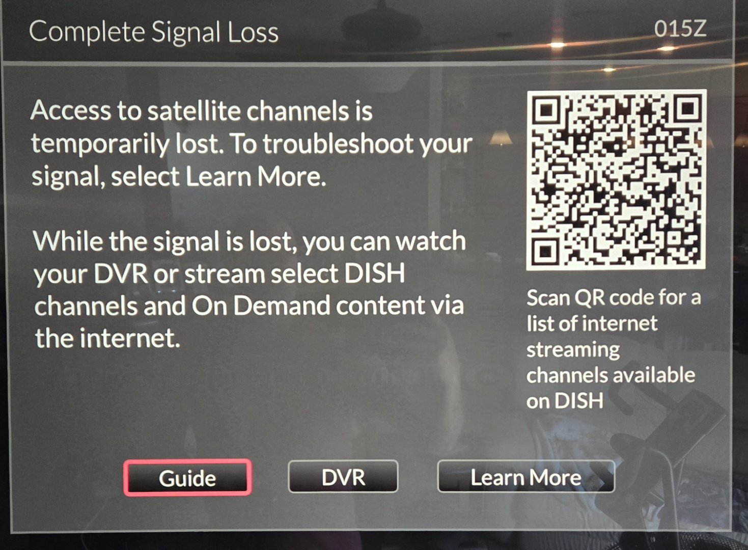

In General, we get a message only on our Joey 4.0. It's not message, but our Broad Signal is lost. Doesn't happen on any of other Ŕecei

In General the only receiver that this happens with ìs our Joey 4.0, and the message is Broadband Signal is lost. Goes offcomes back on less than a minute
That sounds like your Moca signal is degraded in the house cabling between receivers.
