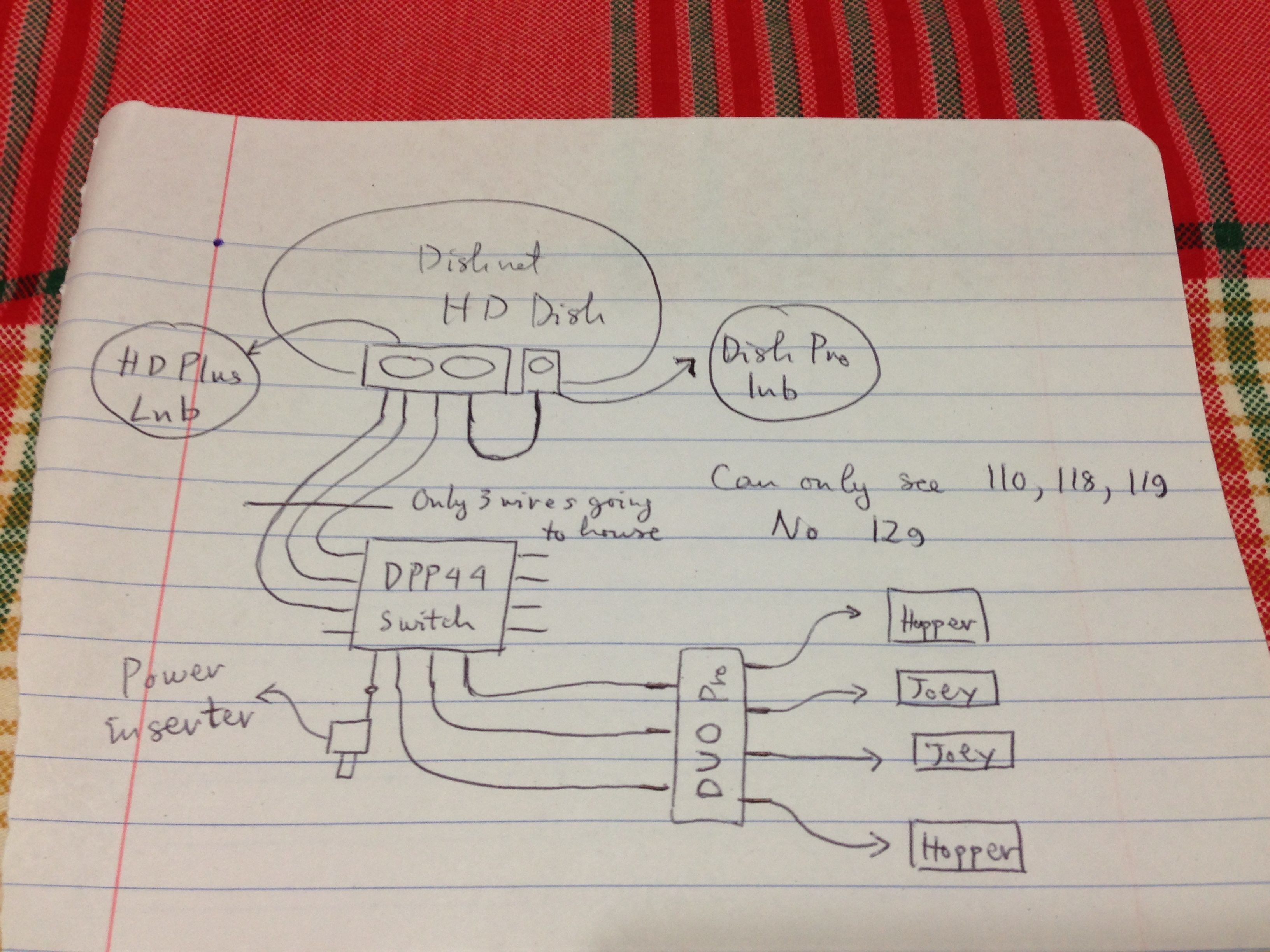

So I have a question and not sure if this setup is possible.
Like I said above, I have 2 hoppers and 2 Joeys, and I also have ViP722 as well. Now the problem is that the way dish guy installed for me is as follow:
1. 1 4-ports Dish HD Plus LNB (110, 119, 118 - I believe)
2. 1 1-port Dish Pro LNB (129 bird I believe)
3. He has 3 cables go to my house from the 4-Port Dish HD Plus LNB. The Dish Pro LNB he connects to the 4th port of the Dish HD Plus LNB.

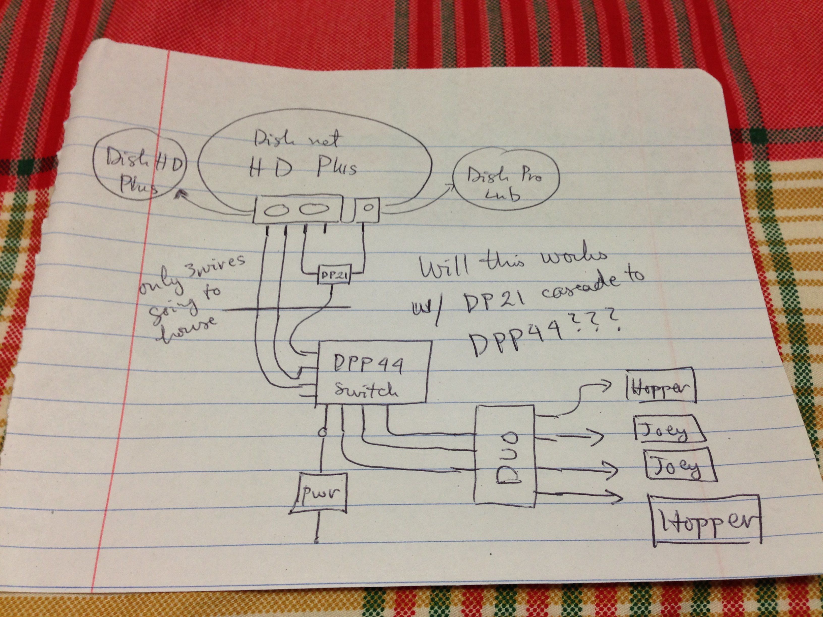

Now with the DUO switch, the hopper be able to pick up all 4 sats with just 3 cables. When hooking these 3 cables to DPP44 in front of DUO switch, Hopper can only pick up 110, 118, and 119 sats (no 129). I am avoiding running another cable from the dish down into my house so I am wondering if a DP21 will work with DPP44. That is, hooking up Sat 129 and 1 port of the 4-port HD Plus LNB to the DP21 switch and then use the output line from the DP21 switch to 1 sat port of the DPP44. Will this setup allow DPP44 to have 4 sats link together using just 3 cables? If not, is there any other way beside running another cable into the house from the Dish?
