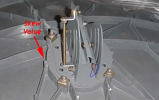

Question- with a 75cm dish the numbers for my location-95404-indicate a skew, or tilt, of "-14.1" for Anik F1. On the physical dish itself the 90 degree mark puts the dish perpendicular with the mast, straight up and down, no tilt.
Is the number "-14.1" added or subtracted from the 90 degree mark, or an I way off on my thinking..should the mast mount be rotated to 104.8 or to 75.9?
Thanks.
I see from the page Iceberg linked earlier that the skew setting for San Francisco is "76" so I'm assuming that means subtract the 14.1 number from the 90 degree setting.
The edge that is part of the sleeve that holds the mast? IOW, the edge is on the interior of the assembly, not on the exterior anywhere on the adjuster assembly.
Quick and dirty pic, the edge that's marked by the blue. Only on the other side of course.

I first did mine without the bolt on the side (the left side on the above picture) - putting in on last.
I was just as confused as you - and the instructions on the other site are not that great - as you noted.
There is an edge behind the opening where the bolt mounts - to the left of the tip of arrow denoting the skew.
That was what I finally decided was the indicator - and what I think Ice is referring to as well - of course you cannot see it if you have the bolt in place.
I guess they assume most will use a gauge to set the elevation and fine tune it with a meter - which obviously is the final step anyway - but they certainly could not have made it more difficult.

The same edge that I've circled in blue, only I've circled it on the other side since the pic doesn't give a view of the edge that we're talking about. I'll be using a guage but I wanted to rough it in before going on the roof-105 degree temps here lately-in the shade..:eek: :p

No, on the side of the point of the red arrow.
I have marked it in yellow.
Look through the cut out for the straight edge without the bolt in place.
or if you prefer from the pdf listed above:
Yes, that's exactly where I was talking about, you just can't see it the pic I used so I marked the opposite side.
frntchr, thanks for the PDF link, much, much better than KuSat's info. :)
