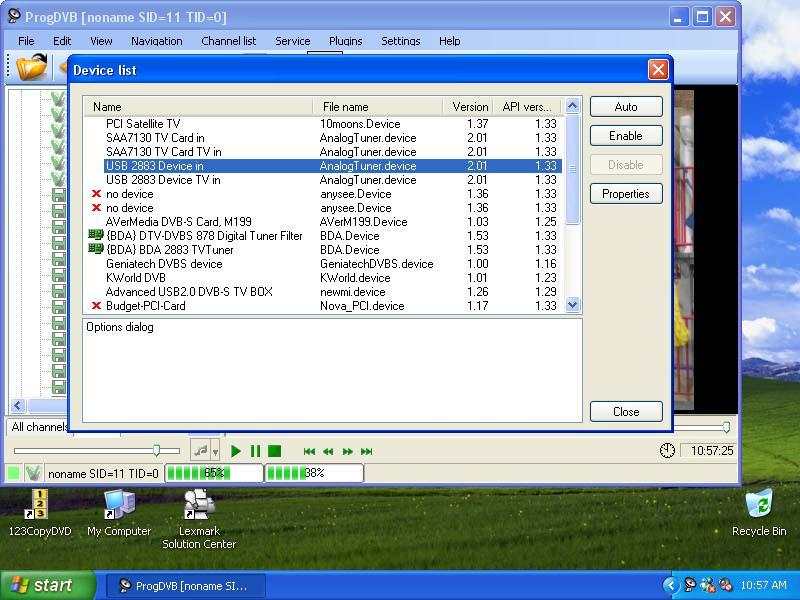

Well, here I am, humble as ever. I've been trying to get Progdvb working with tt s2-3600 . Finally got the interface to show up in Device , but can't enable it , get " Run Graph Error " . The whole concept of graphing is alien to me, I think. I've been using DvbDream with autograph, and just fiddled with codecs until it worked. Any idea of how to get ProgDvb past this point ( and maybe further my education ) ? English language links would certainly be acceptable.

"ProgDVB must work with BDA and WDM driver. If he install BDA then
must select bda.device in options->device list, if WDM then
Nova_USB2.device."
He gives you two options.
You can uninstall and when start up screen asks for device you have a pull down screen to select BDA. Then go to settings, device list and select BDA 878.
If this is not good then uninstall and select USB device at start up then settings, device list and USB. Also in settings pull down go to device options and look at choices there if any.

I've been messing with the BDA drivers, having no luck, so I'll put the WDM drivers back in. At least they were working with Tsreader last night. Thanks for the research. Prog and I swapped at least a dozen emails, getting my Progdvb registered. The registration server had no record of my purchase transaction, and both my first two keys showed up as locked. After 18 hours he got me a key that worked the first time. :)
He's dogged about support, but he's got a big job doing it.
[edit] Progdvb IS working under WDM drivers. Successfully scanning in G18 right now. Small Victory ! Thanks for the encouragement, Tom.
