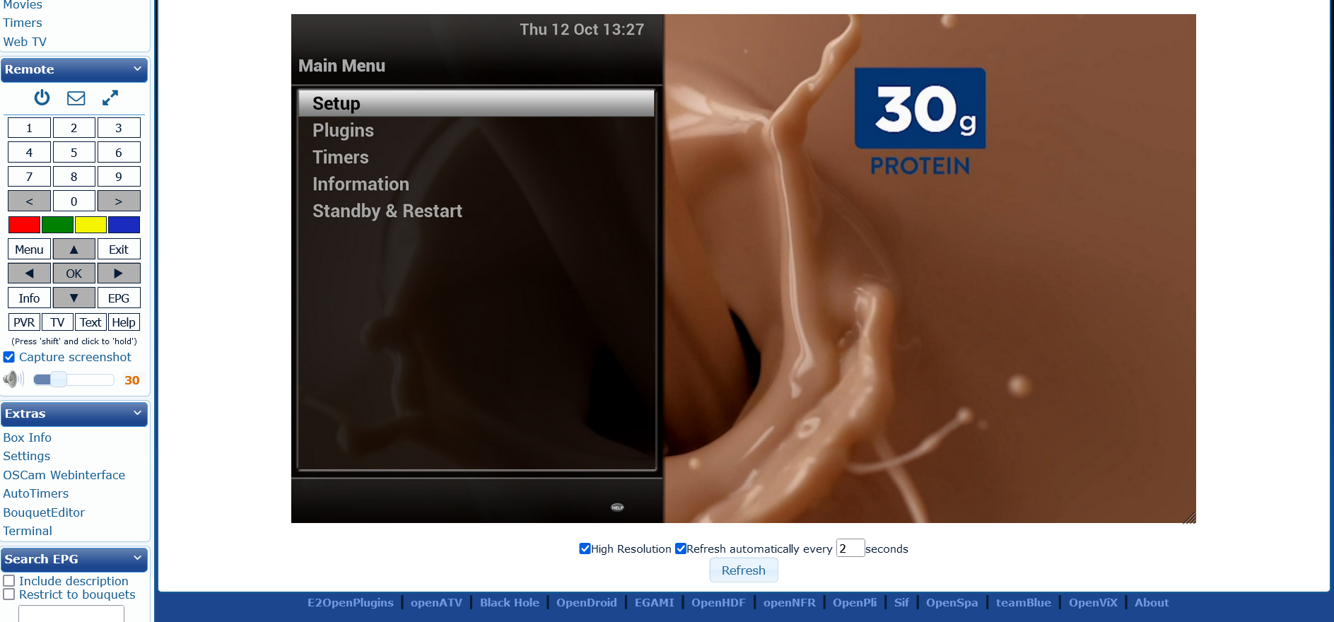

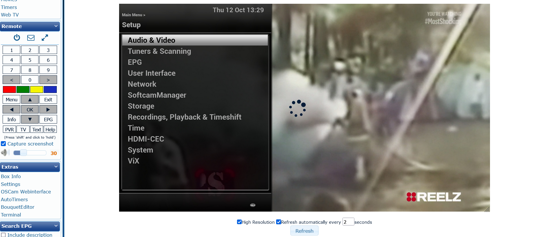

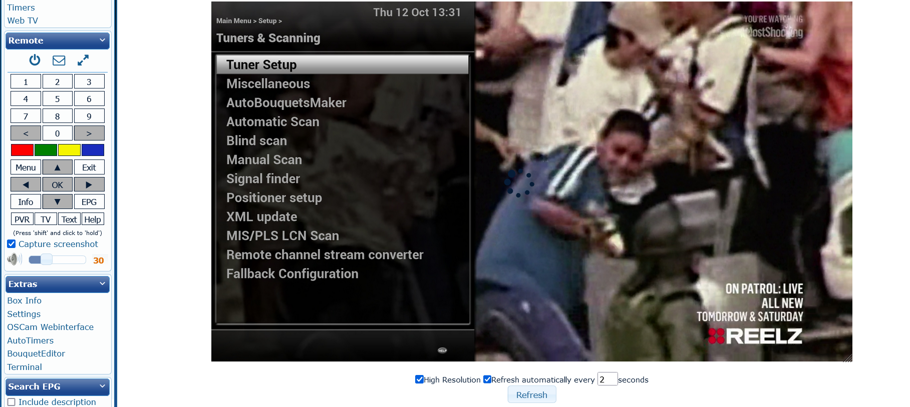

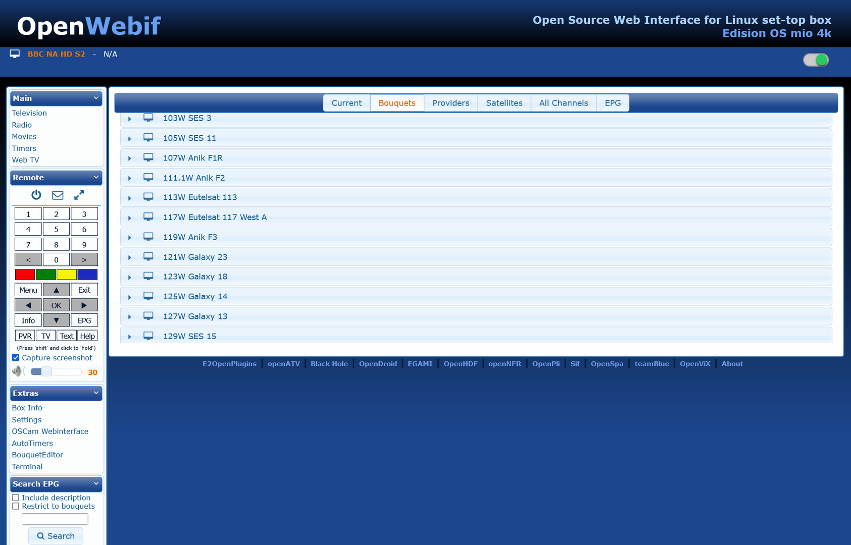

OpenWebif_Tunersandscanning.pngOpenWebif_Mainmenu.pngOpenWebif_Menu.pngOpenWebif_full.png

Thank you for the information and the screenshots. This is exactly the information I was looking for. My plans are to completely locate the dishes (C & Ku) some distance away (think miles) and horse everything back on an 11GHz microwave link, so obviously everything has to be remotable. I'm looking into exploiting NodeRED to work the polarization and positioner controls if that isn't something that is already handled by the receiver.
