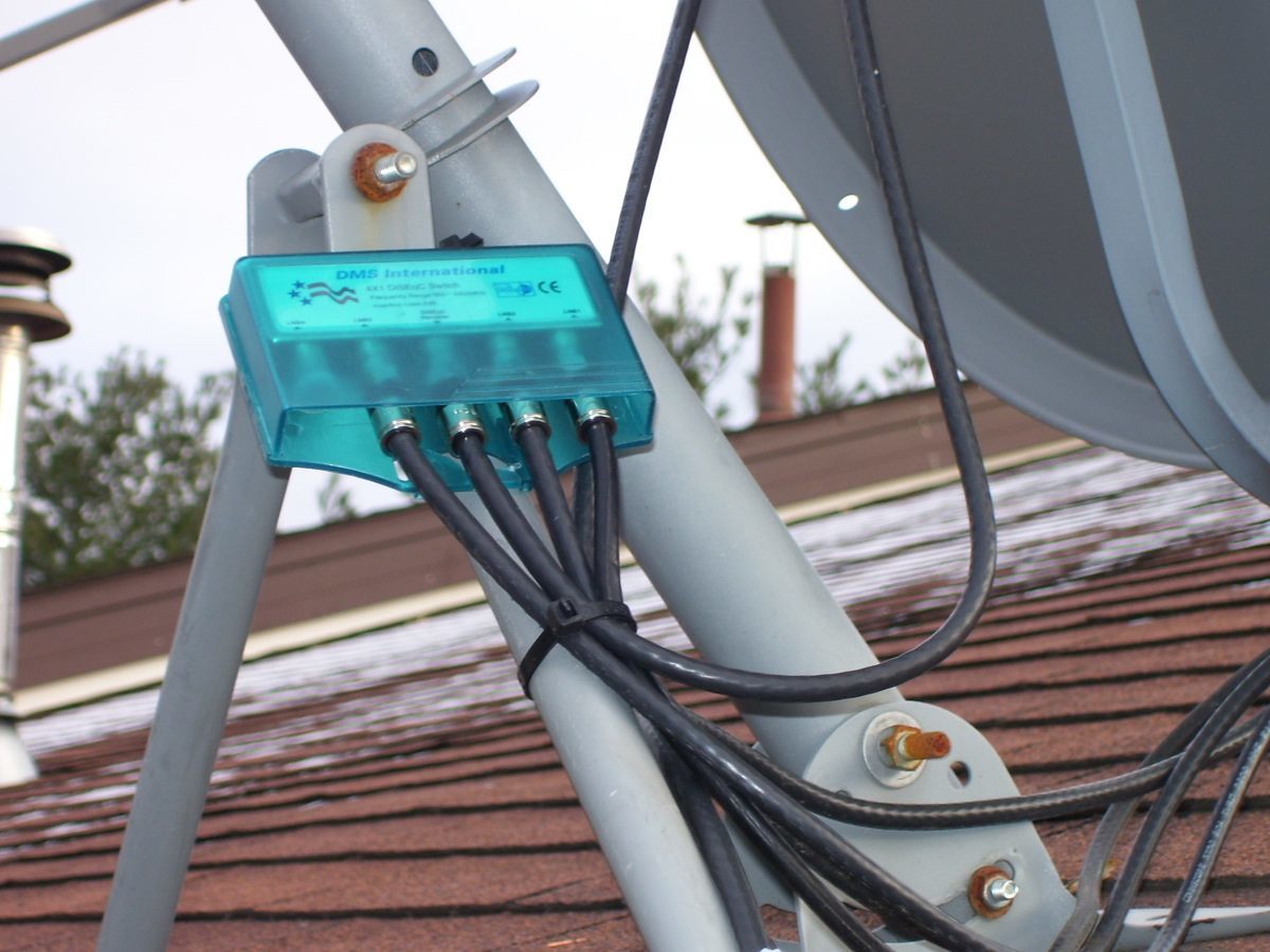

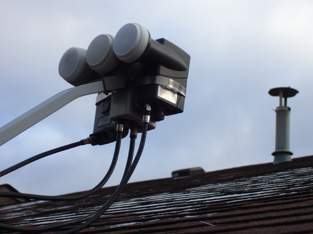

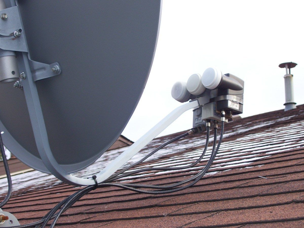

I use to have 3 LNB's on my motorized with a diseqc switch
-DBS
-KU standard
-KU Universal (that is when Cubavision was on 58W)
The reason I mainly used a standard is I have my old analog receiver slaved to the Coolsat 5000 for any analog KU feeds (which are getting fewer and fewer by the day) and the Universal LNB would make the frequencies on the analog off my 150Mhz
