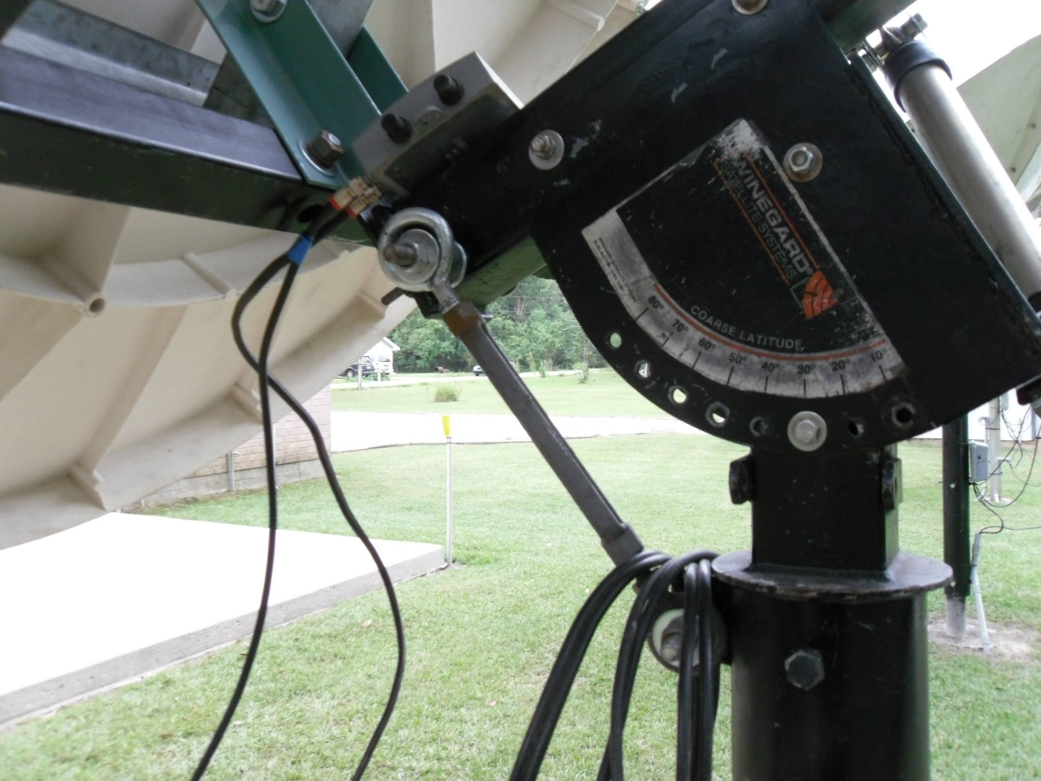

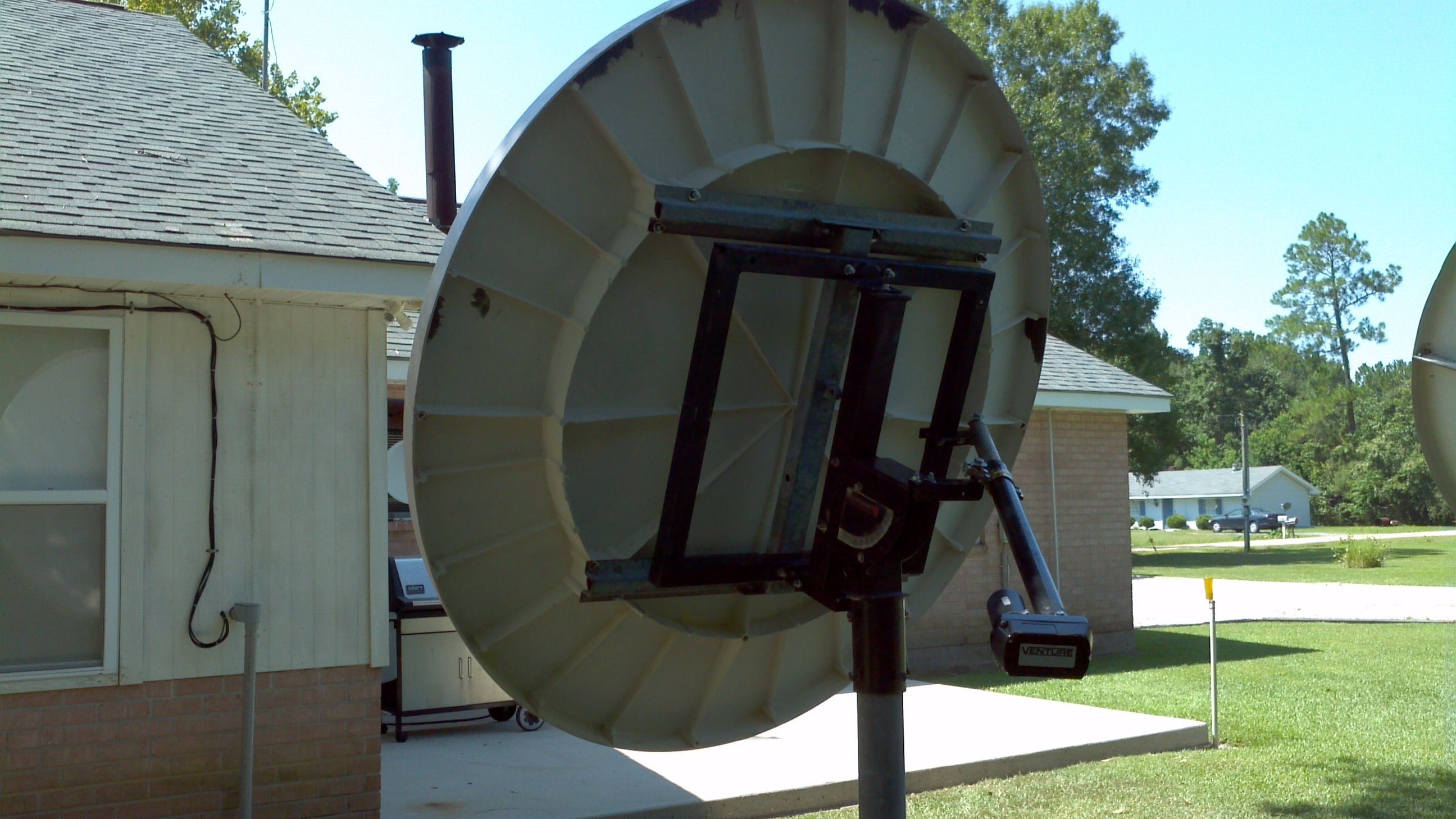

I messed with it half a day, can't get it to track. I think the bracket is tweaked due to the weight. The motor just b-a-r-e-l-y moves the dish. Crashed the Coolsat twice trying to move it, in fact. This may be a write-off, and I'll use the dish for something else. The 1.8 is going where that dish is, anyway, soon as I find a polar mount to adapt it to...LOL
I shifted gears...I remembered I had an old Winegard Pinnacle mount...that should work with the 1.8....
So I pulled the old 3" pole up, planted the 4"pole for the winegard mount...

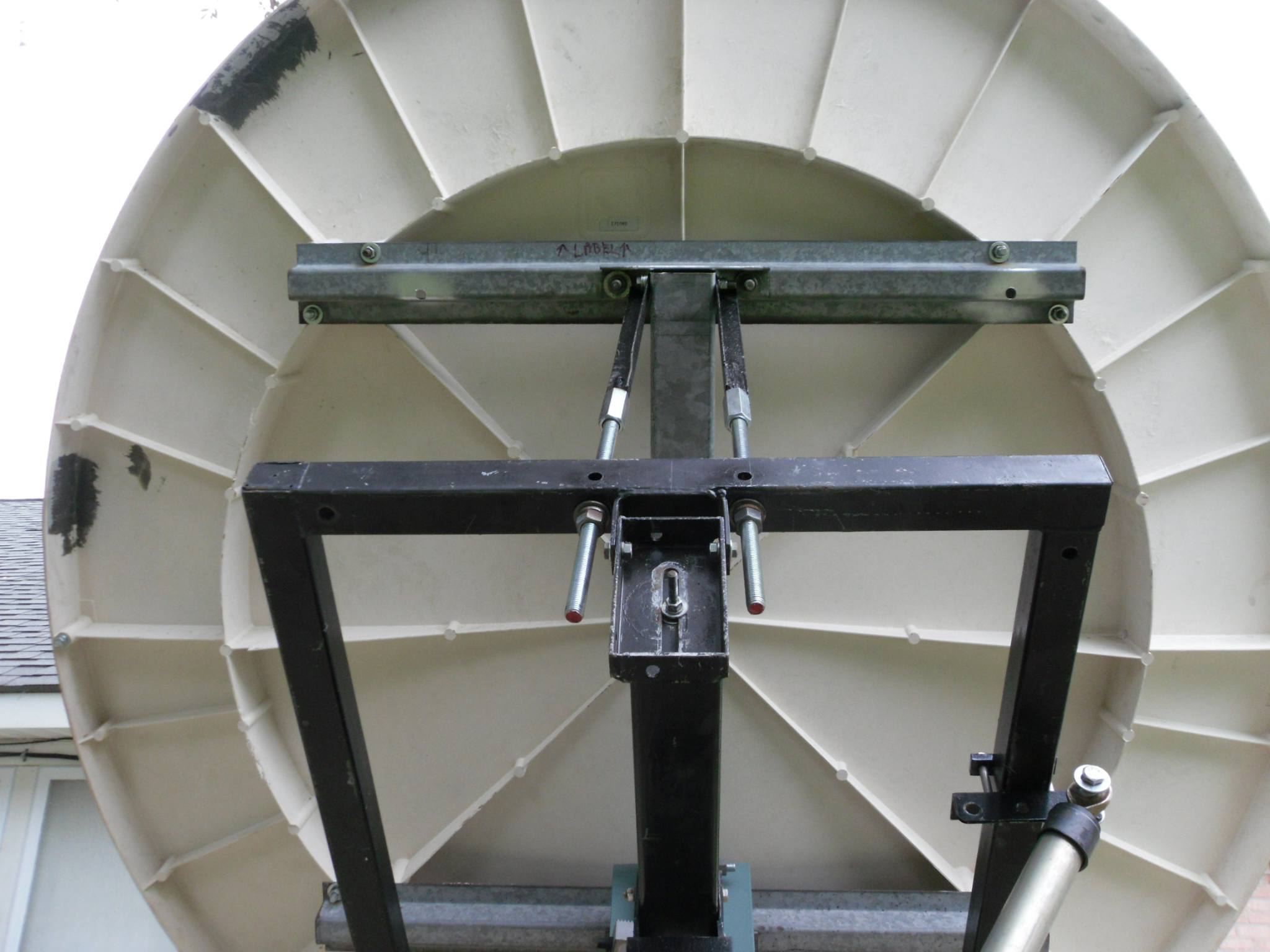

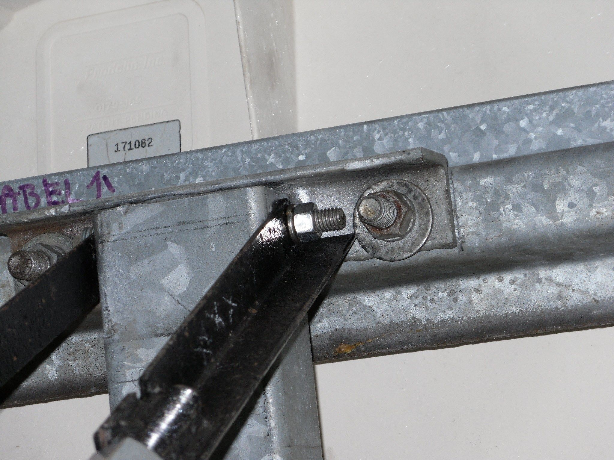

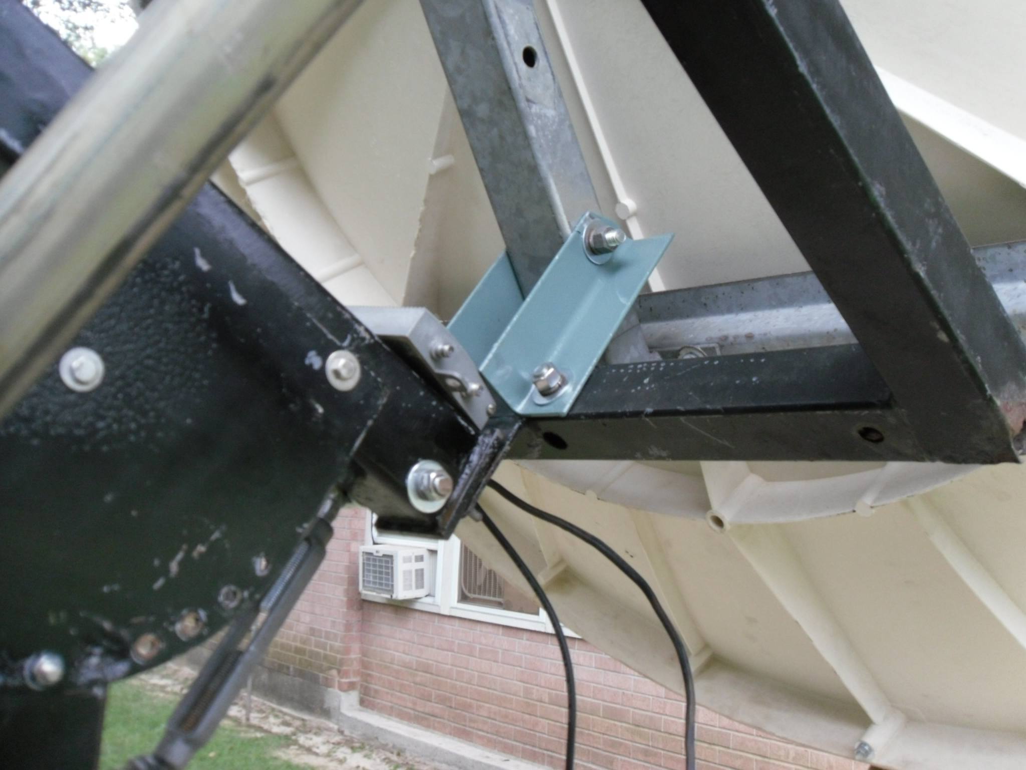

Then set about how I was going to bolt the winegard mount to the Prodelin frame...immediately I thought of my old friend the U-Bolt...centered the mount on the Prodelin frame, drilled holes through the winegard square tube...
Then I realized the bolts were too long, so I broke out the sawzall...:D
...and here it is ready to mount up. Soon as I get some help. ( its HEAVY!)
Stay Tuned. ;)

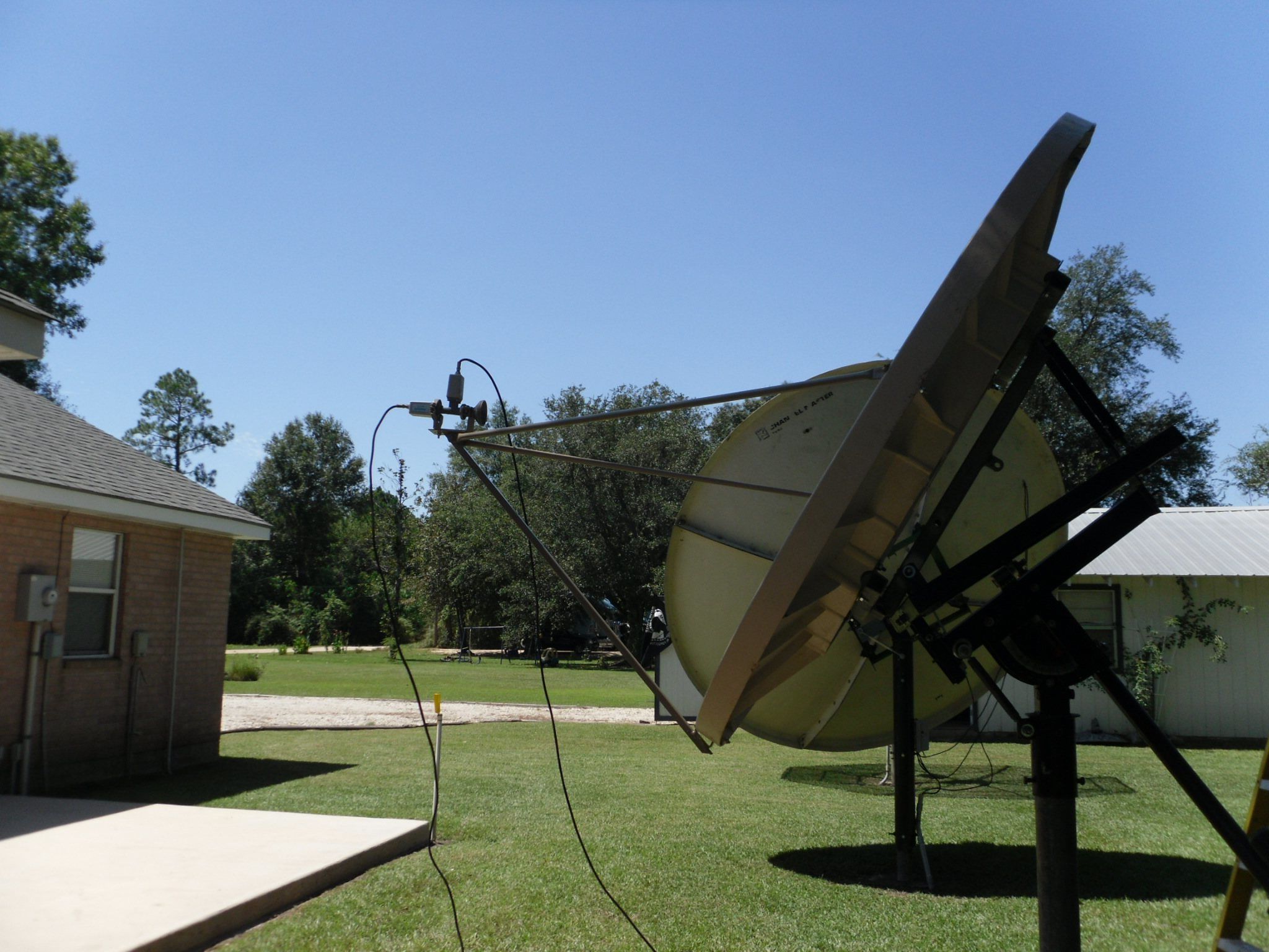

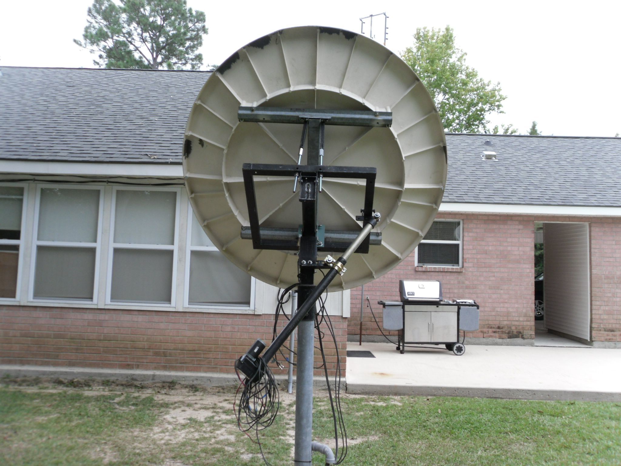

I went out this morning, and with a little help from my understanding wife....did this...I didnt tighten anything down just yet just wanted to get it up there to see what it looked like...LOL

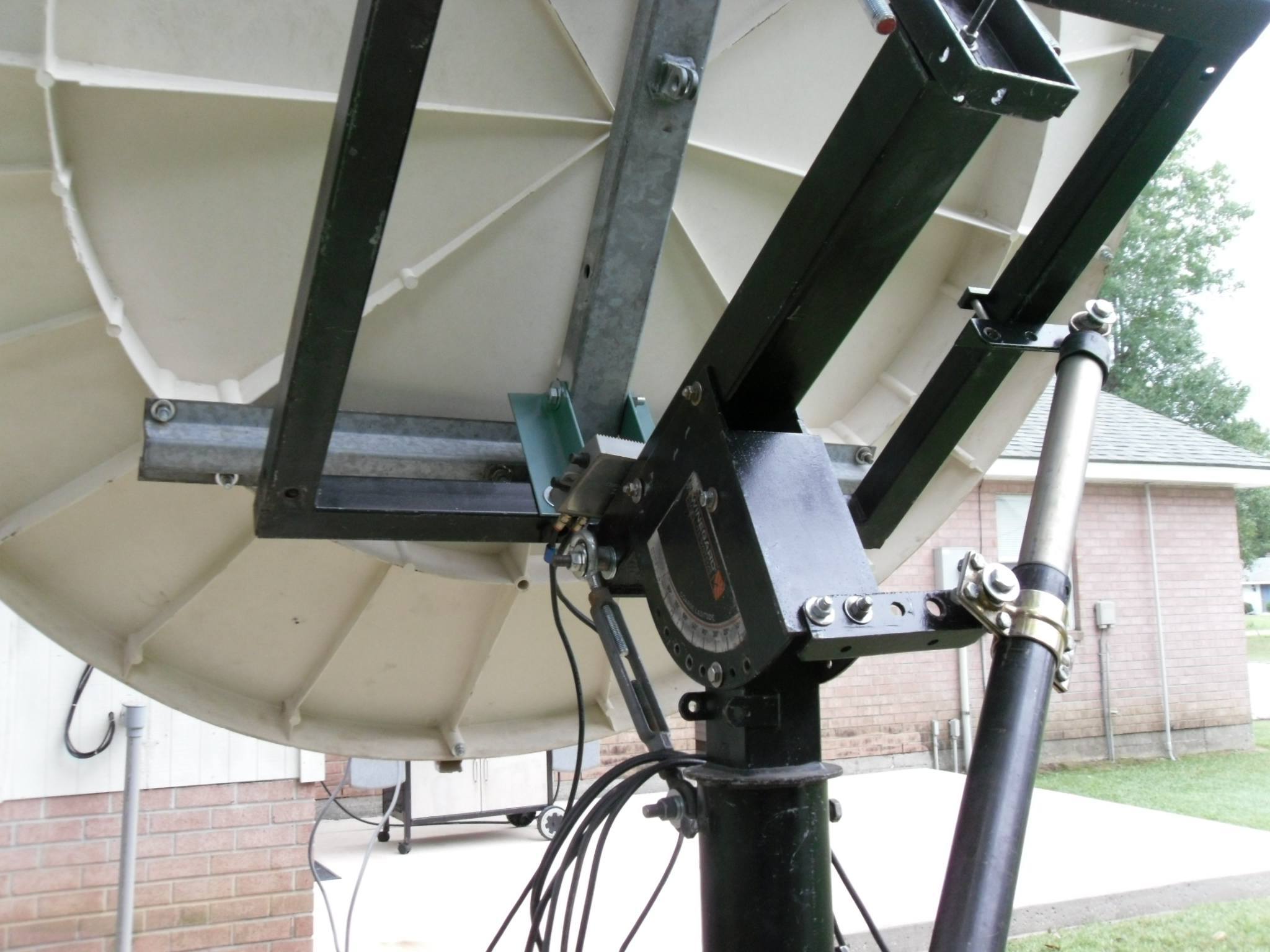

You are ahead of me, I just installed the mount, dish frame and declination bracketry today.
If you don't already have it I think you are going to need to figure a way to tilt the top of your dish forward, while keeping the main elevation bar of that polar mount set to your latitude, to get it to track?
I am mounting mine on a AJAK 180, just trying to copy what pendragon did with his, will try to post a thread/pics within a day or so.
I agree. Going to have to have declination + dish offset instead of just declination as would have with a prime focus.(was typing, then noticed it had already been addressed, so the quote.

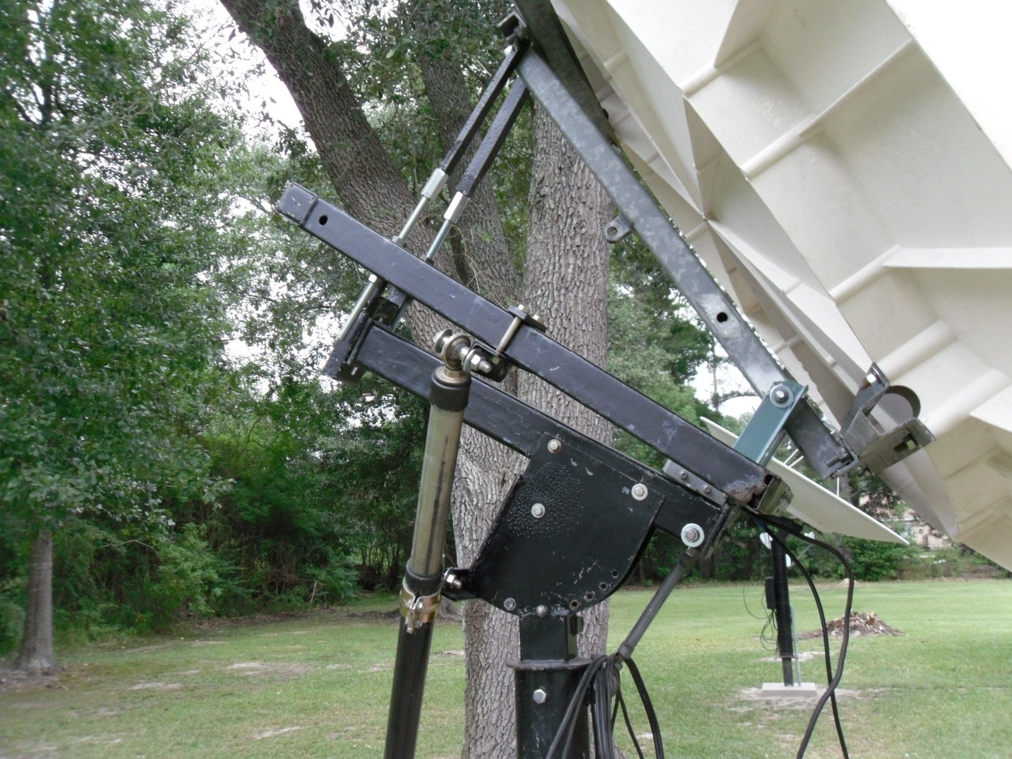

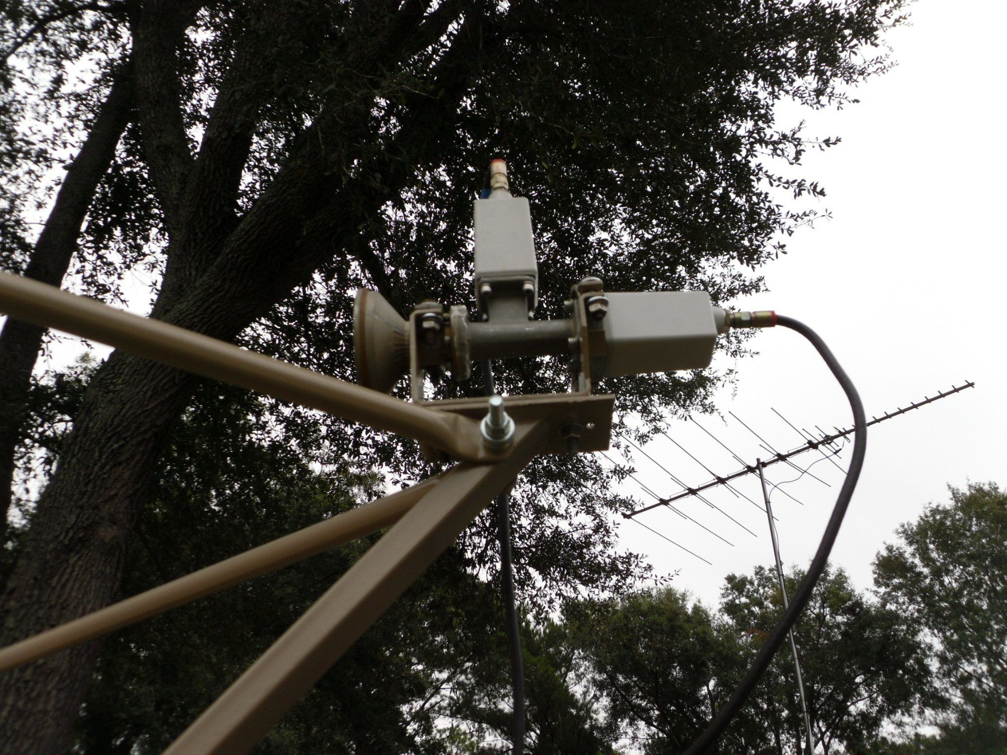

Man you guys sure have a a lot of confidence in me....between Tropical Storms, Vacations, and numerous reworks due to backyard engineering cockups, its coming along. I have put it on and off the mount three times now reworking the bracketry.
And yes, Tony, I do take pains with the details, just because I have to LOOK at it every day. :D
Sneak preview: But it has changed since that picture was taken.
Its getting there. After many trial and error reworks its finally tracking the arc, only for me to find out my mover box was bad, so I am waiting on Sadoun to ship me a new Gbox for it, figured I might as well get the Cadillac if I was going to have a Cadillac dish... :D
