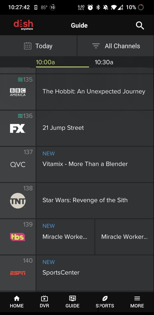

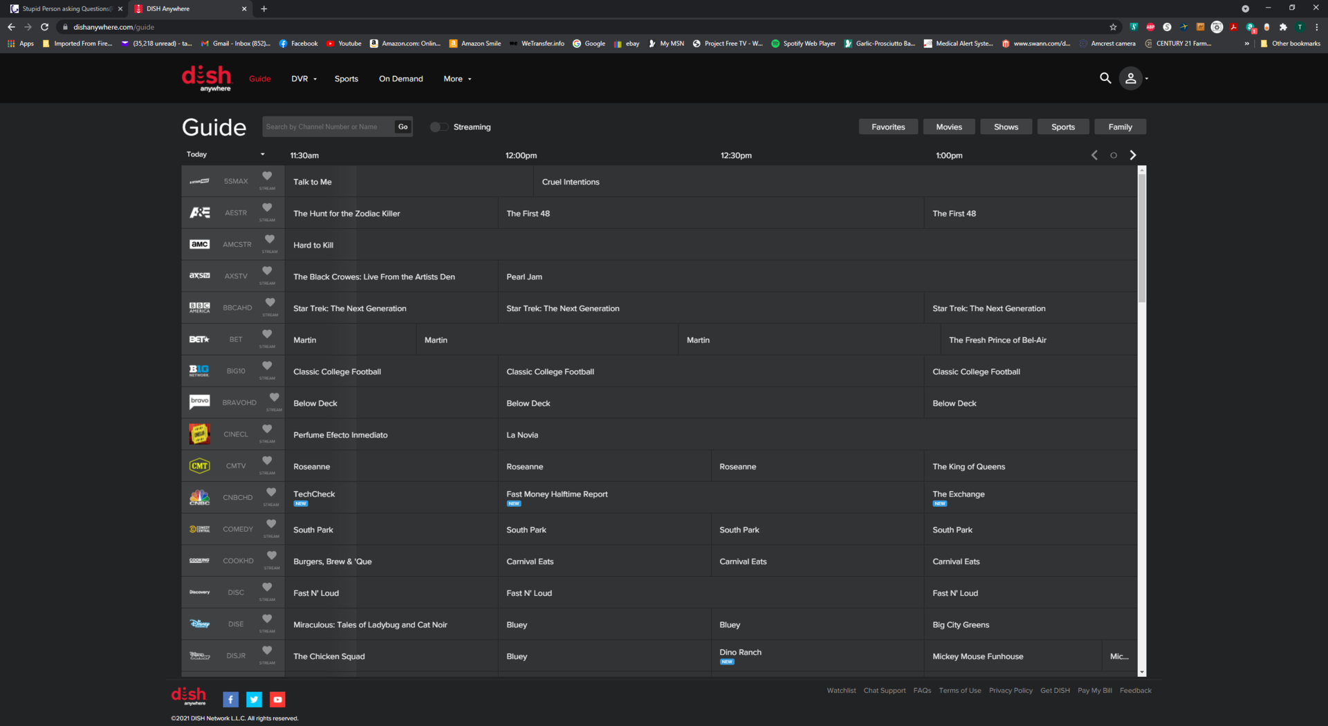

Honestly the easiest/fastest way is getting the app on your phone and connecting with your Dish account, it's a free service to any regular (dunno about commercial) customer on any package and you will see exactly what's available streaming since the 622 is on your account now. Here is a screenshot of my phone, the green wave thing next to the channel number indicates internet stream, and is the only type of channel that will appear on your guide without sling capability

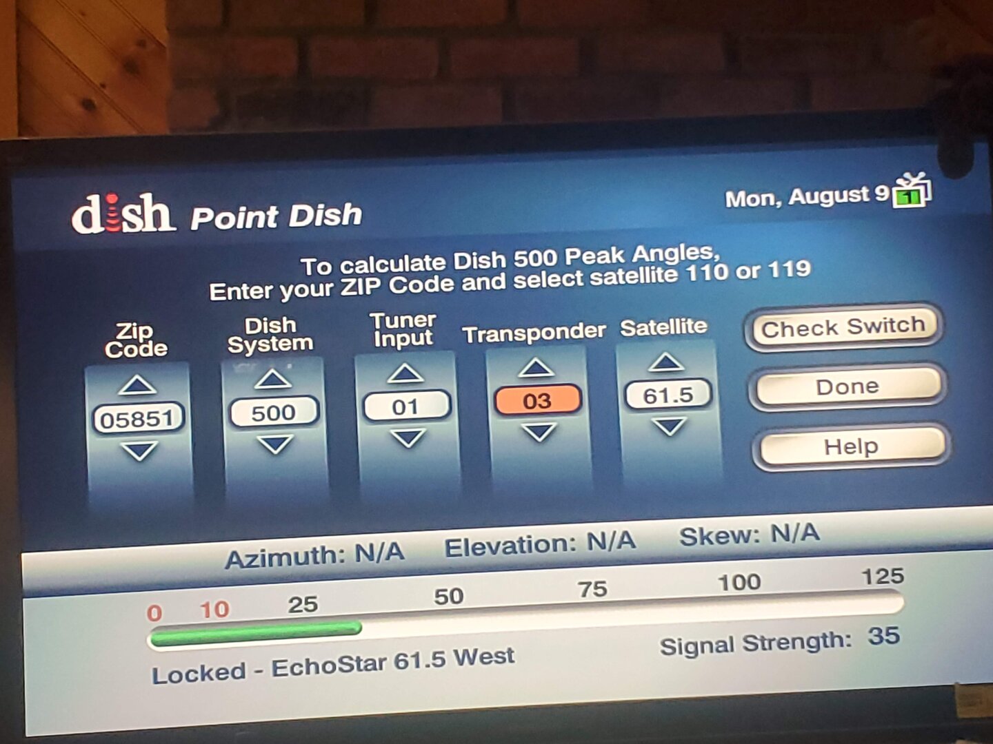

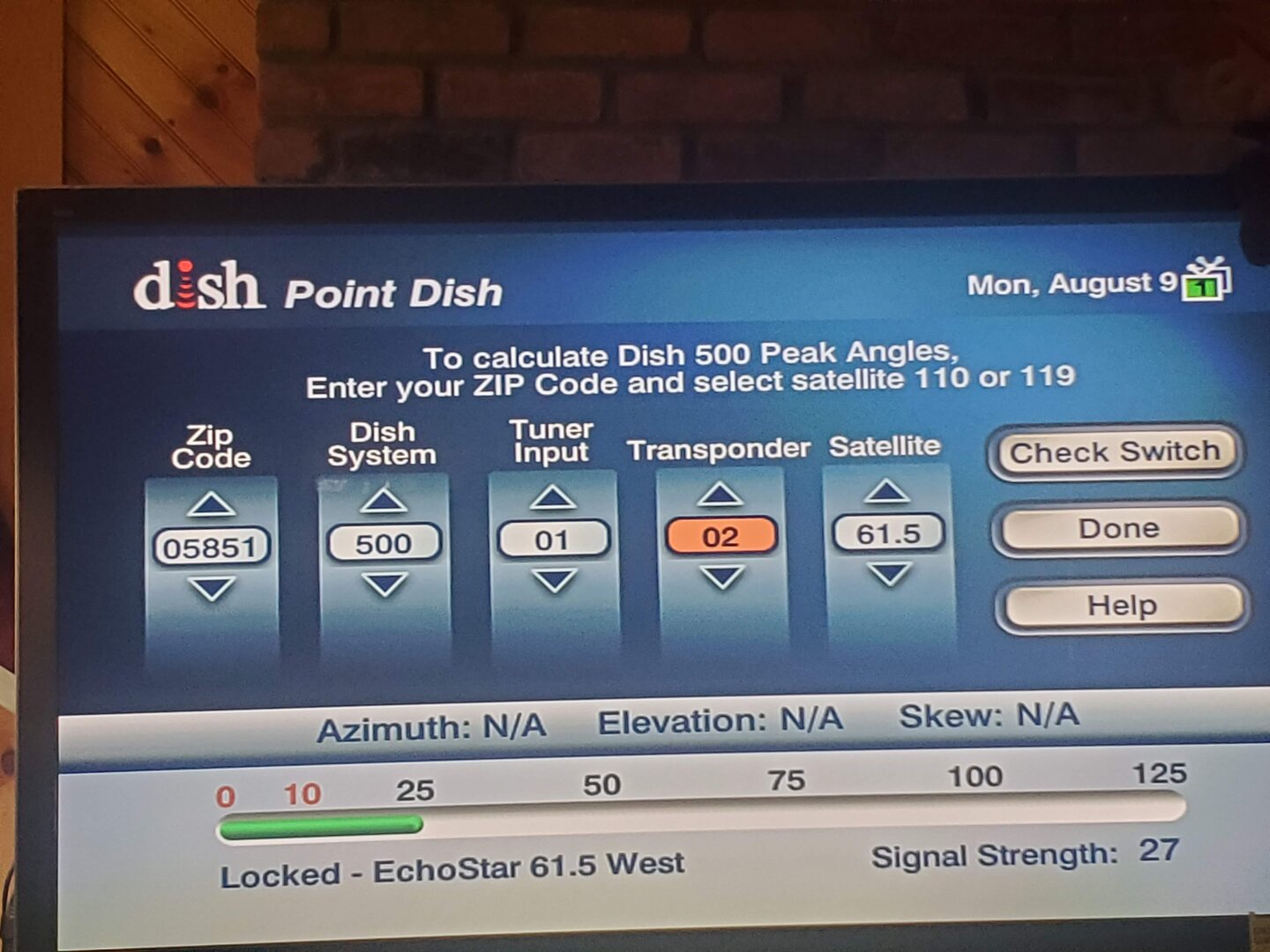

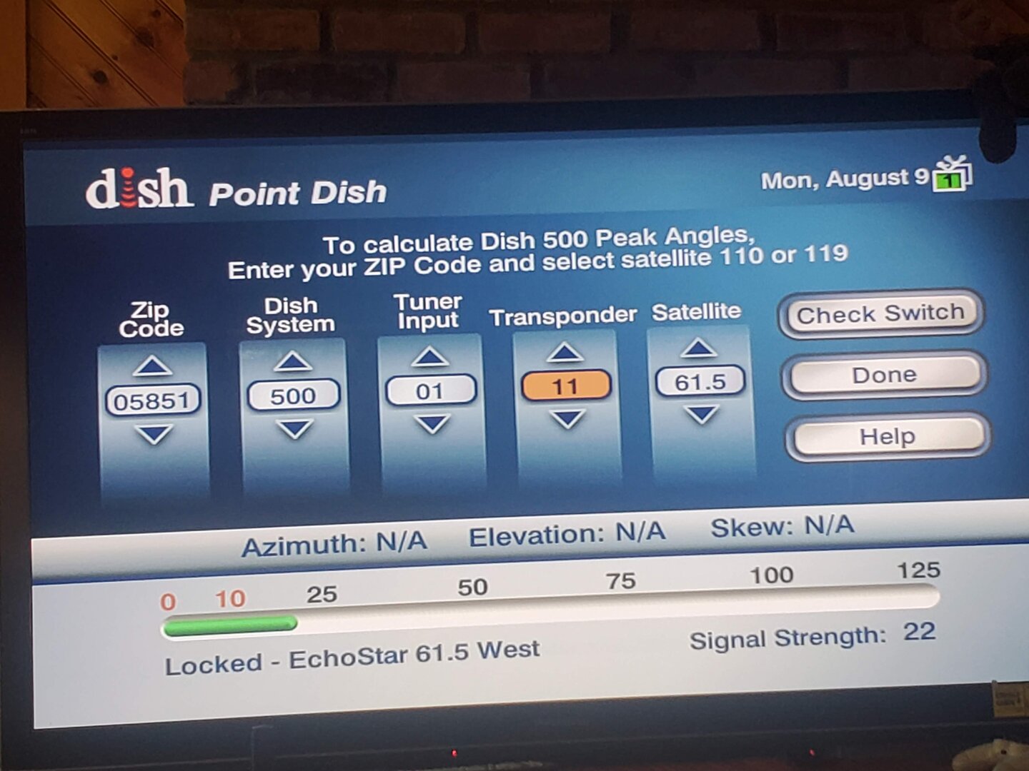

I'm thinking now I may have a LOS issue-but there are issues with that theory also.

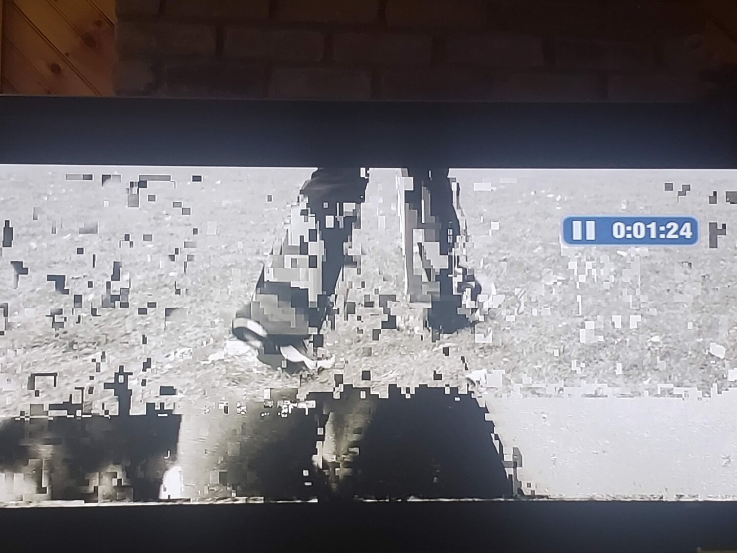

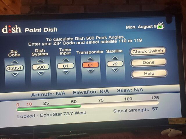

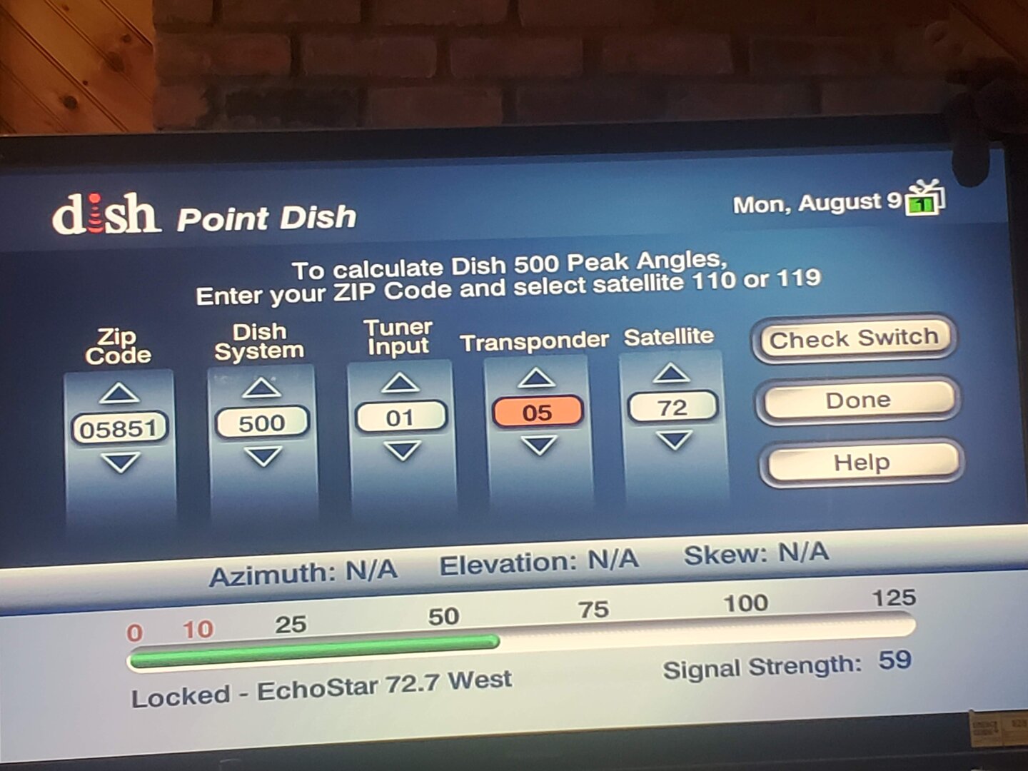

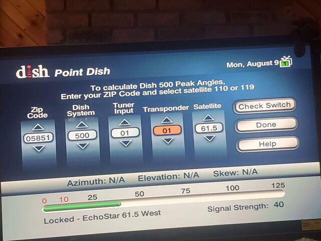

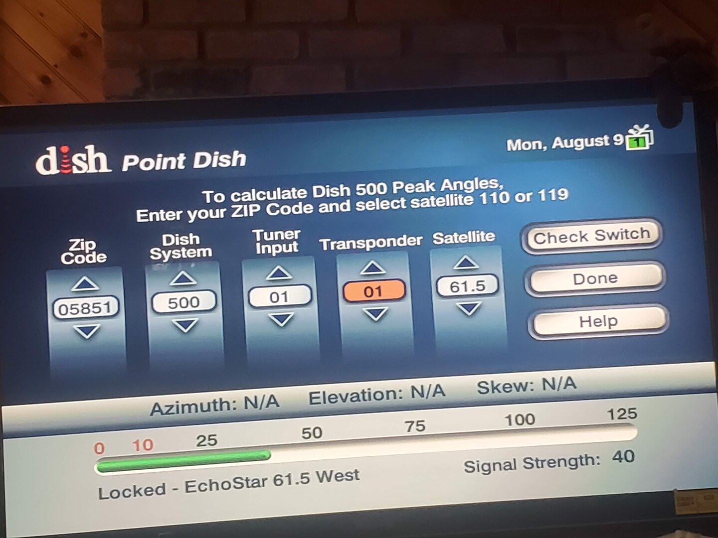

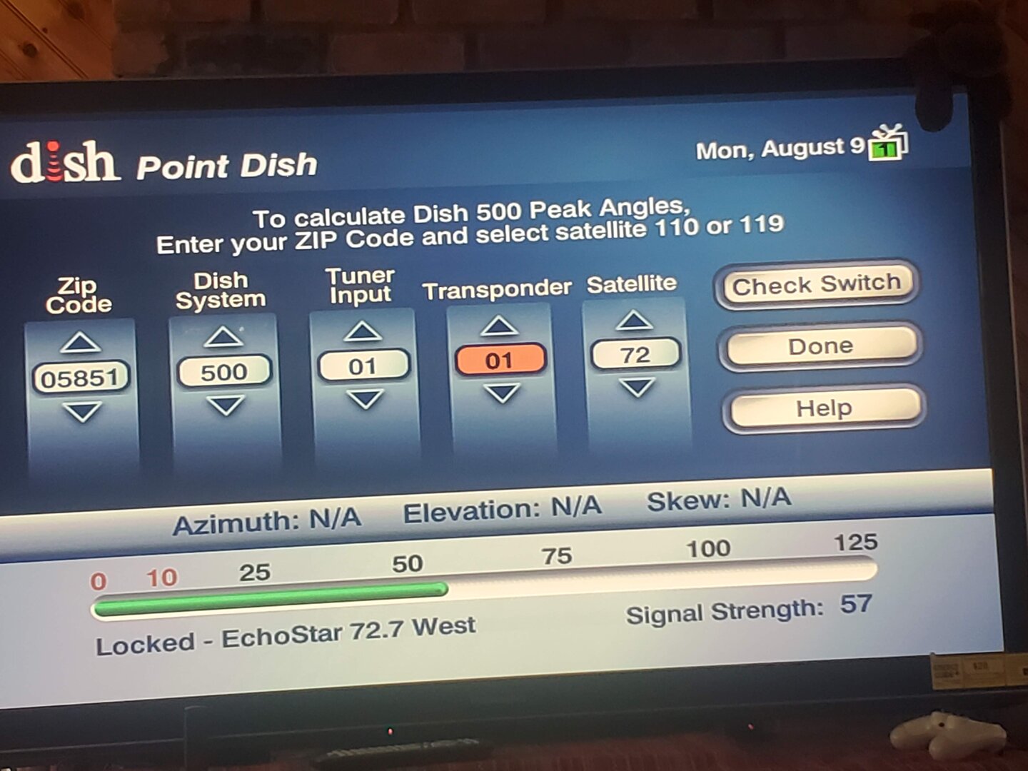

Here is a picture of what we get on an intermittent basis.Gets unwatchable with any rain.What took me a while to realize is the problem is only on 61.5

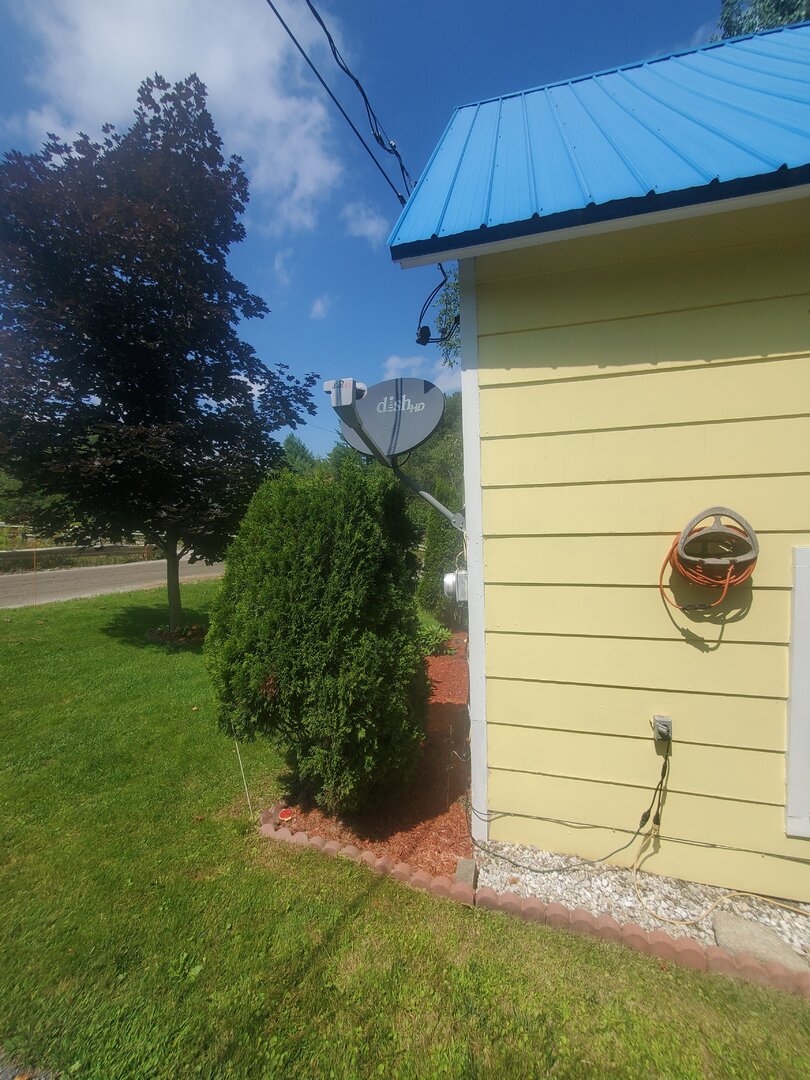

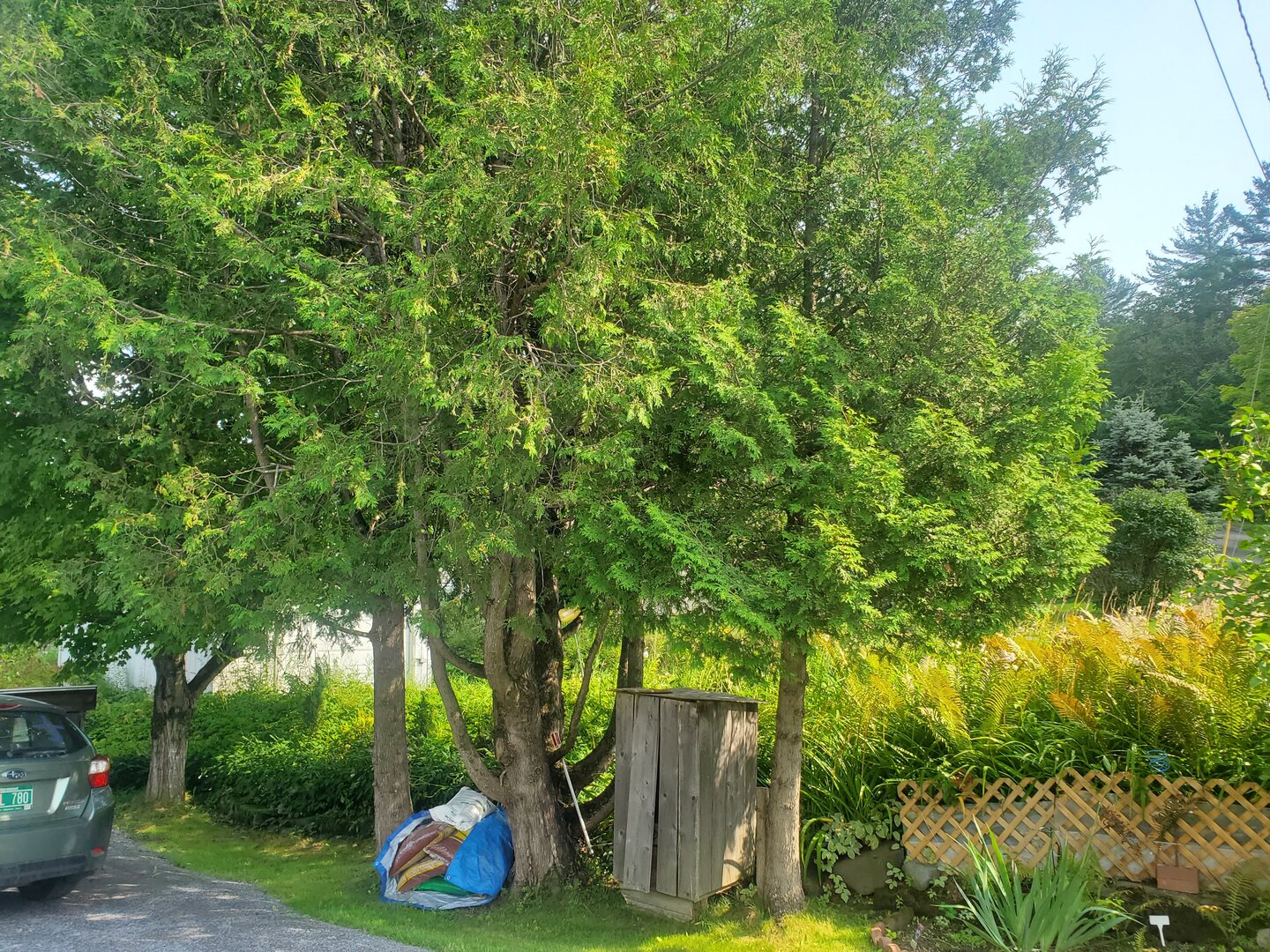

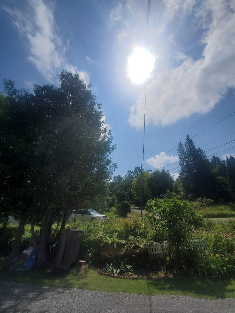

Years ago I had a similar issue.A dish tech recommended I take down an interfering cedar tree.It fixed the issue.This is what we saw after we took it down (but before next action.)The tree we took down was to the right .
Lastly Dish setup.It's a really convenient place as I can get snow off easy.I paid for dishpointer app but obviously I cant get next to dish.Plus how do I get it to take a picture of the satellite and sky?
Do LNB's sort of fail on just one satellite?Ok that's it for now.
