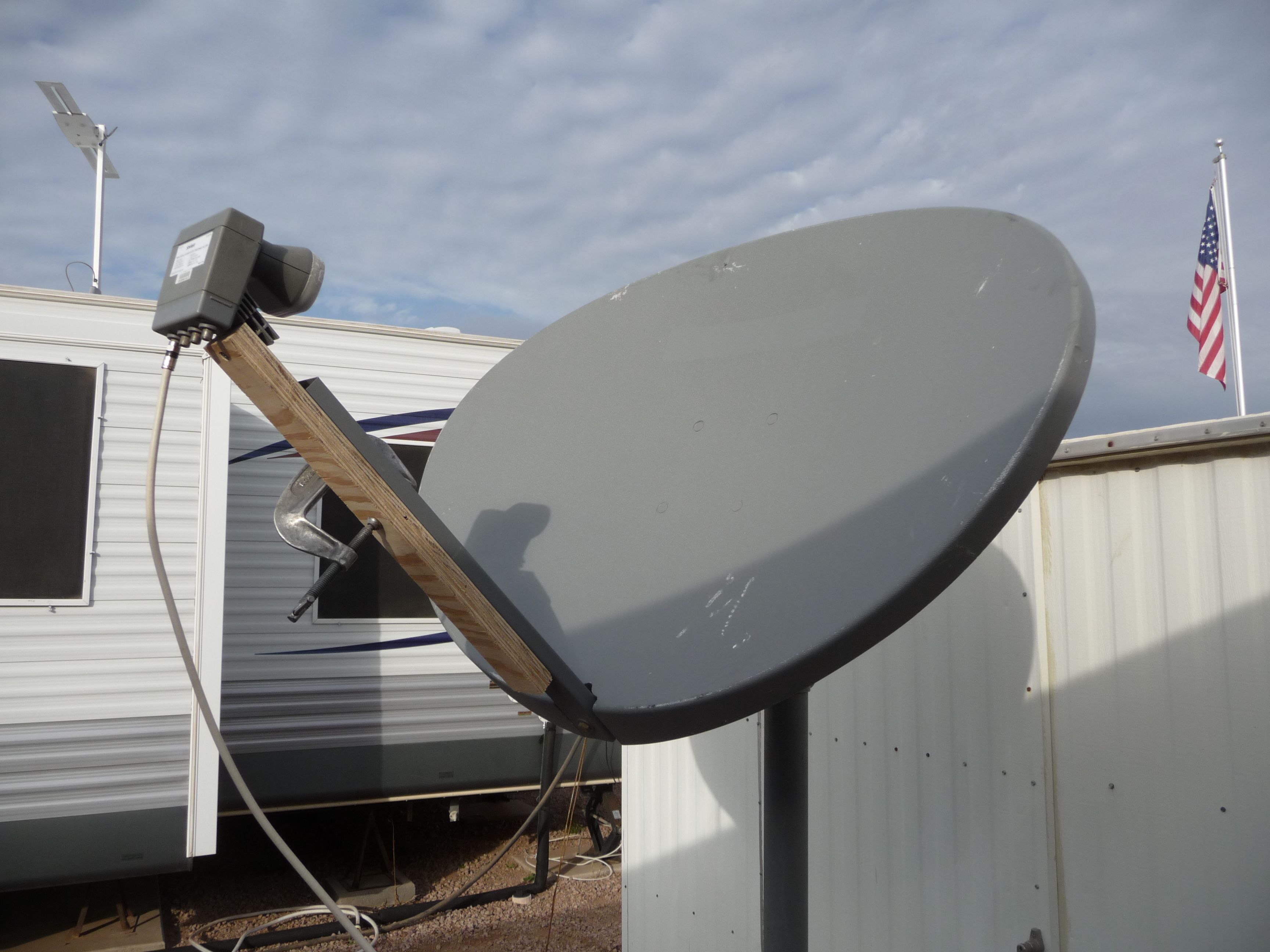

This is what I am working with. I added the wood to extend the arm trying to locate the sweet spot.

From your pic, it looks like the lnb is too far away and low.
