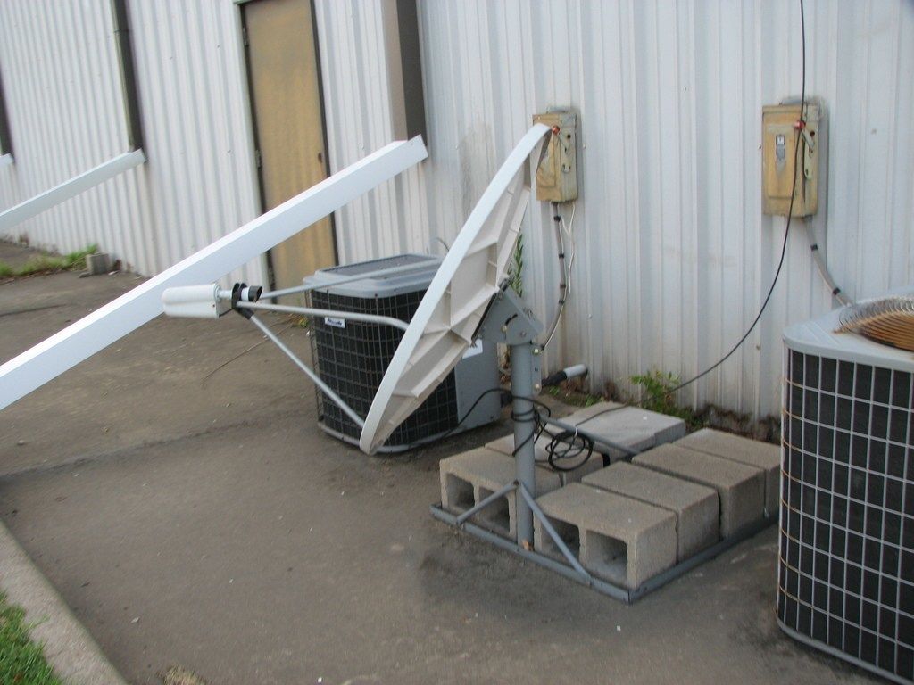

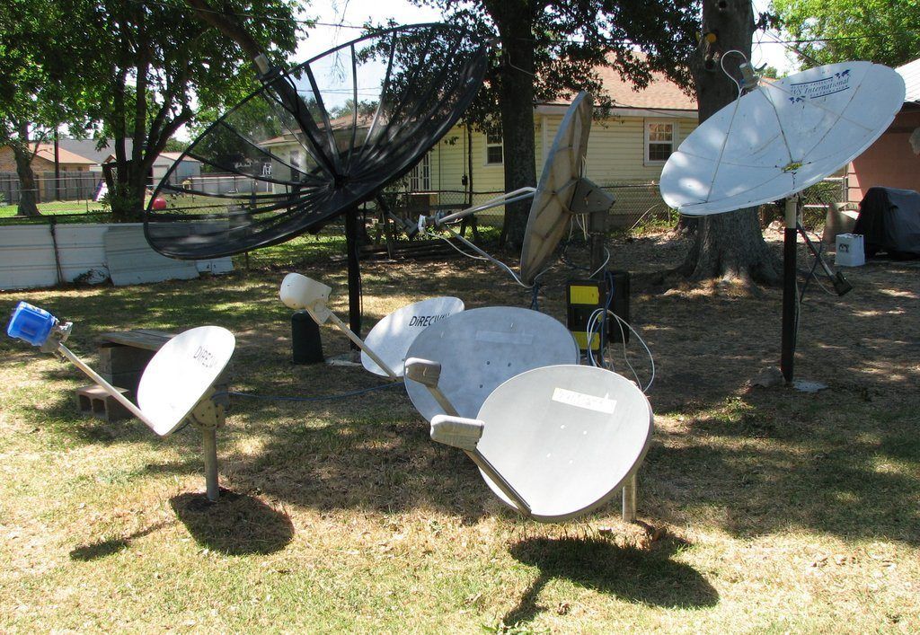

Rather than waste a lot of you guy's time with lots of stupid questions I did a lot of reading, a lot of guessing and a lot of finger crossing.
Well over a year ago I obtained a ku motor (thank you Dad!) and for all this time it languished in its box, gathering dust, never once used.
A few weeks ago I got a burr under my saddle and decided that by golly, I was going to make it work!

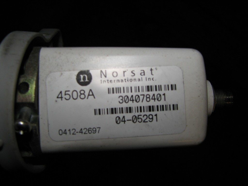

I sat and looked at it for weeks. The darn motor tube is larger than standard and NONE of my dishes are standard ku dishes such as the type sold for motor mounting. They are old Primestar and Directway dishes. I can thank my ex husband for scrounging them out of whatever trash piles he found them in, for whatever reason he wanted them. I'm just glad he left them behind.. :)
Anyway.. So the non-standard motor just would not mate up to the non-standard dishes I have. Grrrrrrr........
So I sat and looked at things, time and time again, trying to figure out some way, any way that I could put the motor onto ANY dish that I have here.

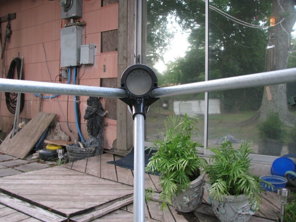

Then I took that digital measuring tool Dad gave me and went around the garage, house and yard measuring EVERYTHING.
I knew ALL the dishes I have fit on a fence post, like for gates and corners. I think they are about 2 1/2" around, more or less. The motor tube was too small for that but not by much.

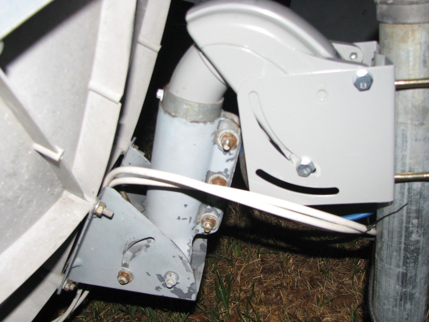

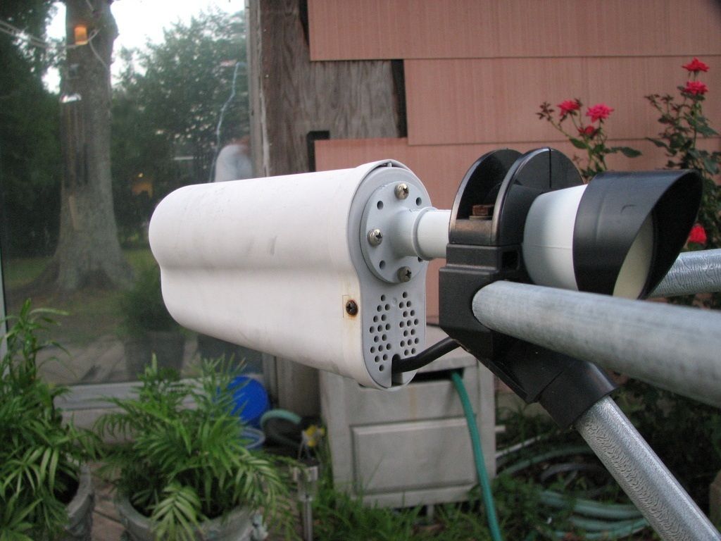

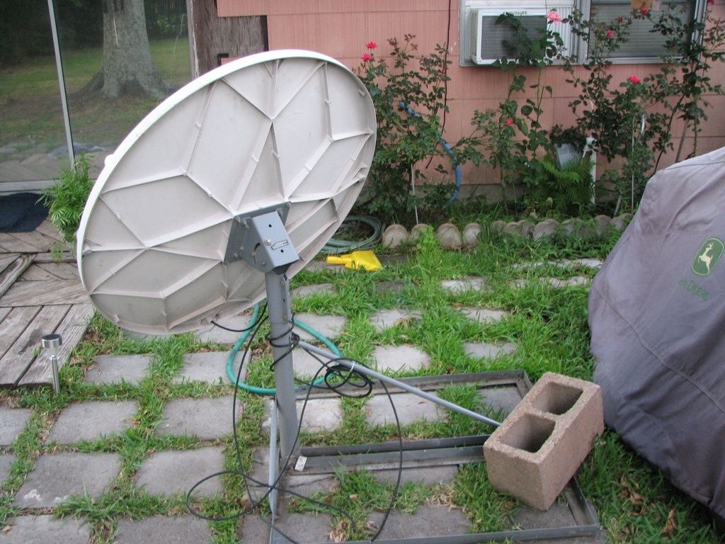

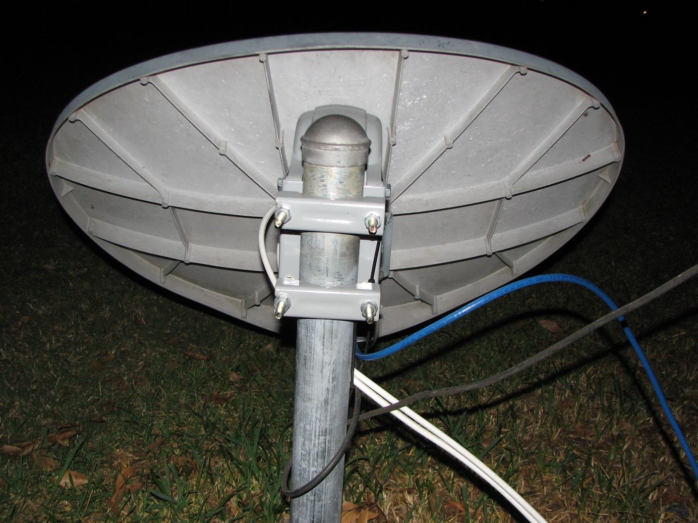

One of the things that was a problem was that at the bottom of the motor tube there was this large lip all around that was far too large to fit into anything. Not cool..
So I decided that had to go. I took a hacksaw and sawed that flippin lip off!

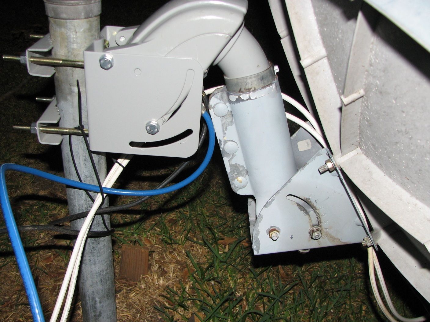

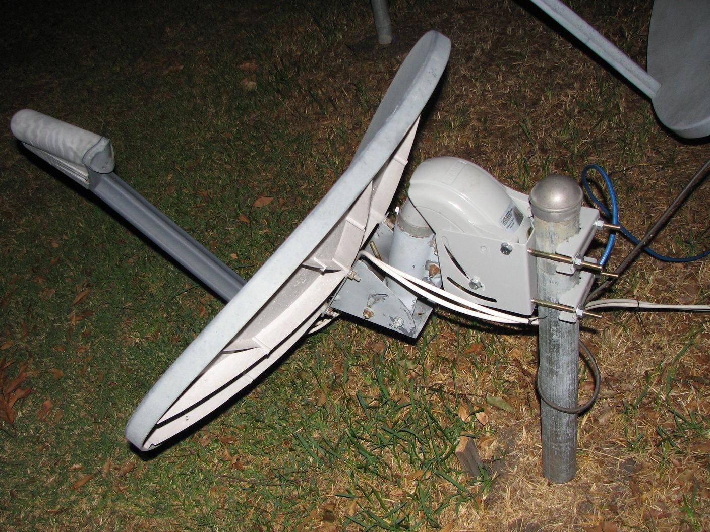

Then back to measuring everything again. I was sitting on the deck and looked over at a pile of fence tubes I had sawn up for making wind chimes (I make gianormously wicked wind chimes for a hobby) and picked up a short piece and looked at it. Hmmm.. No way I thought.. So I had the motor sitting there and the piece of tube in hand and one of the little Primestar dishes sitting there and it dawned on me... I slipped the tube into the Primestar dish. It fit of course. Then I took it out and picked up the motor and slid it over the motor tube. It fit! Snugly at that! NO WAY!! This was it! This was my magic moment! I had my adapter! WOO HOO!!
The tube was even the right length! I didn't have to cut it any more, it was a left over and I was so happy that I could make use of it rather than it go to waste..
So I drilled a hole through the adapter and into the motor tube and put a screw through them both so that it can not spin, twist or slip off.
I spent a few days reading the manual trying to understand how to adjust the tipping stuff but it wasn't sinking in at all. Not to mention, the manual was assuming I was using a standard dish that was designed for motors. This one was not. I had taken it's pole mounting on the back and flipped it upside down as many had mentioned in threads here.

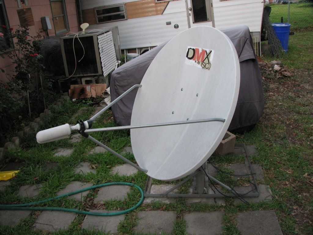

I took the motor and dish out to the pole and bolted the dish to the pole then I put the dish onto the motor. That's when I realized that I had the motor totally tilted waaaaaay wrong. Back inside for more reading... Finally it began to dawn on me so I went out and took it all apart and changed the tilt again. I ended up tilting the motor to my latitude or longitude, it's 30. I can not remember which is what that lat. long. stuff mixes me up 100% of the time. Anyway, which ever one it is, I set it to that on the motor tilt. The motor came from the factory set at zero.
One of the things I read here was that you should try to us a satellite as close to true south as possible for your alignments. Dishpointer.com tells me that Galaxy 3C at 95 is very close to true south for me. So I took my new little meter and found that satellite without operating the motor. All I did was turn the dish east and west then adjusted the tilt on the dish itself until I found the satellite. From there I tightened it down and called it good. The next day I went out and manually tried to get a better signal and stumbled upon the "wild feeds" on 91 Galaxy 17.
I hooked the lnb into my 8 way switch and left the motor disconnected. For a week or so I just played with it scanning each afternoon for news feeds, watching reports dig out wedgies and smoke cigarettes between takes. :D
So last night I decided it was time to try and get it right.
I took the wires off from the 8 way and removed it from the main system then hooked it to a spare wire and put it on the Coolsat 6000.
I went into the Coolsat setup screen and told it that I have a USALS motor. It asked for my location in long. and lat. I looked that up and entered it. Then I went to blind scan and told it to scan in the satellite 97 Galaxy 19. It turned on the motor and moved the dish. And nothing came in. At this point I was ~assuming~ everything. I was assuming that the system was intelligent and it knew where to move the dish to without me having to program it. Oh yeah?? Cool!
So I assumed that it had moved the dish to point at 97 but that I didn't have it on the pole the right way. I went out and put the dish on the little meter, loosened it up and turned it until I got a signal. I adjusted it back and forth and adjusted the dish tilt until I got as good a signal as I could. I took the meter off, put the wires back and went inside and started playing with the Coolsat. I scanned and found some channels. I moved to a new satellite and scanned and found channels there. I spent a few hours at it and my results were not exactly great. But I kept at it and went back outside and tried adjusting a few more times until about 5am I hit gold and was finding all the channels on all the satellites. :D
So now I have a fully operational ku motor. But, it's on the Coolsat and I don't want it there. I want it on the system with all the other dishes. That's where the real challenge will come in to place. I have no idea how I will make this increasingly complicated system all play nice..

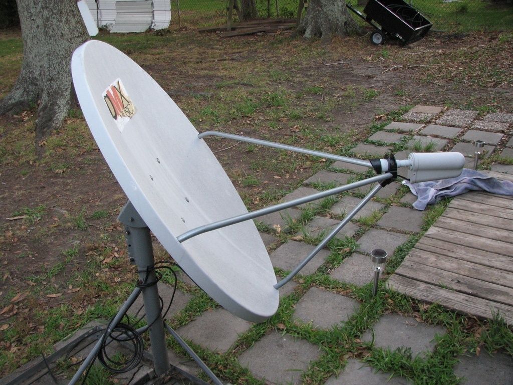

Oh, and the little 6 foot dish. I found an OLD C-band tuner that turned up last year and I hooked the motor wires from that dish to that old tuner. The tuner itself is old and crummy and the remote is broken but it has two push buttons on the front. When you push them, even a tiny, brief punch, the dish moves a LOT. Pretty imprecise if you ask me. But I got lucky.
That 6 foot dish is on the 8 way switch for the PC so I changed channels to one of the LeSEA channels then used the buttons on that old tuner to bump the dish back and forth until I landed on the right satellite at 99 Galaxy 16. I got exceptionally lucky and with a few bumps I was able to get those channels in loud and clear. And that's where that dish will sit. No need to move it, it works really, really well right there. And on those channels they run some oldies I like, like Green Acres and such.. :) As Charlie would say, "WINNING!" :D
I also did some manual editing on transponders for 87 AMC 3 since the PC can't do blind scans and no other piece of equipment I have can tune in S2 channels. There is no way for me to blind scan S2 channels at all. So I ~must know~ where they are to begin with.
I did that and then rescanned 87 and I found a ton more S2 channels. Most of them are not listed either here on The List or on Lyngsat. The stuff on Lyngsat appears to be way out of date. Oh well..
So now I have like almost 75 S2 channels on 87. They are almost all RTV or TUFF but they seem to be small town low power stations around the country. And many of them run stuff different from the national schedule. And that is AWESOME! If I miss something I can usually find it hours later or find things that no longer run on the national feed! I love it!
The S2 channels are really touchy though so I need to get out there and fine tune the big dish but that's a low priority. I can usually compensate by bumping the dish around a little with the Gbox remote control. Over all the BIG 10 foot dish is working great and I'm getting lots of awesome channels on it!
And for ALL of this, I thank you guys. There is no way in the world I could have gotten any of this working without your knowledge and help. THANK YOU......
So my next step to completing my set up is taking the ku motorized dish and adding it into the pc system, somehow. The Coolsat is just a testing tool and I don't want to use it as it won't get audio on most channels, won't get HD, won't get S2 and you can't record at all with it or schedule channel changes. Eh... But it is a handy testing tool...
In the end I want ALL the dishes on the pc and the pc controlling them all. I'm close, I'm real close to getting that done. I just don't know how to do it. I don't know how to make the ku motor play nice with the 8 way switch and the Gbox too. I have a general idea of how it should work, I just don't know what I have to do to make it happen.
But I'll get it. I'll figure it out. I'll keep reading and I'll try not to be a pest and ask stupid questions and waste people's time. It takes me a looooong time to get things done but I'm learning..
P.S. in the pictures the pole and stuff looks crooked but it's not. I just tilted the camera because I was slapping mosquitoes when I trying to take pics.. :o

Nice work. I'm doing the same here . I mostly use the computer for satellite viewing. I'm curious Dee, what are you using on your PC, software/hardware? Maybe we can figure the switching scheme for your setup. I've been useing MyTheatre because it intergrates my ATSC tuner and allows some complicated switch setups.
Nice modification, Dee... Those Primestar AZ-EL mounts are rather heavy, but if its working, that's all that matters!
Having a motorized dish is very useful when you want to check out the skies...

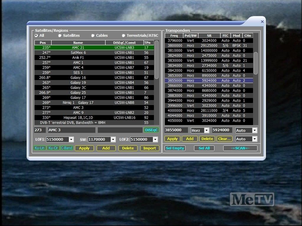

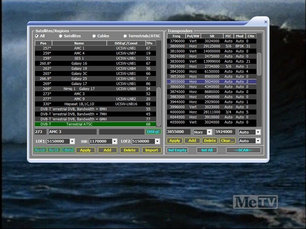

I know how to edit the satellite switch positions, they are all "uncomitted" 1-8. If I move a dish it's easy to change that.
I have the 6 foot cband on uncomitted 8 with no motor.
The big 10 foot dish is NOT on the discque switch at all
There is a encoder switch FIRST before anything. 22k on connects the 10 cband, 22k off connects to the 8 way switch for the other dishes.
Eventually I need to put the gbox in there so the pc can move the 10 foot dish. Right now I move it by the remote only.
I guess I need to make a little drawing, it's a crazy setup.
It took me a few years in all to get it to this point. I think it may be a little out of control now.

Dang I wish I could make pretty pictures like you do on those diagrams! Mine are always so crude..
Maybe I need to download a bunch of yours then cut-n-paste up pieces to make better diagrams for mine.
As for switches and stuff, I only have the one 8 way switch and 7 dishes total.
The 10 foot dish does not go through the 8 way switch at all.
So it's like this,
pc --> 22k switch --> 10' dish
The cable is not running through the Gbox yet. Just the wires for it's motor are hooked to the Gbox and I control it with it's remote control only. The pc doesn't talk to the Gbox yet.
The other half of the 22k switch (which I now see is called and Encoda, not an Encoder. DOH!) is hooked to the 8 way switch.
When the 22k is turned on I get the big Cband. When it's off, I get the 8 way switch. So if I select Galaxy 19 ku the pc turns off the Encoda and sends a signal to the 8 way switch to connect the dish on uncommitted 4 and I watch that satellite.
When I select MeTV the pc turns on the 22k switch and connects to the 10' C-band dish and disconnects the 8 way switch.
If that makes any sense. I made print screens of the settings to illustrate, if that would help any.
Also note that there are a bunch of satellites that show uncommitted switch 1. Those are temporary satellites from when I was moving the first 6 foot dish manually and searching for anything I could find. I have that dish connected to that port on the 8 way switch and I move the dish manually via a "dumb" separate motor controller that is not connected to the pc in any way. Now that I'm parking the dish on 99west I am not concerned with it being motor controlled for the immediate future. It can sit on the 8 way switch as a dumb, immobile dish like the small ku dishes do.
I also changed the Cuban satellite to show uncommitted 16 which is just a place holder, there is nothing above position 8. I just set that there because I took the dish down but I want to go back to it in the winter.
What I think I have to do is put things as such,
pc --> ku motor --> 8 way --> LNB's galore.
It's going to be more complex than that in the end, which I will illustrate later but that's the basic way I believe it needs to be wired.
But where I have a complete level 7 melt down is making the pc understand all this convoluted nuttiness and play nice with everything.
I want the dishes that don't move, to stay as they are on the switch.
So to watch a satellite at 91 west ku, which would be on the motorized dish, the pc would have to turn off the 22k switch first and pass through the off side of it same as if it were selecting one of the other ku dishes, then send a signal to the motor to move the dish. The 8 way switch would be connected to the LNB port on the motor. And ALL the LNB's (except the 10 foot) are connected to that. So it also has to send a signal not only to move the motor, it also has to send a signal to the 8 way to select the LNB for that dish.
This is were I feel like a dog chasing it's tail, getting dizzy and falling down. And puking... Ugh..
I'm hoping that this is possible. I've wanted to do this for a loooong time and gone really slooooow at it. That's my speed, slow... As I've said before, most of this is over my head so I usually mimic things I've seen you guys do and hope for the best. Most of the time it works. Eventually. I wish I was smart enough to understand what I'm doing. I'll never be as smart as you guys so all I can do is try to copycat what I read/see here or bumble my way through on my own at a pace 100 times slower than anyone else. I mean really, it's taken me almost two years to get this much done, starting from zero with nothing, no understanding, no skills, no knowledge at all, just a bunch of old scrap dishes I was going to haul to the curb. I'm still not too much more skilled than I was two years ago. I'm just too hard headed to quit.
Well, I'll try to make a diagram using some of your nifty artwork in a little while and see what you guys think. I should be posting pics of Dad's new dish in a few hours too. I'll bet his new dish will be TOO BIG for what he needs and I'll need to confiscate it, er, swap it out for one of my smaller dishes.

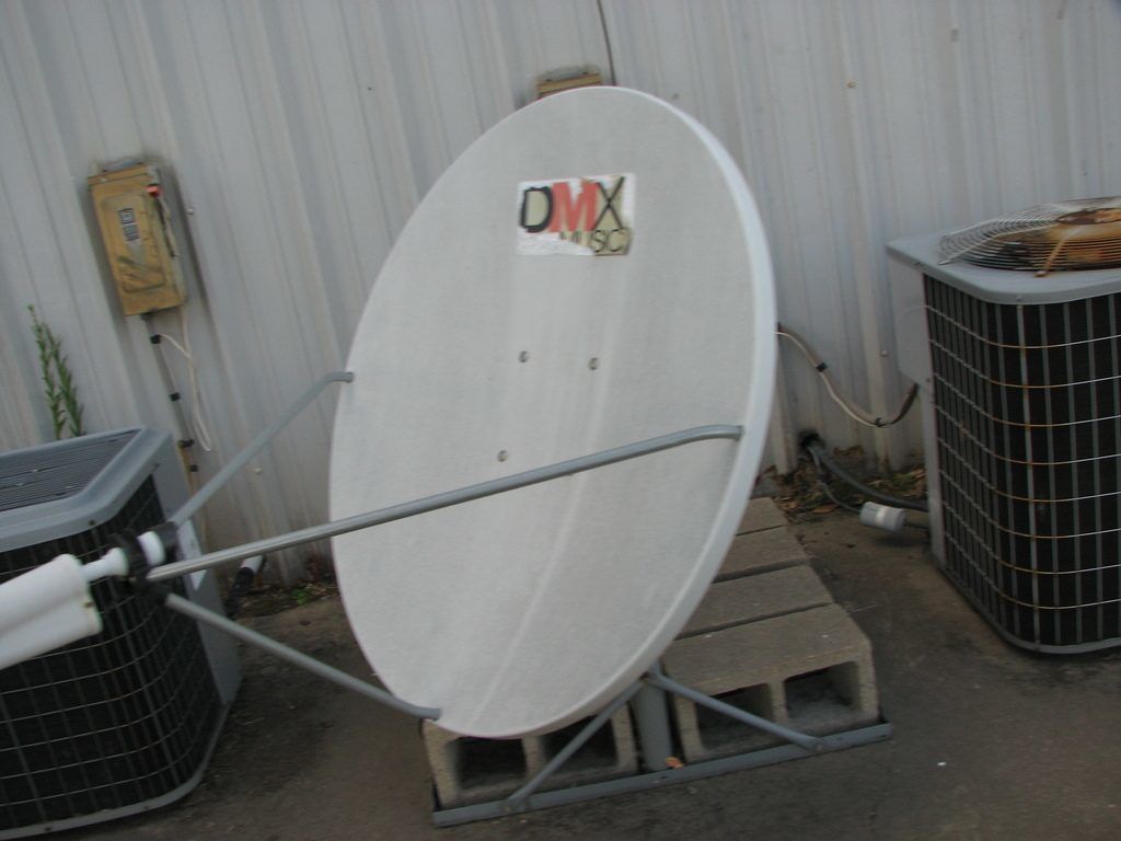

SCORE! :D
My dad picked a good one! He paid a 100 dollars for it. It's one of those Channel Master dishes, it's almost identical to the "Lawnchair Dish" I have, that I fixed with part of an old lawn chair.. They told my dad this dish was used for credit card transactions. I thought it was for music (the logo on it) but he says otherwise. I personally do not care.
The only difference is the mounting system fits a smaller, standard fence pole, unlike mine which sits on a much larger 3" pole.
But the size and weight of it makes it not so good for motorizing. If we were to flip the mount on it like I did on the small Primestar, the weight would put too much leverage on the motor and burn it out. This was an issue that we discussed last year when I first tried to motorize my version of this same dish. It was the general consensus that it would be inadvisable to mount this dish to a motor using the stock mounts and that without a LOT of serious modification, it just was too much trouble.
So. Let's make a deal! :deal:
I traded my 1 meter Primestar and my motor to my dad for his dish.
I think the one I have on the motor now is like a 3/4 meter dish, a Channelmaster 75E. I'm giving him the larger one meter dish, a Primestar/Channelmaster 1x.7-1 (that's what it says on the back..
I'm going to take my motor down since it's already modified and put the bigger of the two primestar dishes on it and keep his new Channelmaster in exchange. Now he won't have to buy a motor, just some wires and a tuner. He'll have to plant the pole though I'll go over with my iPhone and find the best place to plant it so he can get the most satellites, namely PBS 125 and RTV 83. If he can hit those two, it's all good..
I have to put it all together though and make it work. That's also part of the deal. Monday or Tuesday we are going to order wire and the Openbox S9 for him and I figure it will be sometime early in July when I get to go make it all work.
Now that I've beat my brains out figuring it all out here, it should go smoother and quicker over there. Thank goodness for that, I won't have to be over there all day every day for weeks. I figure one day to see about the pole, back the next day to install it and one more day after that teaching them how to use it. They are in their 70's so this will be fun. :rolleyes:
The dish I've acquired, I need to plant a new pole for it because it's bigger and will need a stronger, taller pole and more clearance from the other dishes.
I'll eventually replace my ku motor in the next few months but it's a low priority for now. I don't HAVE to have it but it would be cool to play with.
I guess this new dish will be my RTV dish for 83 AMC 9. I think.
Once again I get to play musical satellite dishes and move stuff all around again. Sigh...... It never ends!
Oh, and I do NOT like that cinder block stand at all. I will NOT be using it, I'll plant a pole in cement and save the temporary stand for like when I'm testing something and not ready to commit it to cement just yet. It will just be another tool in my kit of goodies for working on these things..
I think when I redo a ku motorized dish, I want to make one that can get both standard ku and pizza ku. Like, just in case for those rare times when something goes in the clear.
You see what you guys have done to me! You've turned me into a nerd! ;) (Acutally I blame unemployment and boredom primarily but I'll give you guys half credit)

A totally stock Andrew / Channel Master / Primestar 1.0 meter dish is an excellent choice.
Looks like it's in new condition, too. - :up
So, you get that for your 75e and a motor, eh? ;)
If you don't have a use for that NPRM, maybe it'd be an easy way to set up at Dad's place?
Wouldn't have to pick a permanent spot; wouldn't have to dig a hole.
No, I don't mean "put it on the roof"!
I was thinking of locating on some paving stones out in the back yard.
Should hold a motorized 75e just fine.
Come to think of it, you could pre-build the whole thing at home, and debug it with his receiver.
Then, take the cement blocks off, lift the dish/motor/NPRM into the back of the van, and deliver it whole.
Set the thing in place, restore the cinder blocks, and re-aim the motor.
Just thinking out loud, but I like what I hear. - :up

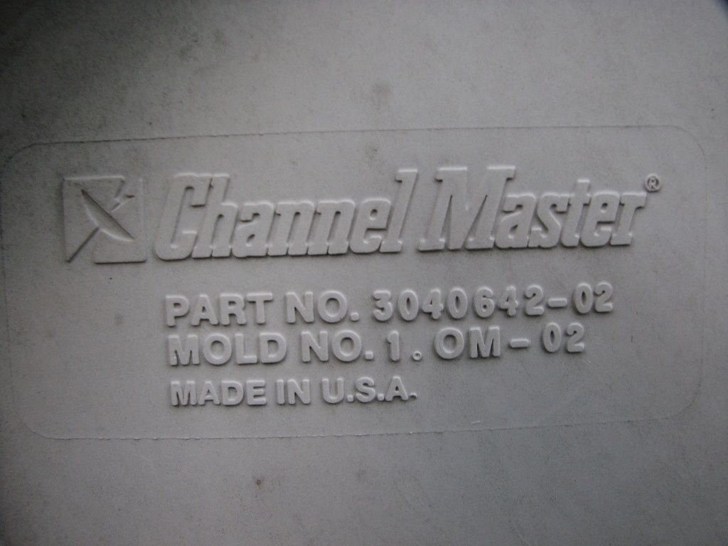

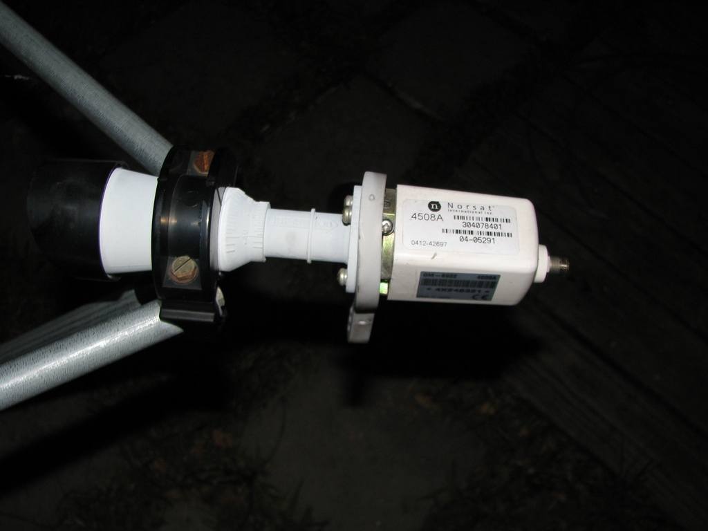

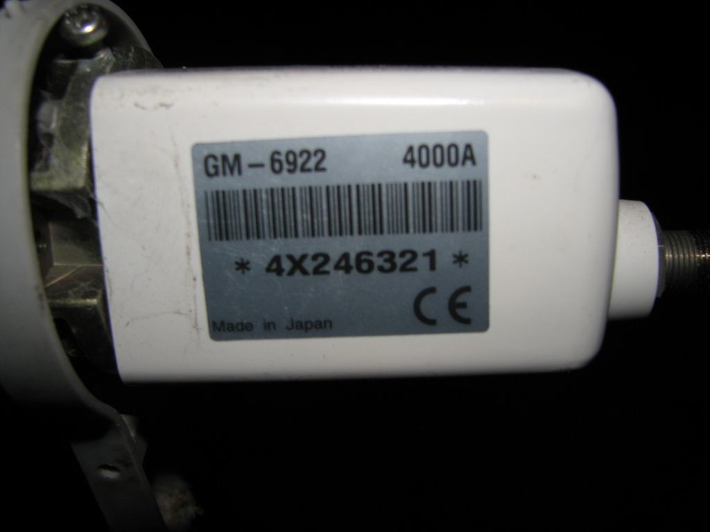

The other problem that I have is this new dish. The LNB is weird looking and I think it may be a transmitter LNB and not a receiver type. :(
I took the cover off and took some snap shots of it. I googled the numbers on it and I keep seeing "transmitter" showing up over and over..
Can anyone interpret this for me? I've never seen one of these before..
LNB Transmitter > LNB Ku-Band DRO Type GM-6932 GM-6938 GM-6922 GM-6941 GM-6933 - FUJITSU GENERAL
gm-6922 - Google Search
edit: Oh, and I found a "data sheet" on this LNB. It has some very technical information on it. Stuff I don't understand. Like, what does DRO mean? Is this the wrong thing for watching TV?
I played with it a little to see if I could get ~anything~ on it but I got nothing at all. It may be the trees though as I had it on my patio. I'll move it out to the middle of the yard tomorrow and try again..​
Thanks guys! :)

Looks like a standard single-polarity Ku LNB, with an LO of 10750
The problem is, it gets only one polarity: vertical or horizontal.
So, while it's good hardware, it's not something I see you using in the immediate future.
You might want one of these replacement soup-can-sized LNBs at Impakt Products.
Either the ones labeled Channel Master or the Eagle Aspen.
You can probably scrounge up a replacement, locally. Maybe from a broken dish?
Or maybe one of the bandstacked DishNetwork LNBFs (flat ones with a collar on the side where the feedhorn bolts up)
Oh, here's a more comprehensive discussion on the LNBs.
There's even a link to a picture I posted, showing what they all look like.
