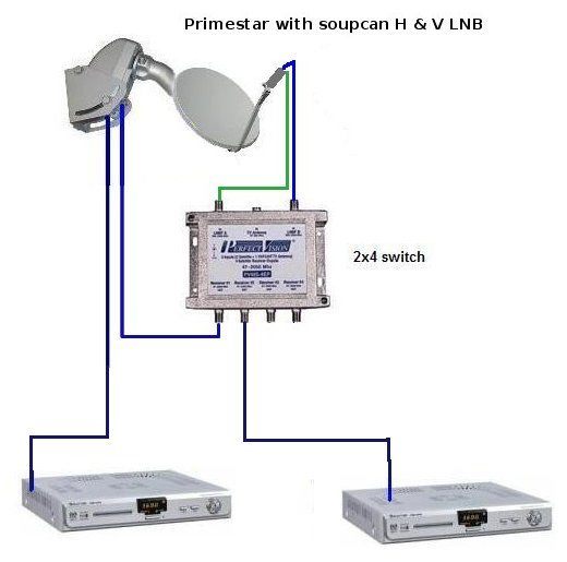

On the ku motorized dish for my folks, I am fixing them up with my Primestar 1m elliptical dish.
It has the old soupcan LNB with separate H & V outputs and has to have a combiner switch to put them to a single wire.
Right now it is on a Perfect Vision 2x4 combiner. There are two wires from the LNB, one for H and one for V that go to the combiner. From there one wire goes into my 8way switch and the dish acts the same as any other normal dish/LNB.
My dad asked if there was a way where they could have two tuners on one dish.
I told him I think you can do that but I don't know how and would have to ask.
I know you can't watch two separate satellites at the same time. But what if, for instance, they are on 125 with all the PBS channels?
As far as I can tell, most of the PBS channels are on the vertical.
What I'm worried about is burning out a tuner. Like when you tell the tuner to move the dish, will it blast power into the other tuner and burn it up?
Is there a way to safely put two tuners on one dish where either tuner can move the dish and they (my folks) watch them at the same time?
Or is this simply not possible at all and they will end up having to have two separate, independent dish/motor/tuner systems?
(I stole a picture from here that Anole made and modified it a little.)

If you are using the 2x4 Perfect Vision switch shown in your picture, then the four outputs can go to four receivers.
Or to say it another way, the three spare outputs in your picture can feed three more receivers, none of which can control the motor.
The receivers just supply 13 or 18 volts (which selects between Vertical or Horizontal polarity) to run the LNBF.
The motor moves when it gets a diseqc command on the line.
So, there is nothing to overload or burn out.
But you do NOT hook the LNB inputs of two receivers together - each is a power source, and that'll cause you problems.

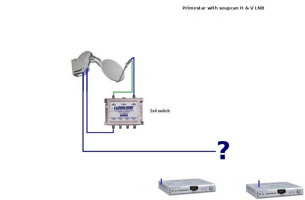

As I suspected from reading and googling, you can't hook two tuners at one to something without a gadget between them to keep one from frying the other.
So, then I am going to assume the following from what you've said.
Two tuners. One upstairs, one downstairs.
Downstairs tuner connects to #1 on the PV 3x4 switch and has USALS control of the motor.
Upstairs tuner connects to #2 on the PV 3x4 switch and is configured for NO MOTOR.
Each and every satellite in it would be treated as one big satellite with lots and lots and lots of transponders. Upstairs tuner can watch any channel that is on whatever statellite downstairs tuner has moved to, right?
You've got it. And there are various gadgets depending on the specific application.
Use the right one at the right time, and it's smooth as butter. - :up
...through the motor, just as your modified picture shows.
No, I would configure both receivers identically.
Look for a way to export that satellite list (maybe edit it; a feature you have already discovered is handy), then load it to the #2 receiver.
Keep a backup copy for later, too. :up
If the #2 receiver doesn't actually connect to the motor, then it won't command the motor, and that's fine.
If you ever want to swap receivers for troubleshooting, you're good, 'cause they're configured identically.
If/when you install a #2 dish & motor for the #2 receiver, there are no extra steps. - :up
Yes. And that can be Vertical or Horizontal, without concern.
