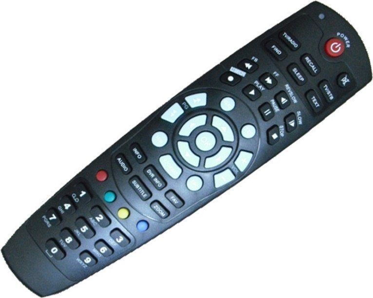

I grabbed pictures from the tuner we bought and a close up of the remote control that comes with it.

I read something about that if you press the format button the screen goes black and it's very hard to get it back to normal. Why in the world would they put something like that in there?
Knowing my folks, they WILL find and hit that button by accident. I think that the newer remote has that button removed or offset or something. I think it just needs to be GONE if it's such a bad thing. I mean really, why is it there at all? Sheesh.....

The format button changes the video output resolution/framerate of the receiver (480i, 720p, 1080i). Problem is, there are several foreign resolution/framerate settings which North American monitors won't display. When it hits one of those settings, the screen goes blank, and you can't see what you're doing.
Definitely should NOT be a button, as its a feature that really should only be set once and forgotten about.

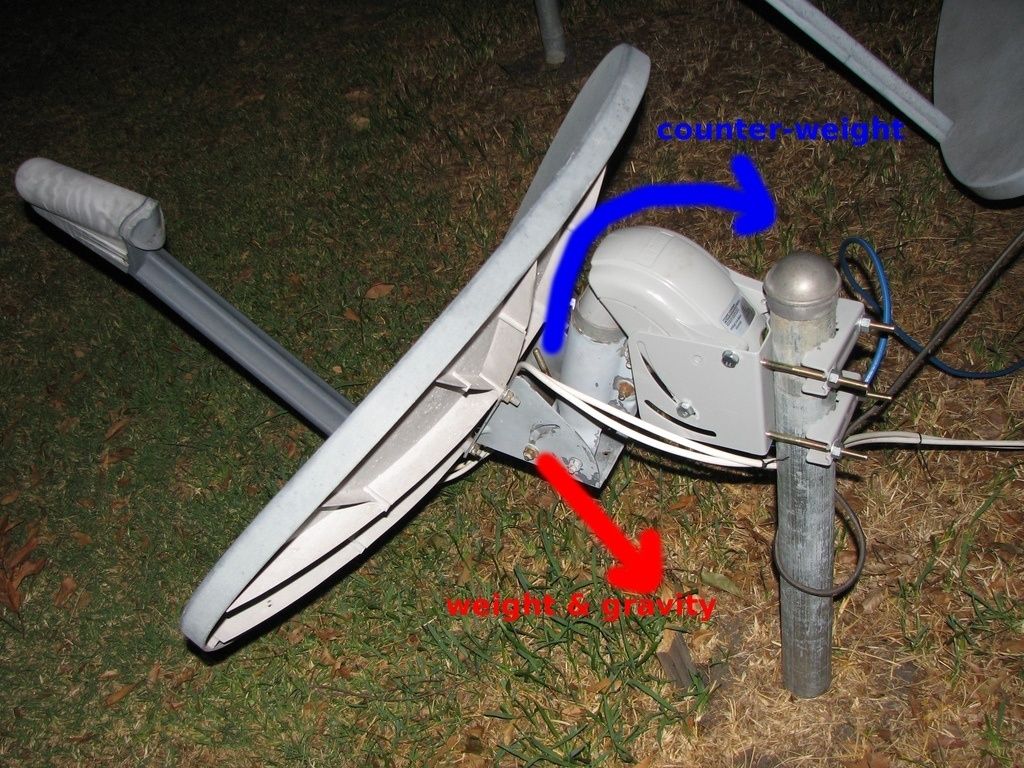

I just realized that I can motorize that bigger dish! All I have to do is build a counter-balance weight that comes off of the motor tube, goes up, over and behind the motor to counter the pressure it puts on the motor tube. With the dish lower down the motor tube than the motor was designed for it would stress the motor and wear it out faster, right? I believe that has been discussed here before. But if you counter balance the dish so that the pressure on the motor tube isn't applied against the very end of the tube, it should essentially balance it out so that it's not acting like it's pressing down on the very end of the tube or actually, worse than that, further down the tube because it's extended due to the upside down mount.
Right? Does this make sense?
I was thinking about mounting the new Primestar dish I got from my dad onto a C-band motor and I was reading how you guys put weights to counter balance really big dishes so it doesn't strain the motors as much. I'm thinking this might work on the small scale too.
Am I onto something here? Or am I just nuts?

As was already mentioned, the format button (Where your DVD INFO button is now) would change the format of the output to different standards than what we need or use in the USA for our TVs, such as PAL vrs what we watch. This receiver will do that and more. I wasn't aware that a newer remote was even available. It looks like that old Format button is gone, so that's good news.

Well, I don't have any idea what thrust bearings are. But it sounds like my idea will give it at least a little partial relief.

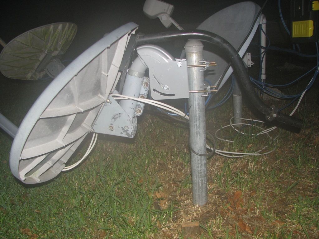

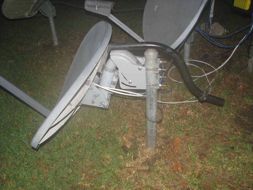

I was out poking around in the dark again and I found what looks like part of an old C-band lnb holder. I guess dumb dumb brought it here once upon a time.
Anyway, it's curved pretty much in the manner I have in mind.
Essentially, I am thinking that some sort of "arm" can be fashioned to attach to the dish then curve up, over and behind the motor to hold a counter weight, it would tip the dish up, so that all that weight isn't pressing against the end of the motor tube. If that makes any sense.
Now this thing I found is not shaped right and doesn't have any way to attach it to the dish properly but the basic shape is about what I have in mind.
I think it wouldn't be hard to find a piece of metal that I can bend and attach to the dish to do what I want. It doesn't have to be pretty or fancy, just effective.
I'm going to show this idea to my dad and see what he thinks too.

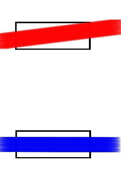

I made a really, really bad drawing of what I think happens with that dish mounted way low like it is with that upside down mount and then what I think it would do with the counter weight in place. Be prepared to laugh. I am not an artist.
Thanks! :)
Anything that adds mass - adds stress starting and stopping + the lack of thrust bearings already mentioned, could wear your motor faster or make accuracy suffer.
When you open a hatchback, what happens? a device lifts with you.
I have toyed with that concept myself as i have a 40 x 43 i may motorize :)I have not tried it yet.
Never stop thinking and being creative!
read up on what others have done

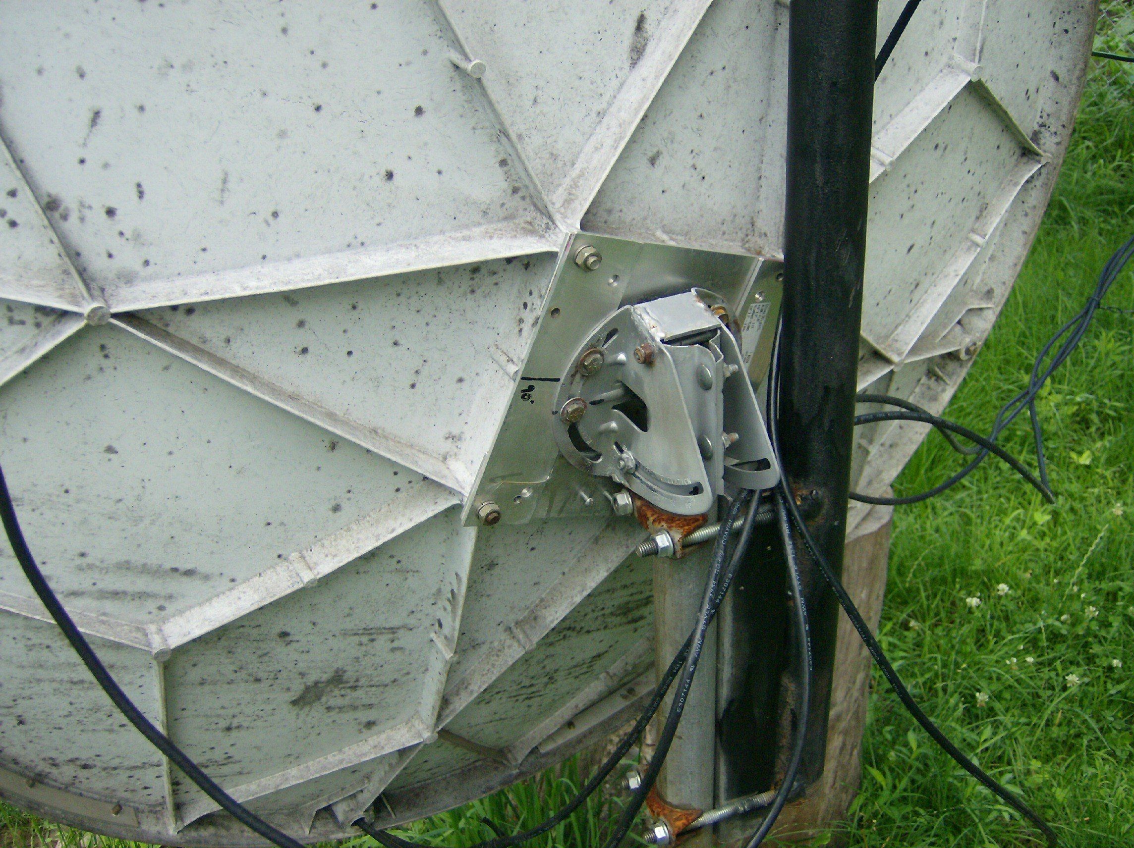

In the old threads about putting big Primestar dishes on anemic little sg2100 motors, the best solution was to lighten the "dish" as much as possible.
What that usually entailed, was building some light weight replacement for the bracket/mount on the back of the dish.
Users often commented on saving several pounds. - :up
Here is some good reading material for when you just can't get to sleep. - ;)
Primestar dish on an SG2100 motor:
http://www.satelliteguys.us/free-air-fta-discussion/23072-primestar-dish-sg2100.html
DirtyShame pix of motorized Primestar mount:
Primestar Dish on SG2100 ?
Lak7 shows Bob Jones University dish & elevation adjuster rod:
http://www.satelliteguys.us/c-band-...tures-dish-hunting-2008-a-14.html#post1495561

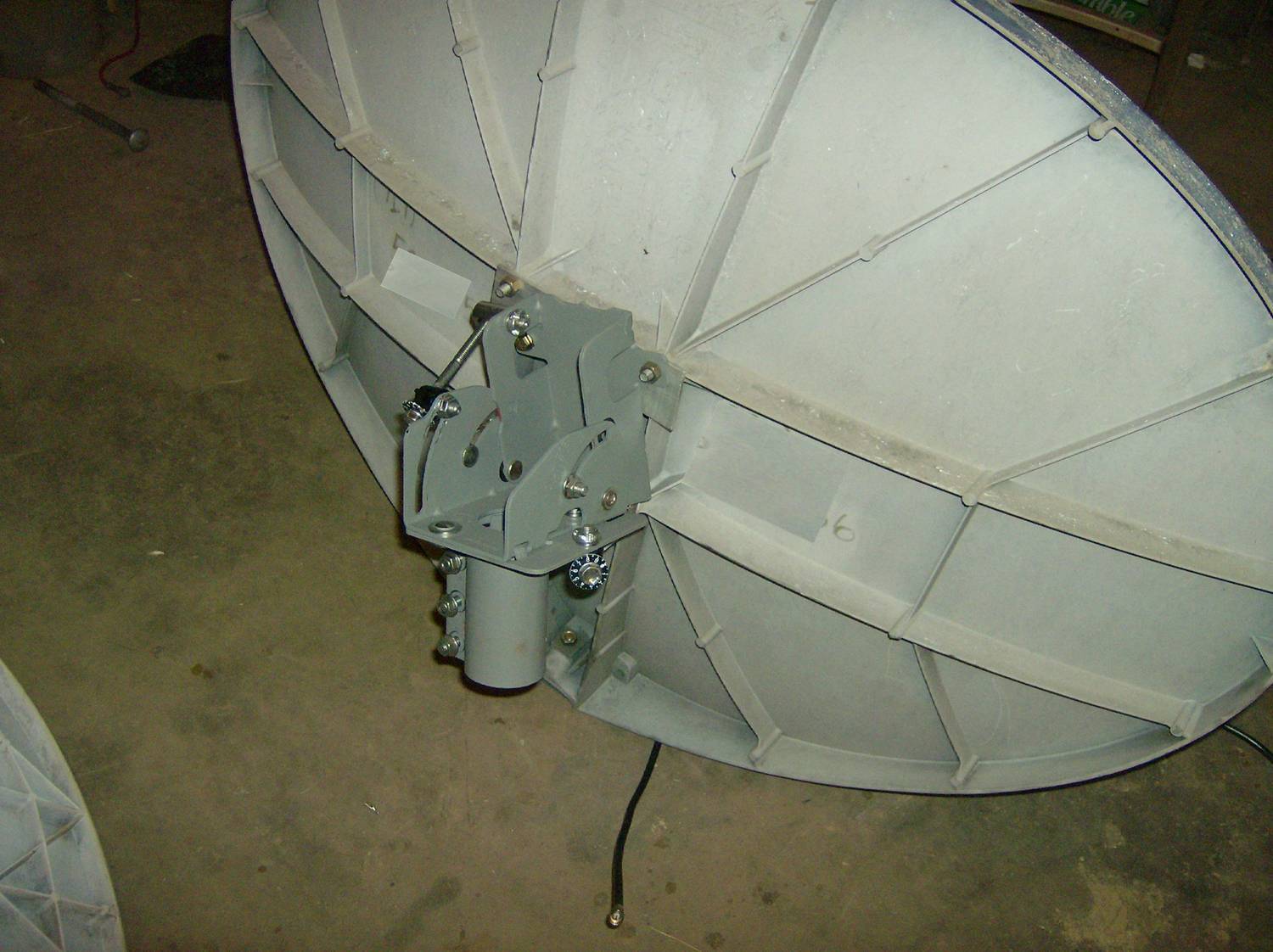

i do and then create.
Heh, I do read!
I even change a few things i see.
I love those direct mounts, great for tweaking.

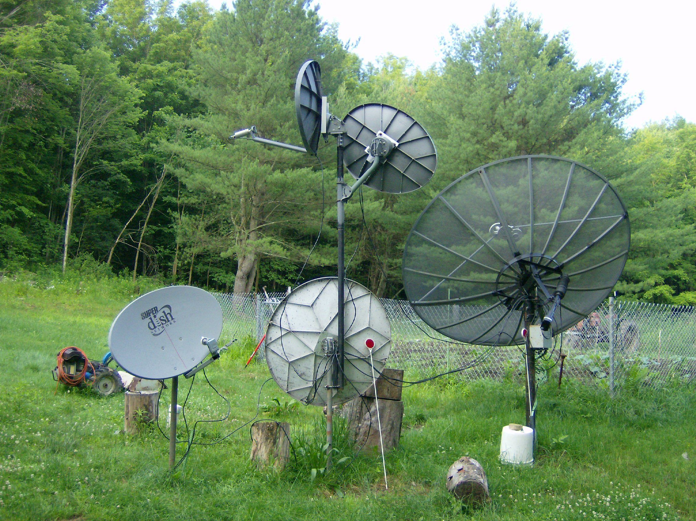

This is my temp setup, it all needs to go to the backyard when i finish it.
Even the bud is mounted in a plastic insert that is greased with a point of contact for a large setscrew to hold it down
and keep it from rotating.
it has external- outside rebar to hold it from turning also. this is so i can yank it out with my loader later.
the super is on my test pole, i do my playing with that location.
