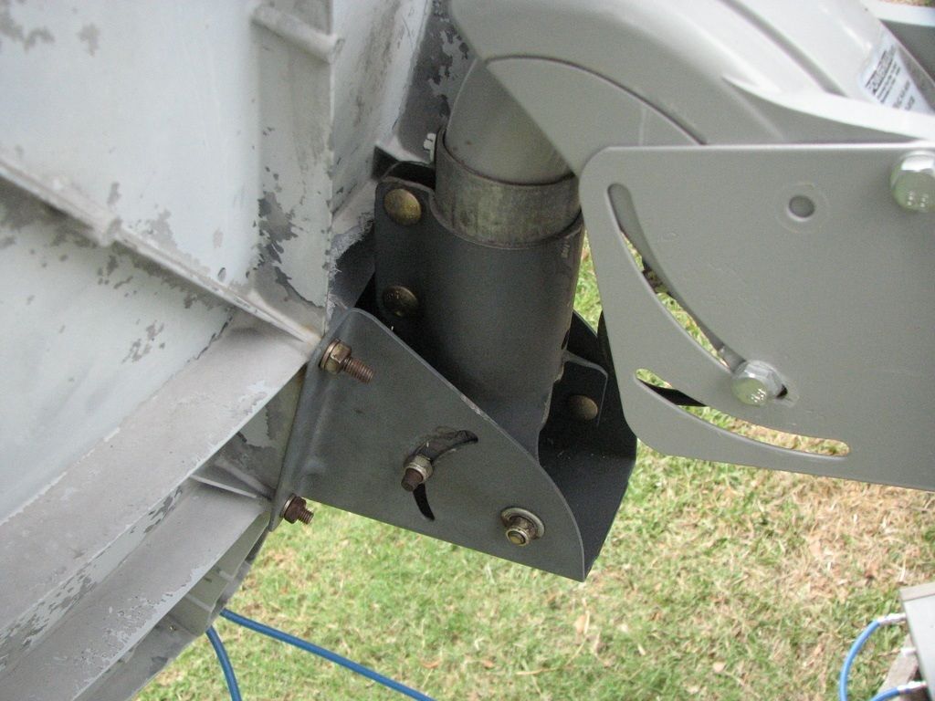

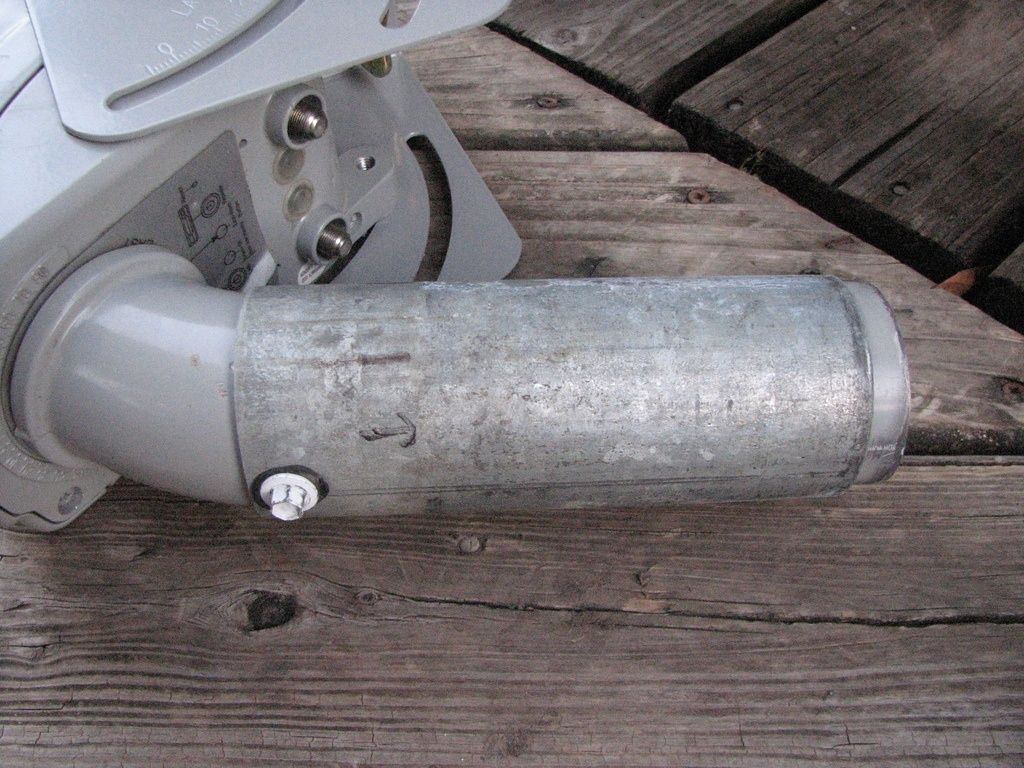

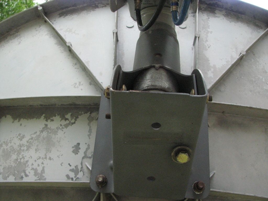

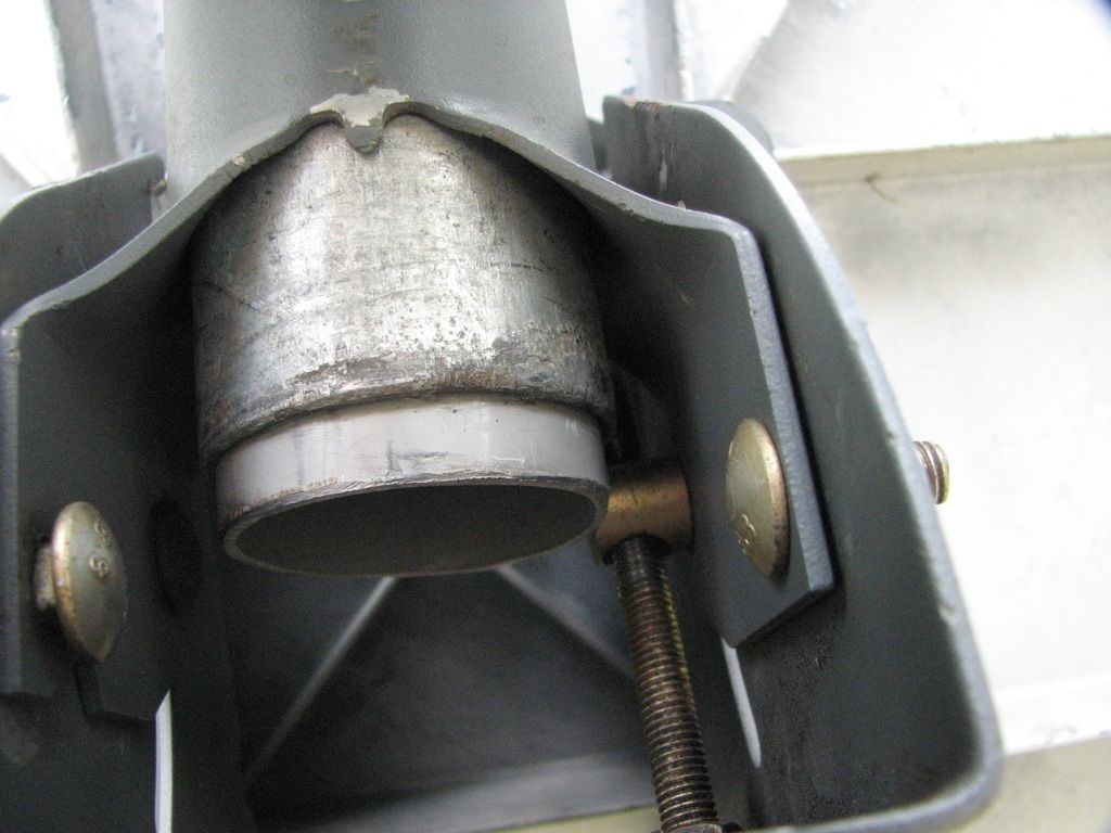

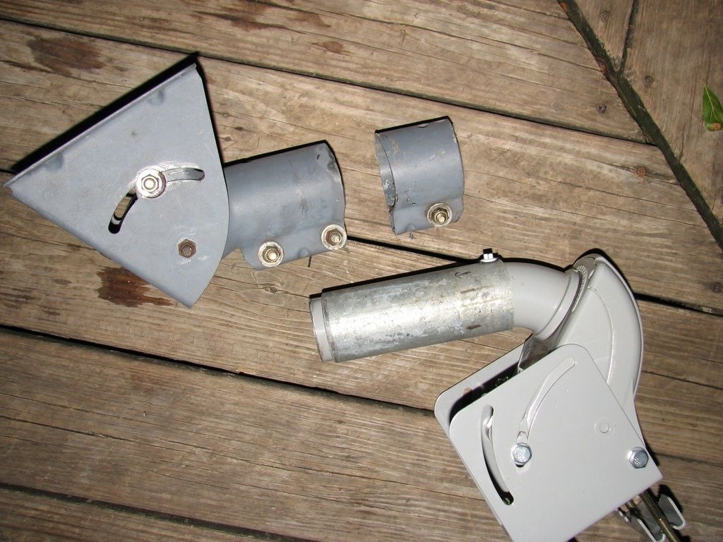

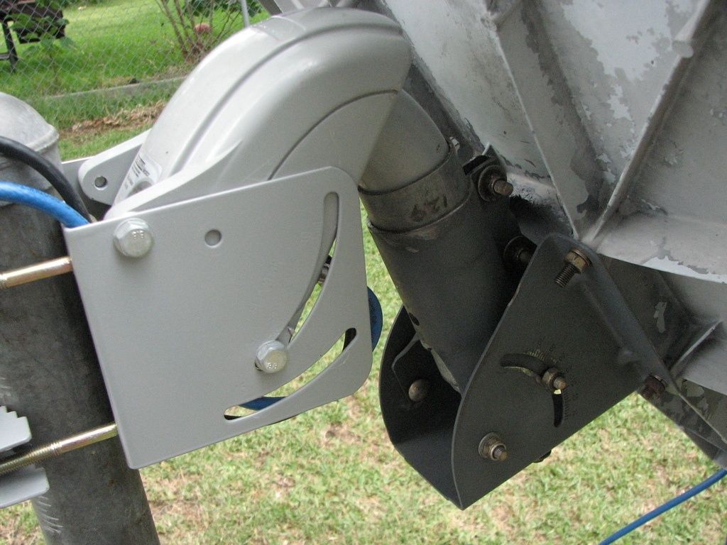

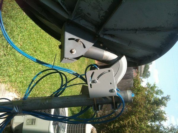

A few days ago Dad came by with some power tools and we (he with me supervising) made some modifications to the dish they are getting. He used a hand held band saw to cut part of the pole mount off of the dish. He also flipped the pole thing inside the main thing that the dish bolts to so that the bolts face the dish and not the motor because they were hitting the wires.
He ground out a notch so the adjustment bolt wouldn't hit the mount as you adjust it up and down. Doing these things allow me to move the dish higher up the motor tube. It is my hope that this will cause less strain on the motor. My dad agreed with me and he's an engineer so I think we'll be safe with this.
So Dad took his tools and went home. I mounted it on the pole the next day and I was able to find 95 with the Chinese channels, 97 and I found 89 I think, the one with the ABC stuff but that was about it. I would move it over towards the PBS satellite at 125 and nothing.. Arrrrrgh!

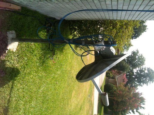

So, today I went out and took the whole thing down. I looked on dishpointer and figured out where to point the motor for true south. Right at the corner of a neighbors roof. I drew a line on top of the motor with a sharpie and squinted down the top of the line and aimed it at that house corner. Then I pushed the button on the motor to set it to zero and yanked the wire out because the flippin Openbox kept trying to point it back to a satellite! Once I had it set to dead zero I put the dish back on the motor tube and adjusted it so that it was perfectly square with the motor, IE pointing true south too then I tightened it up. I reconnected the wire and the tuner went right back to aiming it at the last satellite.
I go inside and check, it gets a few satellites better than it had then I aim it at PBS (which is the biggie) and some of the channels are coming in, some not so good. This is still an improvement though. So I take my little meter device out there, connect it and make some adjustments to the motor and the dish, I go back inside and find that it's now picking up all the PBS channels like a champ! Woo hoo!

Well, my folks are watching FTA satellite now and I am, motorless....

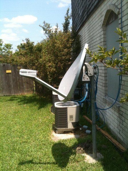

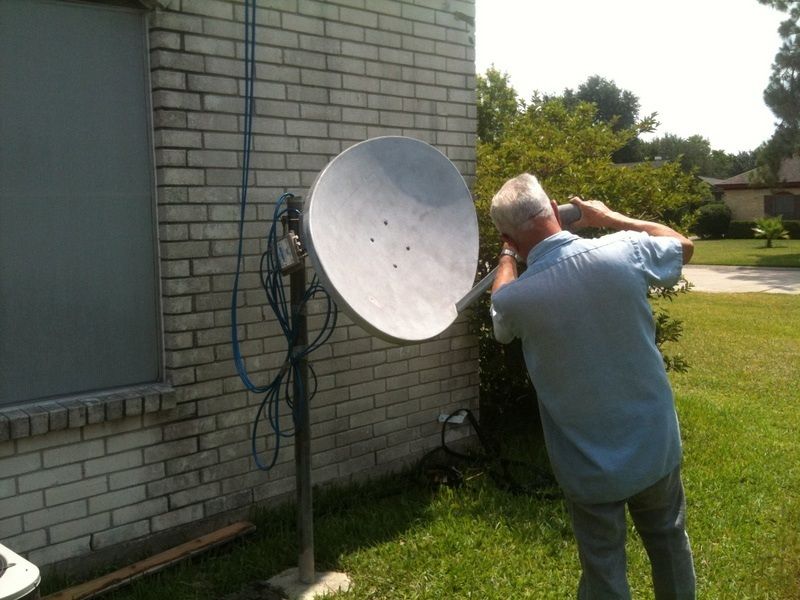

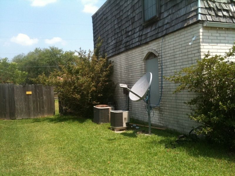

My dad picked me up early this morning along with the stuff and we went to their house.
First thing, before it got too hot, we put the dish up. I used my nifty little meter to fine tune the dish as best as I could, put ends on the wires, hooked it up and went inside, out of the heat.
I put ends on the wires inside, found the right wire (he ran a second wire as a spare/future expansion wire) and hooked it all up.
Bingo! Everything came in great! The HD video cable plugged right into the TV and the PBS HD channels looked awesome! My mom was thrilled to have PBS agian! :cheer2:
I checked all the satellites and they were all coming in really well. All across the sky, everything was working as it should be! :D
I was so relieved that it went so well, it actually went better at their house than what I was getting with it here. I couldn't have been happier!
After checking to make sure that everything was working right, I spent about three hours going through the channels with them, explaining the basics to them and instructing them on how to do things. Mom was sitting there like "Ok, ok, now give me the remote!" :clap
Dad glared at me when I handed the remote to her first.. :p
Both of them are excited and happy to have satellite now..
Oh yes, I almost forgot, when we went on family vacation a few months ago I took a few thousand pictures. Dad has been bugging me to put them on a DVD which I haven't been able to figure out how to do. I saw the Openbox has a feature for playing videos and photos from a USB disk. Ok, cool.. I copied the vacation photos folder from my pc onto the portable disk. I used the remote to pull up a slide show of the photos for them. They were soooo happy to have the photos to play on their TV and I was so happy that it solved my problem of not knowing how to make a slide show DVD. I love it!
So, it's all good now. They have satellite, in HD, it works great with their TV and they have the family vacation photos too. It couldn't have worked out better!
The dish is hidden from view behind the fence so my mom has no problem with it at all and she said that she may very well request a complete second system just like this one so that they can watch two different things upstairs and down stairs, to keep the peace...

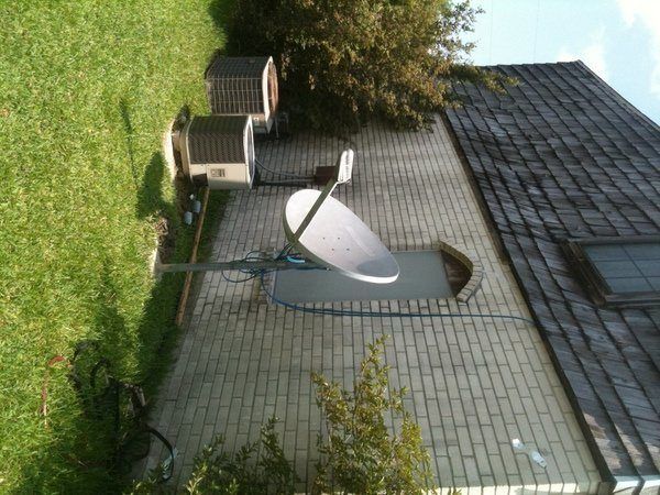

Looks great. - :up
Love that side-yard, or whatever you call it.
Great place for BUDs, should you go that way.
Only thing I can think of is maybe to shove your switch 'n cables up into an open-bottom rain-cover of some sort.
Cut-off 2 liter coke bottle, upside down?
That way, the rain won't flow down the cables to anywhere you don't want it to go. :)

I told my dad that he needs to go to Lowe's and get one of those $7 plastic tool boxes like I did and let me modify it for him like I did mine.
He said he'll go get one tomorrow and drop it off for me to fix it up. We should have him something fixed up before the weekend. Not much chance of rain lately so I'm not super concerned. The connectors all have plastic rain caps over them for now so that's better than nothing. He likes the tool box idea because it's cheap, waterproof and easy to get inside of if you need to..
Where their dish is, it's the southerly side of their house and Mom never goes on that side, just Dad for mowing. The fence hides it from the back yard (she putters around a lot in the back yard with her flowers).. She doesn't really find it all that ugly though, much to my amazement. I guess after she saw the crazy collection in my yard, it makes one little dish look pretty good. :D

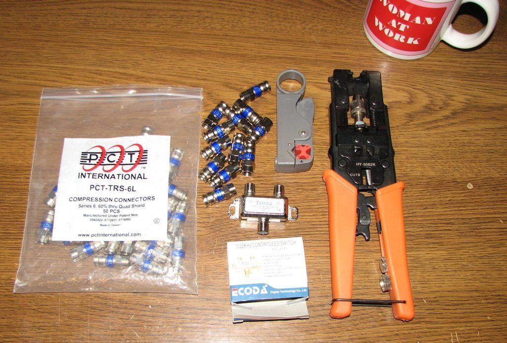

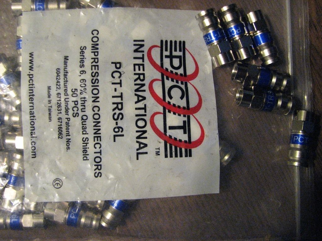

Where did you purchase the blue RG-6 coax and what brand compression fittings do you use?
Hi Popcorn,
The wire I bought from here, 1 Cat5 + 1 RG6 Quad Cable (500' Spool)
(attached is a pdf that gives the details about the wires)
The connectors I got on ebay, PCT RG6 F Connectors Compression Coaxial Cable TV 50 - eBay (item 310326643649 end time Jun-22-11 07:47:23 PDT)
The wire is neat stuff because it has a lot of wires in it and you can use it for many things. I ran several wires from the house to the dishes and the small wires on the side, the cat 5 wires, I use for the motors on the C dishes. It works great!
I had asked early this year about this type of wire and you guys said it was good stuff so I went with it.
The tools to put the connectors on, I got those on ebay too but I don't have a link handy for them.
My dad asked me yesterday "How are you going to crimp the wires?" I laughed and showed him these tools and told him they are compression fittings. He asked what that was. I told him crimps are so yesteryear and that this is the new stuff. So he sat and watched me put connectors on the wires and he said "Wow, that's a slick tool!".. My dad gets his cookies on tools. :rolleyes: Sheesh.. It's just a tool.
Anyway he was all impressed with it and even more impressed that I learned how to do these things..
:D

Thank you Dee. I purchased a bag of those same connectors several months ago and was impressed that they use no plastic insert like some others, but for some reason when I give them a tug they come off with a little force. I believe the crimper is at fault which I purchased cheap (about $14) on EBay. We use the same crimper as shown in your photo (DL-808 / 808R) here at work. I did a quick search and couldn't find any for under $49. Perhaps I'll make the investment or do a search on EBay to see if I can get one a little cheaper. Perhaps I'll purchase some of that blue coax as well and redo a lot of my coax runs to the dishes.
Did the rings on the connector fully compress? You if not, you may be able to put a spacer (a washer) in front of the connector in the tool for it compresses down further. (if your compression tool is not adjustable) Otherwise, the cable may be too thin for the connector to fully secure on the cable. Also the PCT web video for the how to shows folding the braided shield back before inserting the cable into the connector.
YouTube - ?Channel Master Connector Installation?‏
http://www.pctstore.com/v/vspfiles/assets/images/pct trs connectors installation guide.pdf
Note there are pictures of the connector fully compressed.
Very good video. Also, I like the idea of adding a washer to my crimping tool.

I found a crimping tool at Sadoun very inexpensive. I've used it for about 60 times now and I got to say i'm very happy with it.
70014 Datashark Crimp Tool
Of course not all compression connectors are the same so you have to make sure the tool fits the connector. So I bought some nice connecters as well. :)

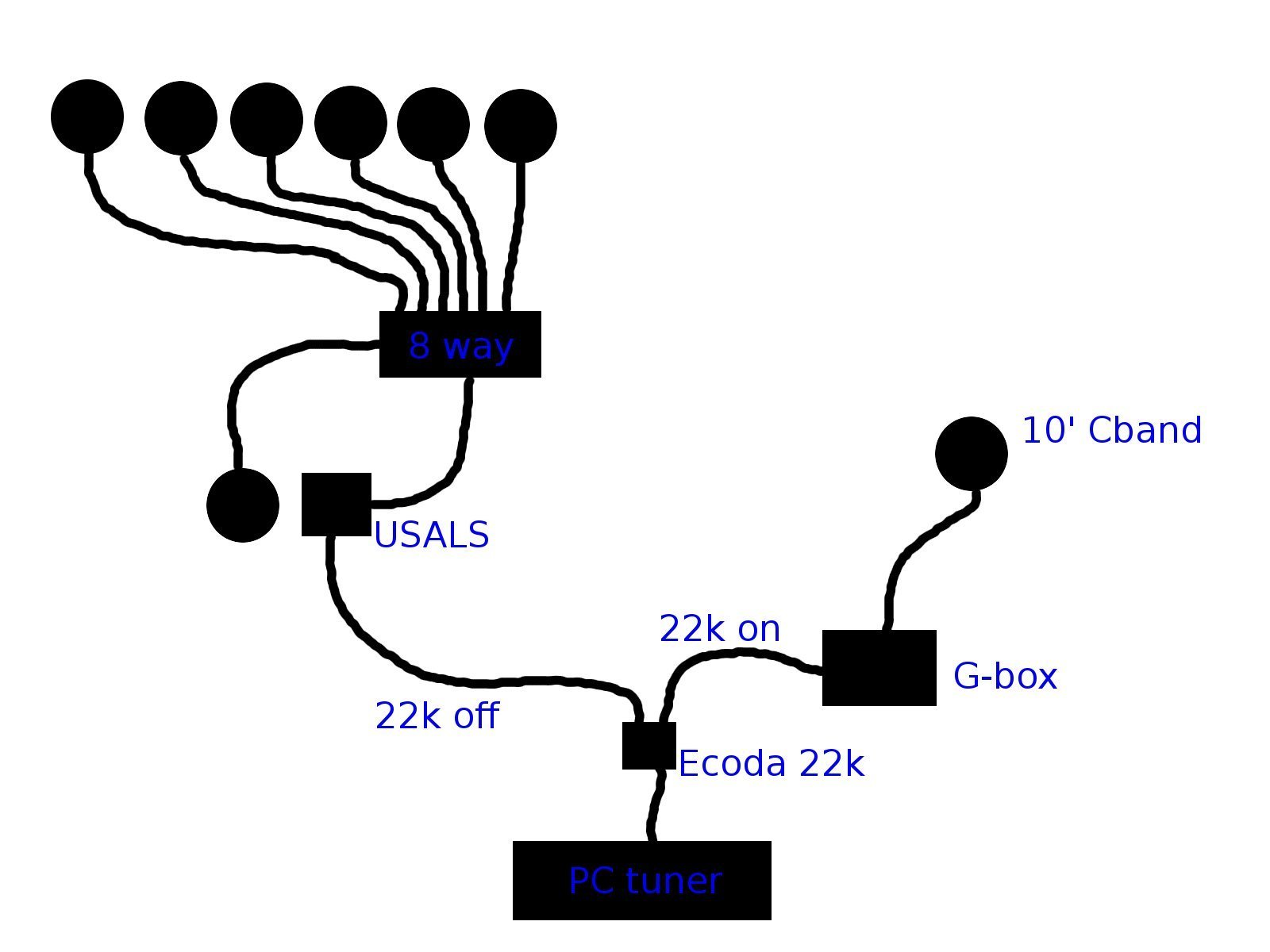

Well my new motor will be here tomorrow. Now that I know what to do I'll be motorized before the sun goes down.
Well, maybe not totally. I need to figure out how to mix USALS and my 8 way switch and the encoda 22k switch all together.
I'm going to put the motor on the coolsat first to ensure that it's lined up right and working 100% as it should be then move it from the coolsat to the pc tuner.

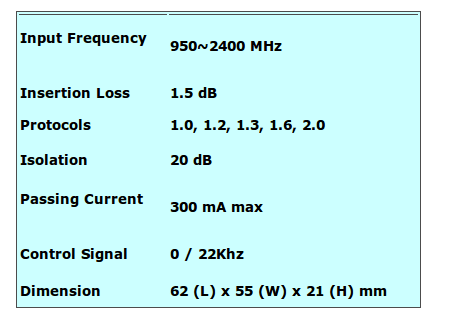

I know I have to put the motor first. But, can I put an encoda 22k switch between the pc and the motor? I really, really need to be able to do that.
Thanks.. :)
edit: Here's a very crude drawing of what I'm trying to do. (I'm already setup like this only without the USALS motor, yet. All the rest, I have working fine now)
edit2: I am ~assuming~ that this is possible, going on what I read here, http://www.satelliteguys.us/free-ai...zed-dishes-same-receiver.html?highlight=ecoda and here, http://www.satelliteguys.us/172351-ecoda-22khz-reliability-4.html#post1799528
edit3: The 22k switch and the gbox are inside the house. There are two wires running from the house to the dishes. One wire runs from the gbox to the BIG cband and the other wire runs to the 8 way switch. On it there are, um, several ku dishes and the small 6' WSI cband. It's not officially motorized (it is but it's a long story)..
The wires are underground from the house to the dishes. Putting the 8 way switch in the house is not at all an option because I would have to run a zillion wires into the house. It's all actually more complicated than that as there are also a few 3x4 switches out there on a few of the old primestars but for simplicity sake we'll pretend them away. :D

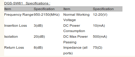

edit4: I found the specifications on the switches I use. And the USALS motor I am using is an SG-9120. The dish is a primestar 75e so it's not very heavy or large.
