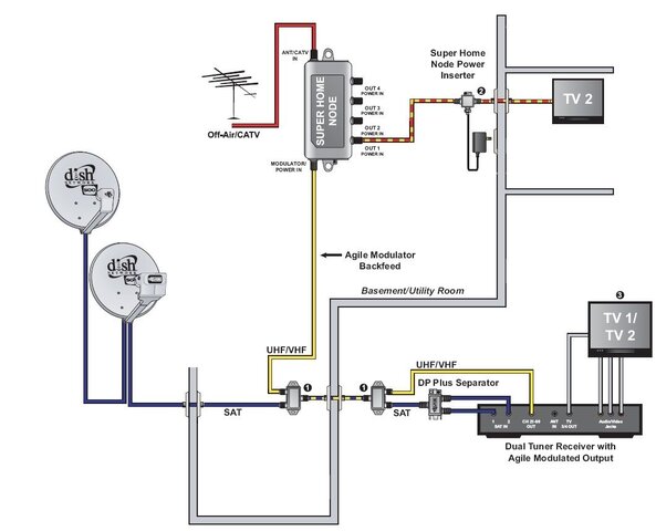

Hello...
I've attached a diagram of my in progress installation using a Super Home Node. I noticed that I get a cleaner picture on TV2 if I move the power inserter from Out 1 on the SHN to the Modulator input. I currently have the blue Holland diplexers (DPD2). Is it OK to to put the power inserter on the Modulator side of the SHN in my setup (between the diplexer and SHN)? The DPD2s are high current rated diplexers, correct? Anything else I should consider?
Thanks

According to the diagram you can put the Power in anywhere except the Ant. In.
If you look at the diagram power in is show on all ports except Ant. in
