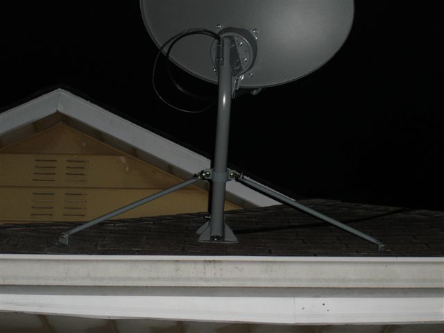

Again if it was mounted properly you shouldn't have any real concerns...Make sure it has the additional support arms...I can take a picture if you are not sure what I mean.

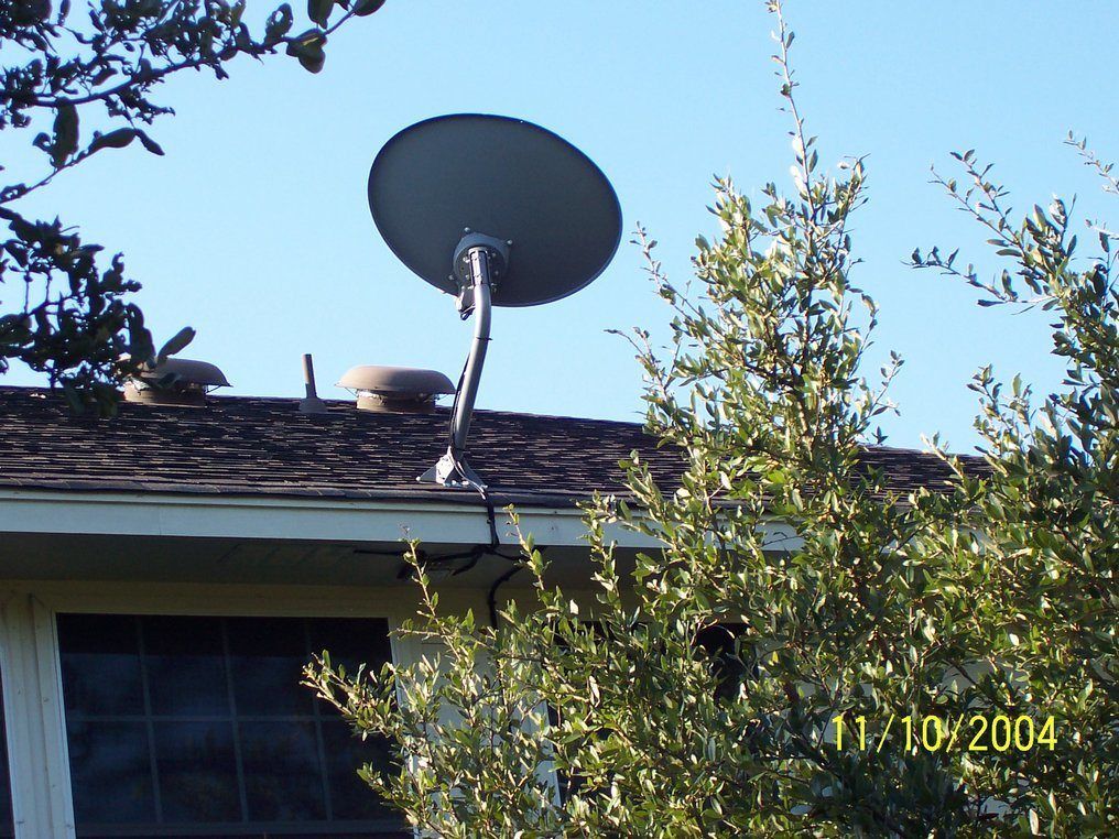

Here is the superdish picture. It's very hard to get a clear picture because of the tree.
You do not have support arms...and as close to the edge of your roof as it is I'd worry about them not lagging to joists as well.
I will post a pic of support arms tonight, provided I get home before sunset.
Jason
Thanks, Jason. The installer looked kind of inexperience with Superdish. When I asked him how many superdishes :mad: he installed recently. He said 1 of 100.
I just called the installer and told him what I concerned about.
That what he told me: if we have wind more than 50 mph, your dish (even you have dish 500) will be ripped off. Why you worry about it, your insurance will pay for it. If you want additional arms, I will come to you house if I have free time later.
When I asked him why didn't tell me that and offer me a pole installation choice, he saild it would cost me additional $200 to do it.

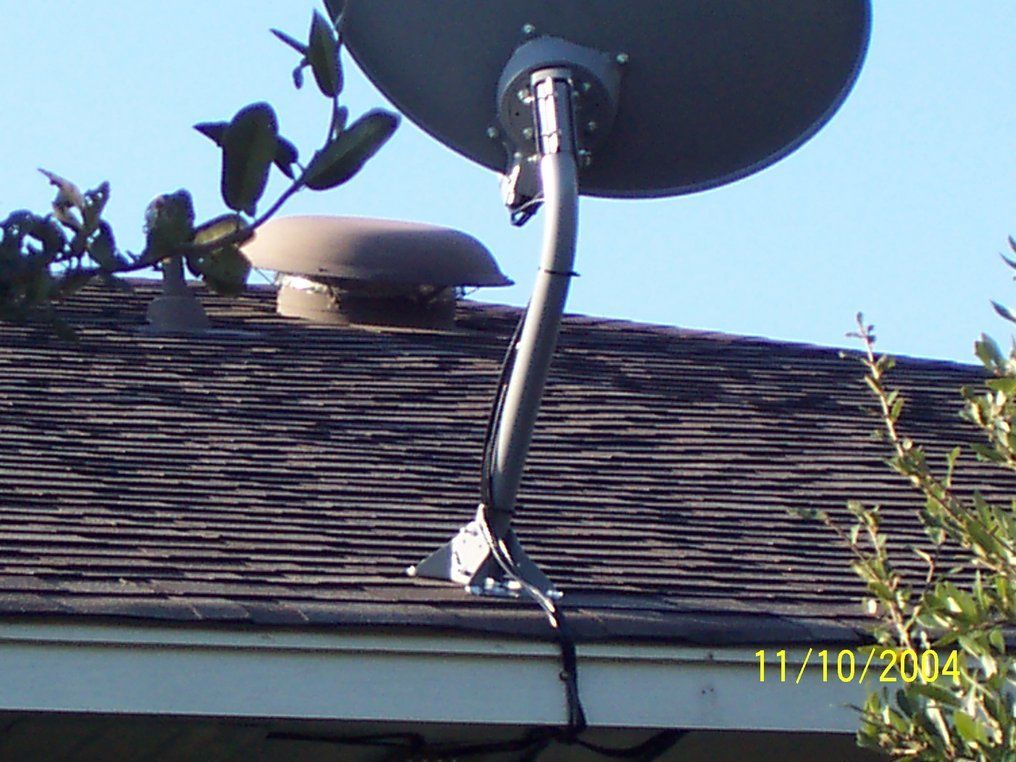

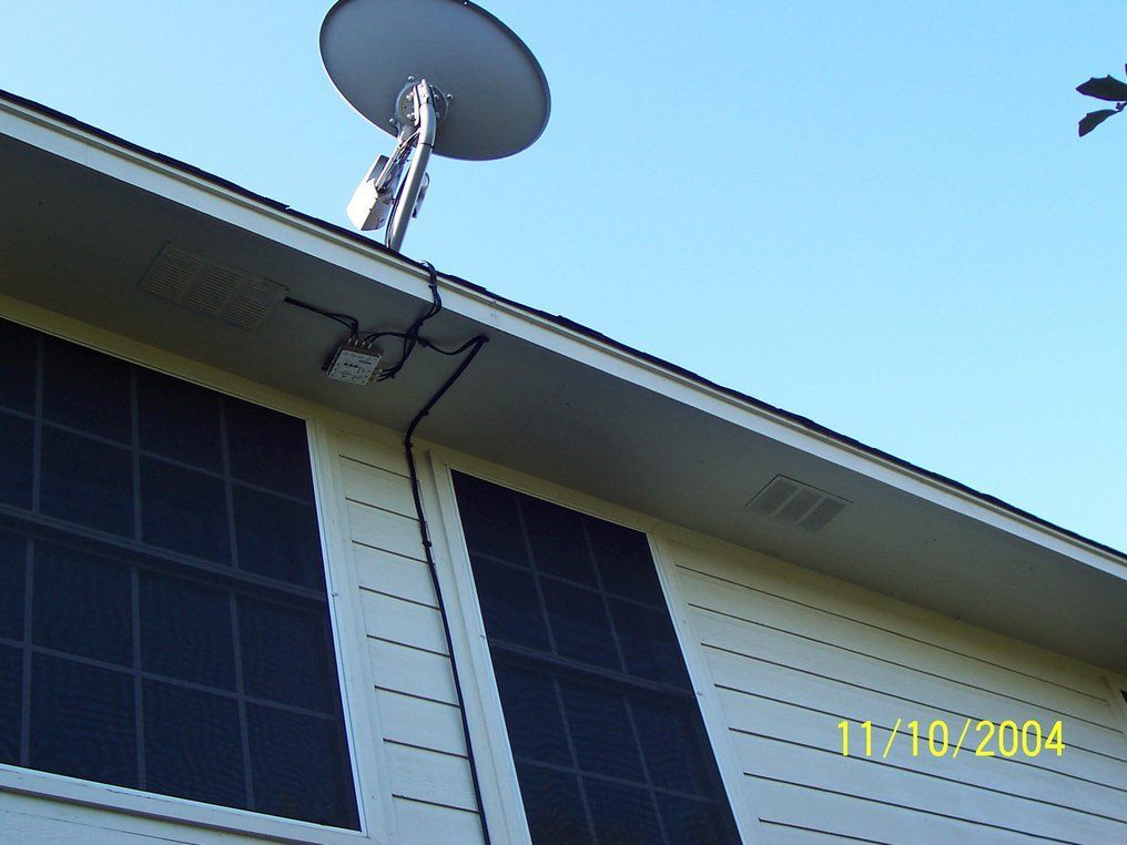

Here is a close look of the installation. Is it normal to install a dish very close to the edge of roof? My installer told me he wants as less as the wire laying on the roof. Since the installer didn't installed the arms, is it possilbe to add the arms at this location? or the dish has to be pulled out and installed in another location?

I can see from the Photos Jeff's SD is steel....The saftey requirements require withstanding a 100mph wind period. Not 50mph. This last summer we got hit by a microburst...I lost some siding, so did neighbors, some lost window screens and glass....No one lost a SuperDish. The support arms are required in my sub, as it is defined in the CCNR's.
This guy is full of it, tell him to install the support arms which he should have supplied. Pole mounting is the standard install method out here. If your using a E* contracted installer it wouldn't cost you a penny, but retailers are allowed to charge for the pole.
I will take a picture as soon as I can get home in daylight...I'll try in the morning.
Jason
Overall, the install looks pretty clean - except I don't see a ground wire for the dish itself. Maybe it's there, but I don't see it.
No way for any of us to know if the lag bolts on at least one side of the foot are in a joist or not.
The support arms can be bolted into the ends of the joists. Not ideal, tho. Of course, the fascia board alone is NOT to be used.
Trido, where is your switch installed. I am kind of disappointed the installed the switch outside ( bottom side of my roof edge and close to my window area, see one of my previous picture) when he could easily mount it inside. I didn't pay attention to it until he already finished because my previous Dish from Directv has built in switch. It doesn't look very neat with those wires outside the window, and I also worry about if the switch will drop someday in the future.
A big surprise to me he put it inside the cable tv box on side of house.
He took 30 minutes to BREAK into box(I need the tool they use to get in)
A bigger surprise a few days later Cable TV came out to disconnect their cable I watched as they got inside the box where he put my switch and said nothing and left it inside.
Unforutanetly cable guy locked box and if I need to get into box to get switch I need those cable tv tools .
Trido
As mentioned, my dish is on the roof, just down from the peak, with cables running into my garage (about a 35 foot run) where the switch is mounted inside right where my old DirecTV switch was at. They used this spot because:
1 - that is where my 119 lead came incase they needed it for 119
2 - routes to all 4 of my receivers started there and they could use the current RG59+ to pull the RG6. Saved alot of time.
