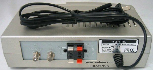

I don't have a superjack VBox II, but I have a Motek VBox II. I don't know whether they are the same or not, if so, use these instructions:
Take a look at the picture below.
If the back of yours looks like the above picture, then you could proceed based on the assumption that they are similar. Do this at your own risk as they might not be the same.
I have four wires coming in from my Von-Weise actuator on the 10 foot dish.
Black and Red are the two big wires. They should hook to the two inputs on the right of the 4-wire input labeled M1 and M2. They can be reversed if the dish moves the wrong way when you start to move the dish.
I have a Brown and Blue wire also coming from the actuator. They are to be inserted into the left side of the 4-wire input on the back of the VBox II. I have the Blue wire hooked to the top, and the Brown wire hooked to the bottom.
That takes care of the motor control part and supply of voltage.
The coax from the RF-In on the receiver goes to the RF input marked receiver on the VBox II. The RF input marked LNB on the VBox II has a coax that runs out to the dish and hooks into the LNB. If you have a voltage controlled LNB, you are in good shape now.
