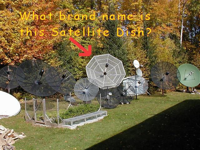

Well Hermitman there's a good possibility I may get 3 dishes. One being what I said earlier as looking a lot like my Unimesh dish, only smaller, and the name brand of "U.S.A." on the feedhorn. The other one is like one that you have. I put a label on the image to point it out to you. It's not a perfect circle but a different and interesting style. Who makes it? and is this a good dish to get?:D

that is a paraclipse. i have one just like it. it's 12ft
Thomas-Paraclipse, good find! If it's undamaged-grab it. If Birdview was the Cadillac of big dishes, Paraclipse must've surely been the Lincoln.
Paraclipse Dish

Thanks I was wondering who was the maker of that dish. It sure gets your attention when looking at them. So now I know it's a Paraclipse. Like I said earlier when I first found this dish, I asked the guy if he was happy with it or if he wanted it removed. He said how much was I willing to buy it for. I told him about $100.00, considering that you most likely wouldn't make as much by selling it to a scrap yard. We talked and then he said he would think about getting rid of it. When back almost a week and a half later and asked him if he decided. He says he still thinking over. I don't think he is any hurry to get rid of it.

Tom, usually people like that do not want to let them go if they do they want to much for them. paraclipse made the dish.it was called the paraclipse also lol.. i have a bunch of info somewhere about it. in my house. i will try to find it sometime this week and post it up for you. they are huge and heavy as hell. the mount is really heavy duty. mine was still up untill i took it for now. but left the mount. um. i would offer him no more than 50 dollars-75 for it. thats if its in great shape. but it not i'd offer him 40 and tell him u'll take it up. also see if he has the receivers if he wants more for it then tell him u just want the dish LOL but they have nice position box's that come with them. good luck man :up
