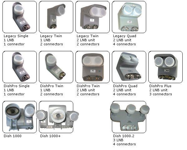

your lnbs are legacy or DP or DPP? you need legacy lnbs for the sw21 to work correctly, if they're DP, you need a DP21 switch

you forgot to mention that, so, i think is a legacy, maybe twin or quad. what you get on the screen when you perform the check switch? menu, 6, 1, 1, check switch, test
It will not so a check switch test. It starts a test then the screen goes blank and starts to aquire single. I do not see the one I have in your chart. When you take the housing off it looks like 2 single dish pro lnb in it.
can you connect one lnb output directly to the receiver and perform a check switch test completely? just to verify what you get on the screen
