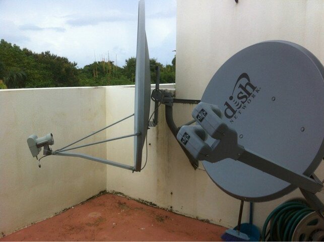

I have 110/119 & 118 setup here in PR.
119/110 are with new smaller dish & 118 is coming with a bigger dish which is pointed like legacy dish unlike the newer smaller dish

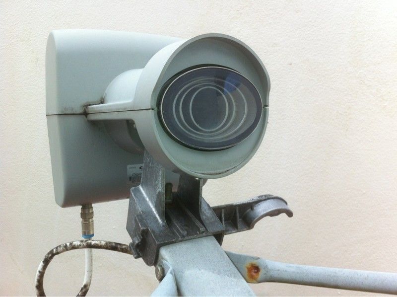

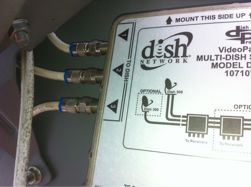

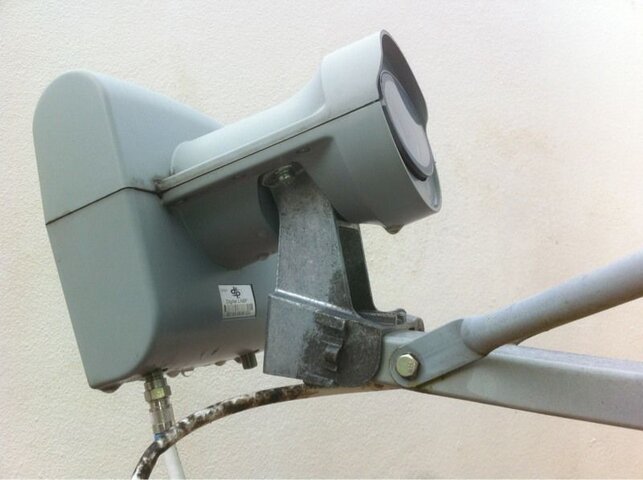

Attaching the pics I just took for the setup. Can't send you the pics in the pm through phone. Hope is helpful to you in getting 118 sat down here in PR

Wow. Looking at your pics, I'm rather astonished that the bigger dish is actually pointing in the same direction as the smaller dish! If I understand what I'm looking at, you are picking up 110/119 on the smaller, and 118 on the bigger.
Thanks for the PIC!, I see that the special LNB 118 is moved to the right, because no space between the lnb base and dish arm (left side). When i install, there a space in both side, like in the right side of the 3rd photo.

Post a pic of the setup with the lnb you are setting up. The brand I don't know. I guess is standard dish that I got with legacy installation. There was 2 before but after new smaller dish pro installation I removed one.

The reason I leave the 119 output blank..or didnt put another LNB for 110 (as you can see from the pic....it has that provision)..is that IMO the signal I get from the smaller dish is better....atleast for me....but I have to leave that 4 foot dish for 118 as smaller dish cant receive 118 in PR. I never checked the signal level with Dish pro LNB with bigger dish (my experice is based on legacy lnbs...so dont know if that make a differece). Even the installer told me that smaller dish hold on to the signal longer then the older legacy dishes (maybe one of the reasons being as I have seen with my dish is during rain & wind...the bigger dish is moving or shaking a bit...whereas the smaller one dont)
In my installion of the 118 LNB....its holding together to the arm with 1 screw from the bottom....& the LNB fitted the arm properly without any adjustment.
