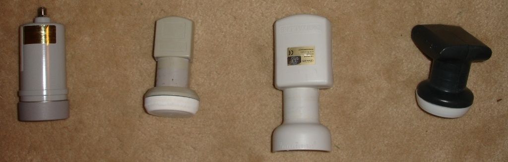

This review is to compare the $9 Tele-Comm T-1500 Standard LNB 1.0 dB NF LNB Sadoun sells to more expensive LNBs.
The Competitors: (In no particular order)
1. Lava Universal LNB 0.4 dB NF
2. Tele-Comm T-1500 Standard LNB 1.0 dB NF
3. Invacom SNH-031 Universal LNB 0.3 Typ dB NF
4. Fortec Star Single 0.4dB Universal Single LNBF FSKU-V
LNB Specifications:
Lava Universal LNB 0.4 dB NF (Similar to Sadoun ULN1 UNIVERSAL Linear Ku 0.4 dB LNBF) ($29 Sadoun)

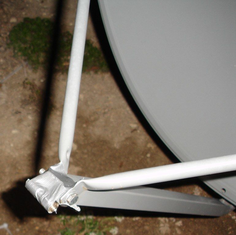

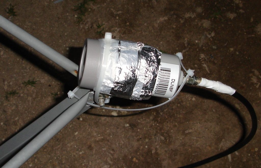

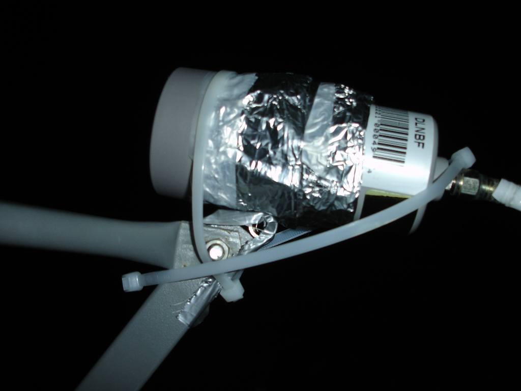

All the LNBs except the Tele-Comm T-1500 were able to fit the standard LNB holder.
I tried a larger holder (For a C-Band LNB) for the Tele-Comm T-1500 but it was to large to fit the LNB, but that was not going to stop me :)
So I had to find three of man's best friends. (Not dogs :)) Duct Tape, Tie Wraps, and a F-Connector (Normally used as a connector for RG-6 coaxial cables)
I duct taped the f-connector to the end of the satellite dish's LNB arm, placed the Tele-Comm T-1500 LNB on top (moved the LNB around to find the correct focal point), and tie wrapped it in place.
Images to fit the Tele-Comm T-1500 LNB to my 36" dish are attached below.
