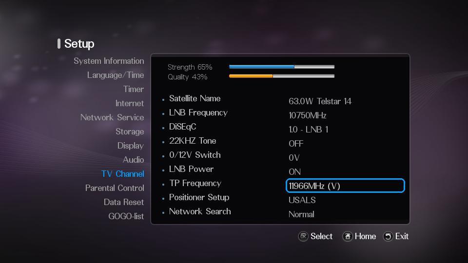

Yes, I have been watching the stations on 11966 V @ 11280 Ks/S often. It is one of my weakest signals, but it is holding in at 42% quality on my AZBox. This is actually a pretty fair reading, I have a ways to go to get down to the threshold for the AZBox which is somewhere near 33% quality or possibly even a little lower, so I have a bit of buffer room here.
Readings taken with 1.2 M GEOSAT pro antenna, Invacom QPH-031 LNBF and AZBox Premium.

I was getting it today at 52%quality, about the best I ever got it on my .90Channel master dish.
Might have to move a dish further out to 'see' around this big walnut tree, it's just too nice a tree to kill for one satellite though. Now, if it was a pine it'd be a goner.
