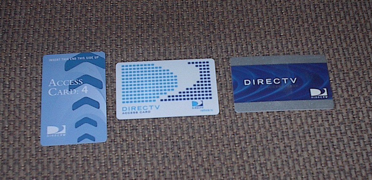

You'll need to make sure it's the correct generation card...
What does it look like ?

Attached are cards that will work.
