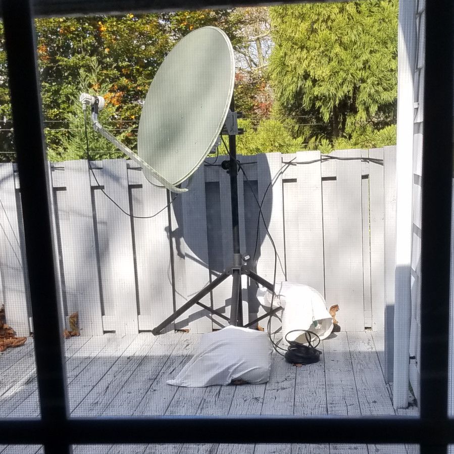

Here's a tip for a temporary dish set-up. I'm a musician and came across a professional PA speaker stand for sale. It is crazy lightweight and fits the dish mount. A couple 50-pound sandbags keep it from moving or tipping over in the wind. When I move I'll unmount the dish, fold in the legs, and scatter the sand in the back yard.
