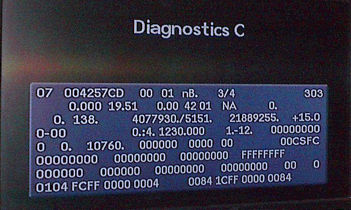

Ya I get 99 across the arc and have seen my HBO as high as 99. Those 12 foot Unimesh's are amazing aren't they?? :D My highest EBNO is +15.0
EBNO of +15 huh. Now I have to go out and play with the feed again!
I don't get that on everything but that is the maximum I get (see attached) :D May be my ADL RP1C feed.

The ADL feed may be the key since its dual moding chambers makes use of the out of focus energy that a normal choke plate type feed (chaparral etc) chokes off. The ADL puts it back into phase so it can be used. I did my homework when I bought everything new in 89. I did not hold back on cost :) Those were carefree days...
What your getting is very good and well above average.
My ADL feed is strictly C band with a servo motor. It is the original ADL not the Patriot knockoff that is out now. The RP1-C has no choke plate it has a dual modeing chamber. It's also designed to cut down on TI and sidelobes. I love it and Mike Kohl also endorses it.
My LNB is a 1989 vintage Cal Amp 40 degree commercial LNB. It was the same one cable headends used back then. It cost me over $200 for the LNB and $150 or so for the ADL feed. My Unimesh was close to $800.00
