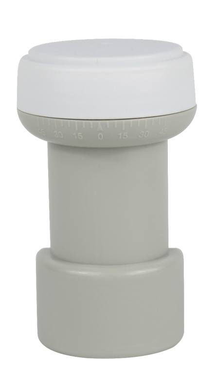

Satellite signals are transmitted with two polarities to enable twice as many services in the same frequency range. Your LNBF skew is set for each satellite position so the vertical and horizontal probes inside the feedhorn are in alignment with the polarity of the satellite signals.
The receiver sends 13Vdc out to power the LNBF when tuning a vertical transponder. This voltage sets an internal switch in the LNBF to select the vertical probe located inside the feedhorn. The receiver sends 18Vdc to the LNBF to switch to the horizontal probe.

If the LNBF is not rotated to match the received satellite, signal quality readings will be lower. Dishpointer shows the skew for each satellite based on your location.

No channel repeats on 97w. Likely your LNBF Skew (rotation) is not correct and the horizontal and vertical transponders are being received on both polarities.
Slightly loosen the LNBF clamp screw to allow it to rotate.

While watching the Signal Quality meter reading and standing below and in front of the dish, slowly rotate the LNBF counterclockwise to approximately 16 degrees to peak for highest reading.
Tighten the screws to secure the LNBF rotation and rescan.

LNB Skew: 24.4°
