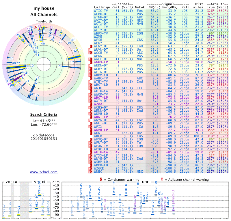

Heres my footprint!I'm using rabbit ears now and getting around 20 stations.Some for the father ones tend to come and go with the weather.What would you recommend for a antenna in the attic? Don't want to spend a lot of $$$ on this project! under 150 would be nice.

A UHF bow tie antenna would probably be your best investment for attic mounting and if you want to try multiple directions a rotor would be needed. A Winegard HD 1080 is a UHF/VHF antenna that Solid Signal has starting at $24.99 for a refurb. I am using one at 63 miles from Dallas but our land is much flater, 22.1 from Springfield might be marginal. Your photo album on this site shows you have a two story house so your attic is higher it also shows some of the trees around you. Could you move some to this thread to give others more information about your location?
If you want any chance of 22.1, you'd need a vhf-hi/uhf antenna. My DB8 is aimed right at Springfield and I've never had it come in (from New Britain).

What is the weakest station on the list that you want to get?
If you haven't already done it check out the Winegard HD 1080 it is a VHF/UHF with the flat design of a 2 bay UHF antenna so it is small. Yes METV is an important channel to get
wzme which isnt my farthist but has rtv and metv which i watch often.
