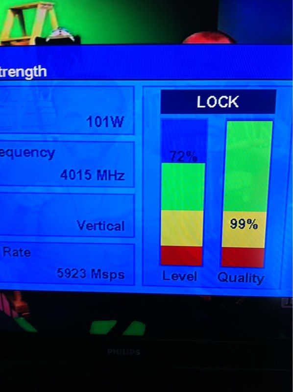

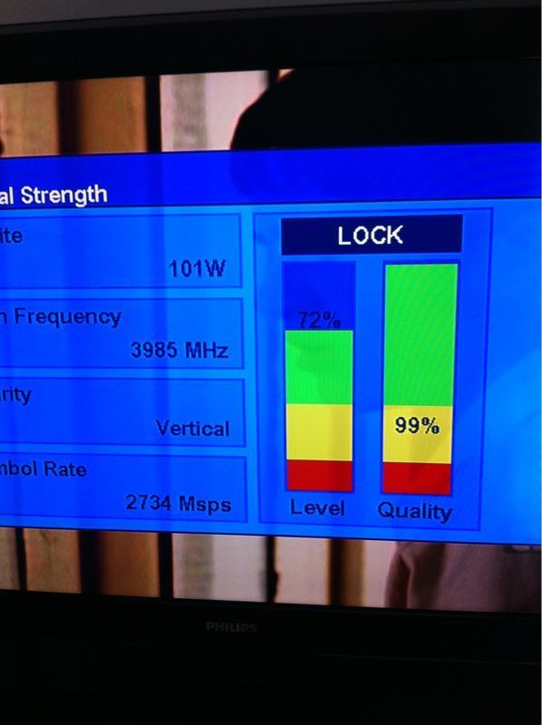

I have them both at 101 with 72 quality on my new 10 foot Sami. Bad news I've heard more channels are leaving ses2. @sports has left as well.
comes in good on my 10' sami mesh in wv with a pansat 9200 on 101w
